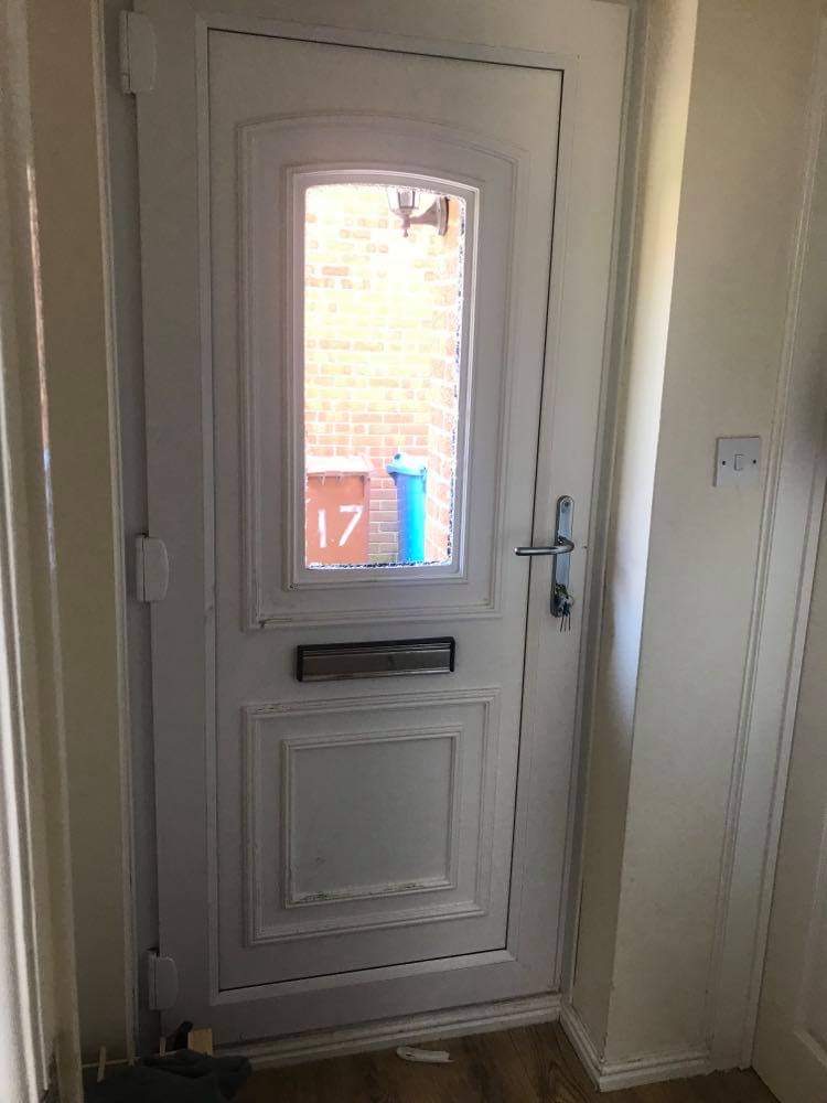

Does anyone recognise these doors? I need to replace the glass but not sure how to locate the fixing screws or if there are any. Do I have to open the whole door or can I cut around the area of glass?
It looks like a bonded panel. Normally you would replace the whole panel including the glass, the plastic and the letter plate, leaving only the outside plastic frame that the handle and hinges are attached too. I don't know of any way to split a bonded panel and replace only the sealed unit without destroying the panel.
Yeah you’re right mate thank you for the response, so much for a sustainable future haha ordering the panel today
