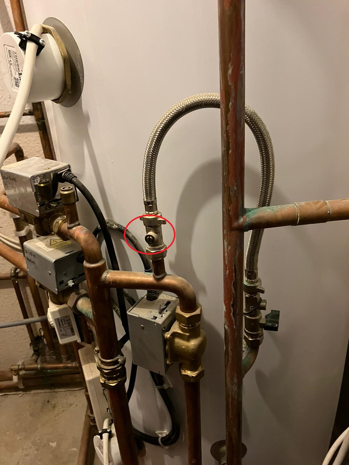

You are right, all my previous boilers were combi's. Whilst this one is indeed a system boiler connected in the same boiler cupboard to a megaflow type system, with diverter valves to independently control upstairs and downstairs.
The model is ecofit pure 630.
The only braided pipe I can see is over near the unvented tank. On this setup, is it all the way over there?
The Flexi near the cylinder is likely your filling loop. Can't see what the other end is connected to though.
Hopefully the attached helps?
1) shouldn't the valve I have circled be closed?
2) I have attached a close up of the valve on the right, that seems to be closed on both the toggle and then a seperate screwdriver slot? - Seems odd but perhaps not
The valve circled in red is open ( in your pic) and it needs to be open to effect topping up.
The valve with black handle is closed ( in pic) and needs to also be open to top up.
After top up close both valves.
The screwdriver slot in the black handled valve may also need to be turned ,so it is in line with the pipework, if the other two valves are open and no water flows into the system/ top up doesn't take place.
Thanks, I did exactly that and all resolved now.

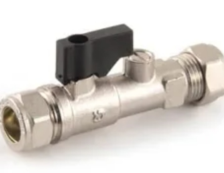

So the screwdriver-operated bit is to override the "non-return" mechanism?
Better picture...
If you know what you're doing, the screw can be undone to confirm the functionality of the check valve and clean the port.
Typically, it shouldn't be touched.
