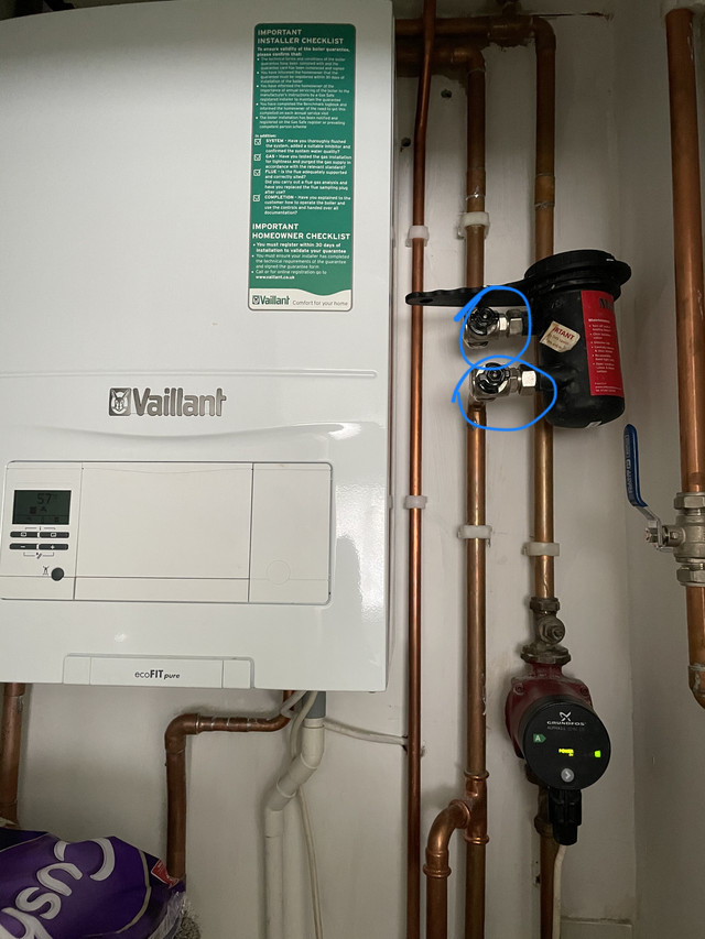

wondering if I can get some advice. We have a vaillant ecofit pure boiler and it seems to keep crashing frequently with either error code 20 or 23. The whole system crashed and we need to restart it.
conntected to system is a gledhill hot water tank, pressure tank in loft, rads and underfloor heating in kitchen/diner.
any ideas what could keep causing this? As days we get no hot water as we don’t realise it’s failed.
I notice it tends to improve when I let air out of the magna flow bottle.
i did notice sometimes the pump loses power and the boiler stays on.
maybe pump on the way out?
Any recommendations for a good powerful pump to service a 5 bedroom house with large number of rads and Tank. The underfloor system has its own pump in the utility

Check your magnaclean isolation valves and any other isolation valves as well.

These circled blue, they have on/off indicators, make sure they both say on. Make sure any other valve including any under the boiler are in line with the pipe.

Does the boiler trip only when HW is requested or also when CH is turned on?
Yeap both set to on.
it doesn’t trip all the time. Tends to do it 2 out of 5 days which is bozarre
