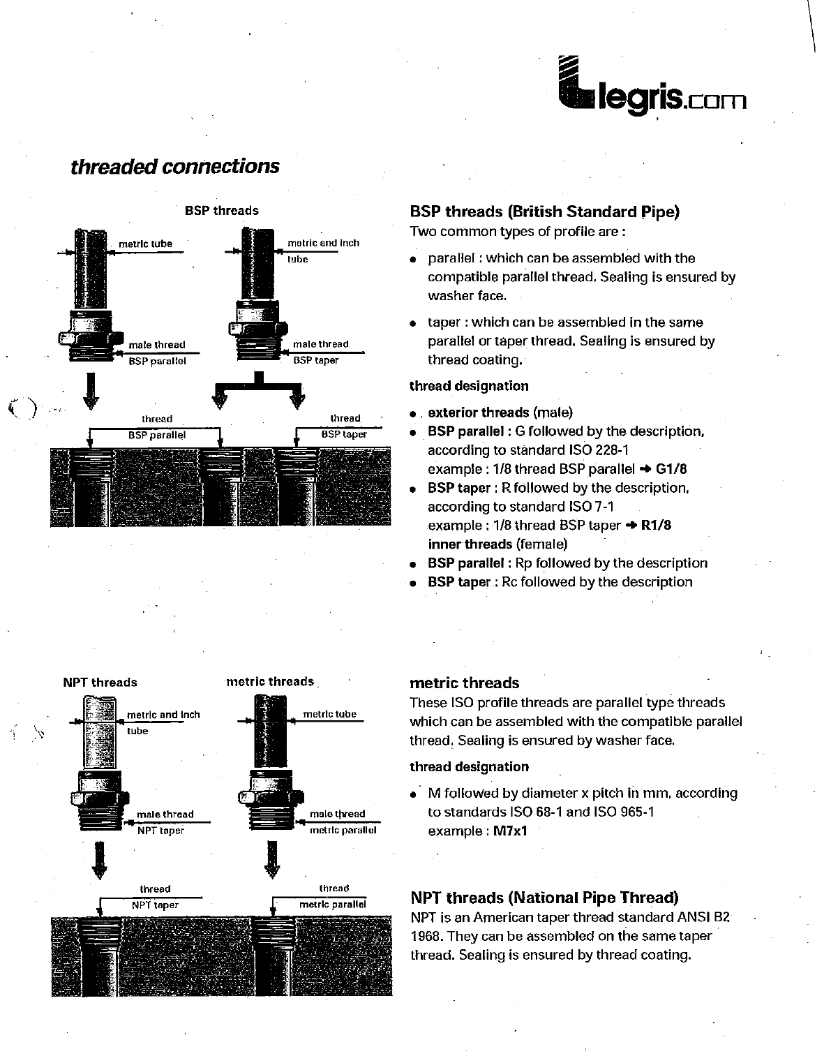

The little disagreement you guys are having is exactly why I'm asking this question, is PTFE enough for a water tight seal or am I supposed to use a rubber washer or something? Are you supposed to use a rubber washer beyond hand tightened fittings?

OP: You have a compression elbow. That will be a parallel thread. The female will be parallel (all female threads are). Therefore you will need a washer. It is obviously important that the male grounds on the washer.
The only problem is that the end of the male is not flat, but has a taper. This can damage the washer. But the combination is used quite often, although not strictly correct.

It’s likely that the female lip will hit the inside angle of the elbow before the male thread is fully home inside the female socket so you’ll have to try a stack of washers... fibre ones would be better as they swell to seal. Also wrap loctite ptfe string around the male thread. Get yourself a compression cap so you can test watertightnes before mounting the shower.
Might also be worth filing the end of the male thread so it has a bit of a “flat” rather than sharp edge.

From this and later posts, it sounds like you have a male thread, presumably 1/2"BSP taper, sticking out out of the wall, and you want the same male thread, but about 30mm further out. So I assume you will discard the compression nut and olive. Or is it a compression joint on the new shower?
The male thread on your new fitting is parallel (as you said in one post), have you tried it in the new shower? According to attached data, if the shower is taper it doesn't work, though in practice it might be OK, sealing it with paste (I use Stag) or PTFE tape. If it's parallel, you could use paste/tape, or preferably, as somebody said, you might be able to use a fibre washer, if the end of the fitting has a flat part in addition to the olive taper. If not, you could carefully file it to give a flat.
Similar options on the other end. I would guess the female end of your fitting is taper thread, so it's paste/tape. If it's parallel and you want to use a washer, there would have to be a flat surface inside the fitting.
