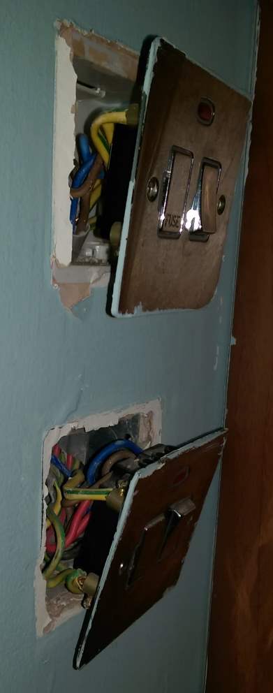

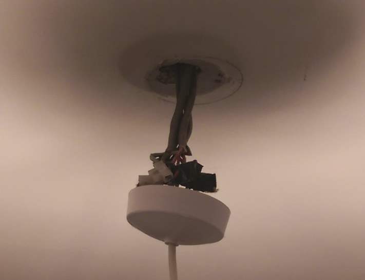

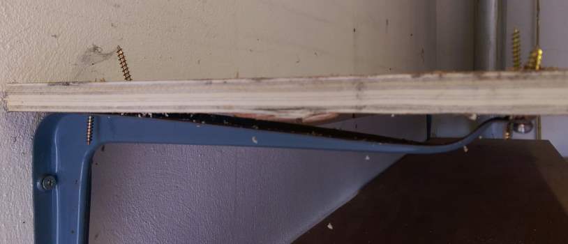

Here's a couple of pics of other handiwork of theirs. And the guy works in property maintenance for the local council :eek:
To be fair, I knew about at least some of it whan I bought it, so I got it cheap...
I think the shelf is the best :ROFLMAO:

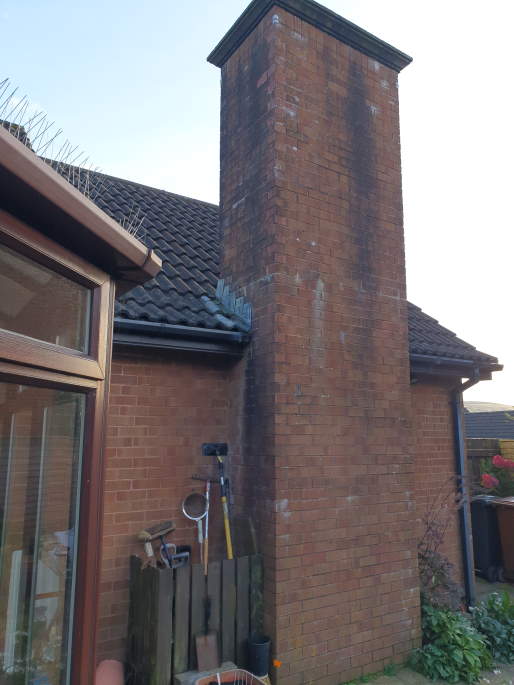

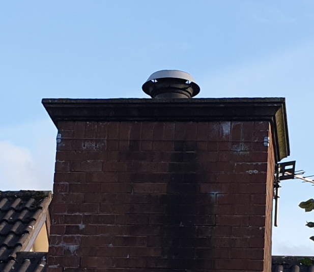

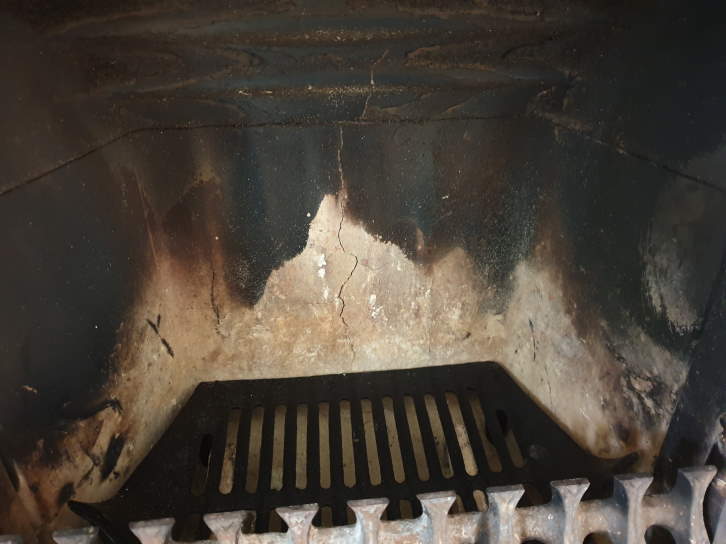

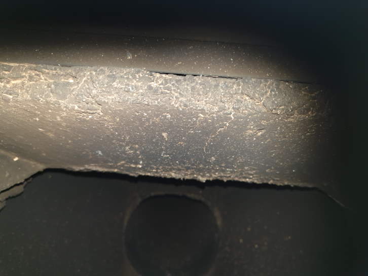

If possible can you can take a couple of pics of the fireplace, one inside of the fireplace, one or 2 pointing up inside the chimney showing the internals of the flue, one outside of the chimney and the terminal/pot on top.
Typically though a class one chimney for open solid fuel fires will be brick built with a large diameter inner flue >12", up to a roof stack with a clay pot terminal.
As far as a gas fire requiring more than adventitious ventilation then that would depend on the size of gas fire (the kw input rating)
Okily dokily...
Certainly looks like a class one brick built chimney but not sure about the flue, you want to measure the inner flue diameter. It also looks like a clay cast fireback, the type with the integrated chair, they would usually be ok for solid fuel but would need to check if that can take the heat of solid fuel as it now seems to be cracking.
The terminal doesn't look quite right either, though that may just be the cowl sitting on a clay pot below.
Of course I'm not suggesting it isn't suitable but I'd deffo get a chimney specialist in to survey that and make sure everything is ok, especially if it isn't pulling correctly.
