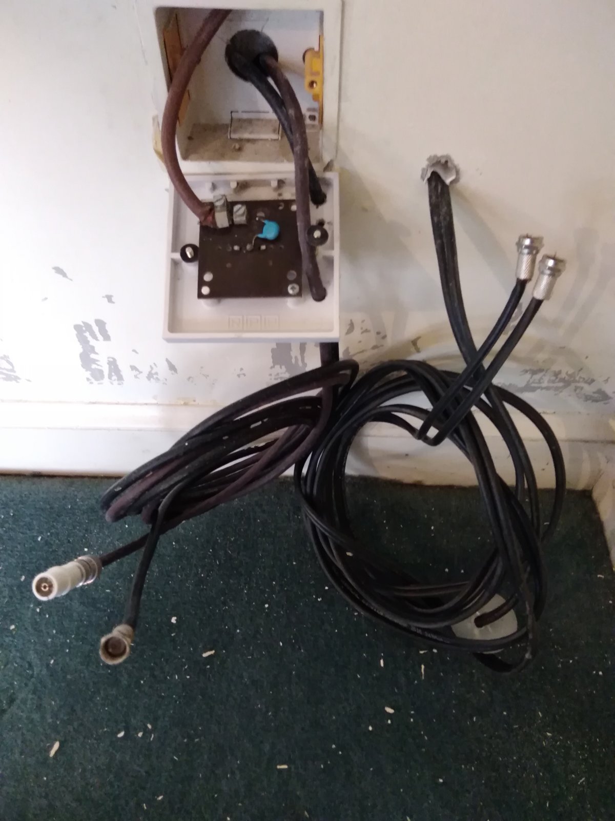

Hi all,
While renovating our new home I came across a nest of cables for sat and terrestrial TV (see pic). We don't have TV, but I want to retain what's here in case that changes in the future. Could anyone suggest how to terminate these into a single wall plate retaining functionality?
There is a double cable from the sat receiver, the rest I'm not sure about but one seems to be coming from an antenna, and another running along an outside wall to a socket at the far end of the house. There is a powered distributer in the roof space.
Thanks.

This looks like a job for euro modules. You could have a double F connector module for the satellite feeds...
https://www.cef.co.uk/catalogue/products/1584484-double-satellite-module-white
...and three standard aerial sockets...
https://www.cef.co.uk/catalogue/products/1198689-single-female-iec-tv-shielded-module-white
...which all click into a double gang euro frame...
https://www.cef.co.uk/catalogue/pro...media-modules-white?q=euro+module+front+plate
You'll need to cut out a bit more of the wall to fit in a double gang plasterboard back box. Get a 47mm deep one in there if possible.
Thanks rsgaz.
That sounds like a great solution. Appriciate you putting the links in.
