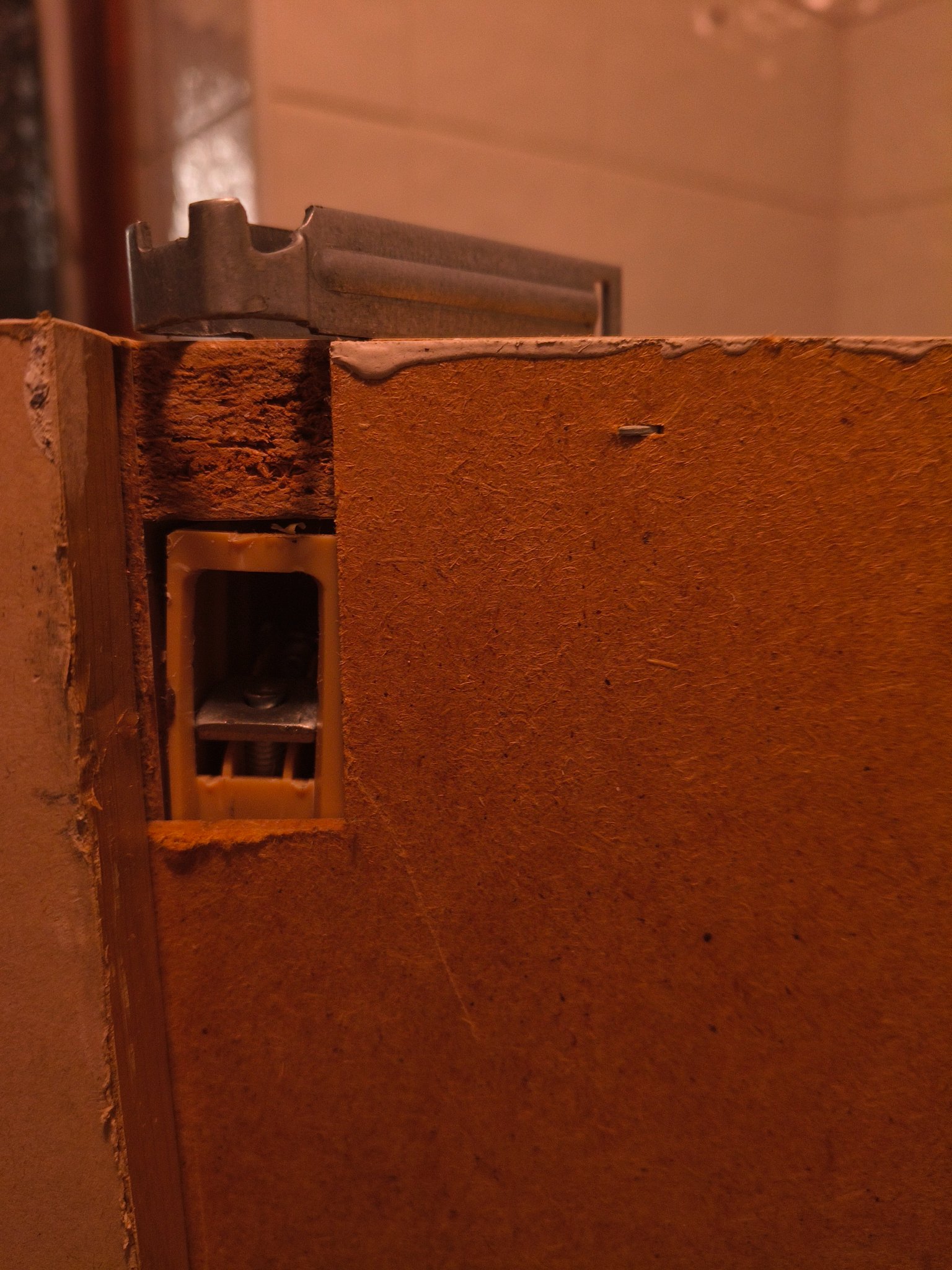

One of the adjusters on my Howdens wall cabinet has become disconnected from the thread. Is there anything that can be done - it appears to be permanently fixed to the frame.
There should be an adjustment screw inside the cabinet. If not working, empty the cabinet, lift off (it’s heavy) and fit a new pair from SFix
