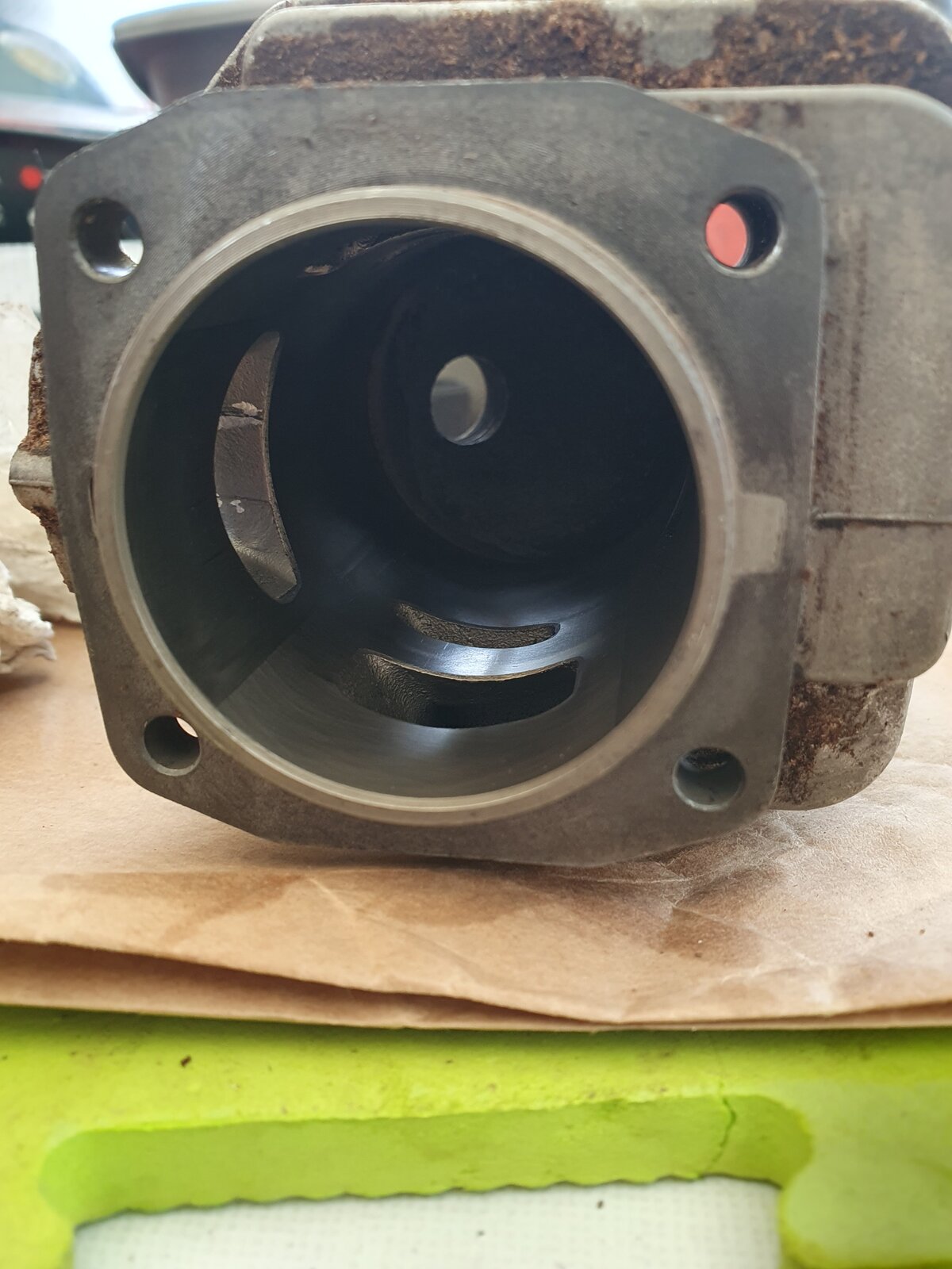

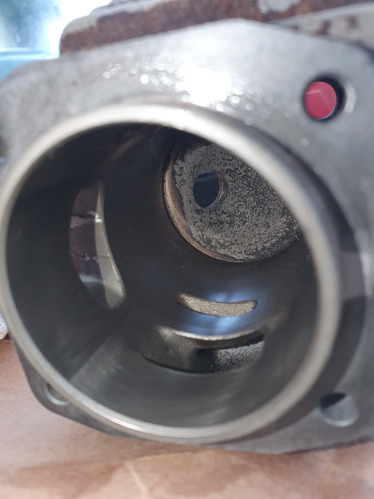

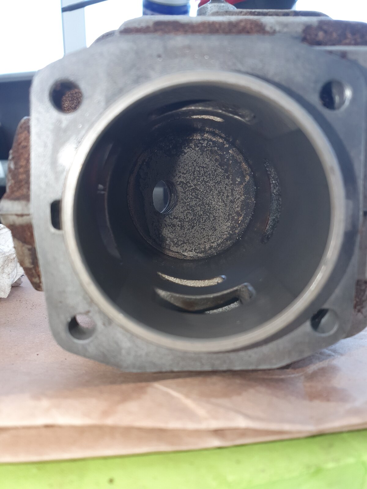

The Cylinder seems to be a Mahle. Not sure if this is an oem or already replaced in the past. Attached photos on how look like.
If good I would rather keep a brand product instead of going Chinese.

The barrel looks absolutely perfect, is the piston the same?
I’d stick with Husqvarna, brilliant machines and the replacement pistons and barrels I’ve used in the past have been great.
GHS Ltd and L&S Engineers are good suppliers.
John

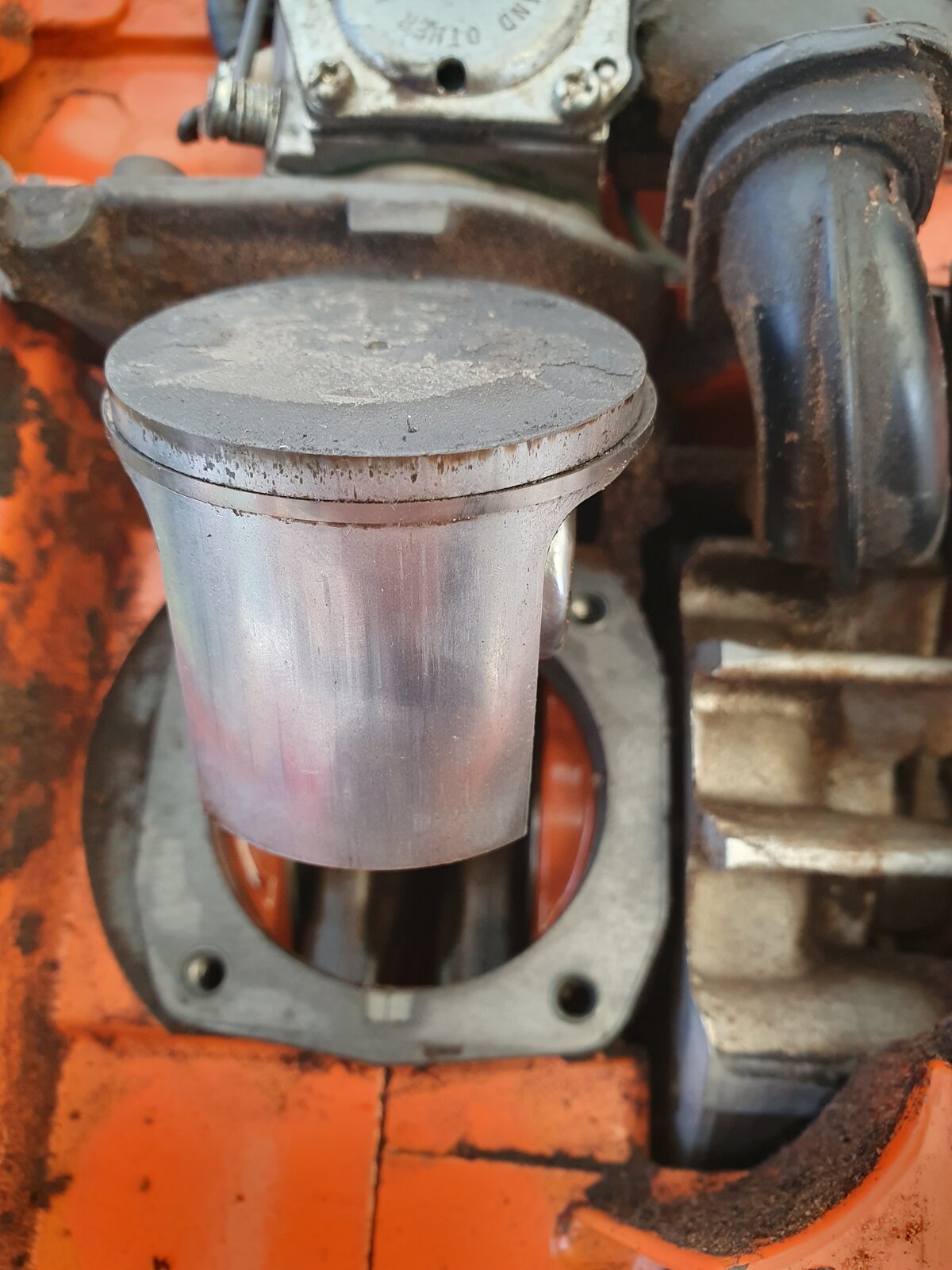

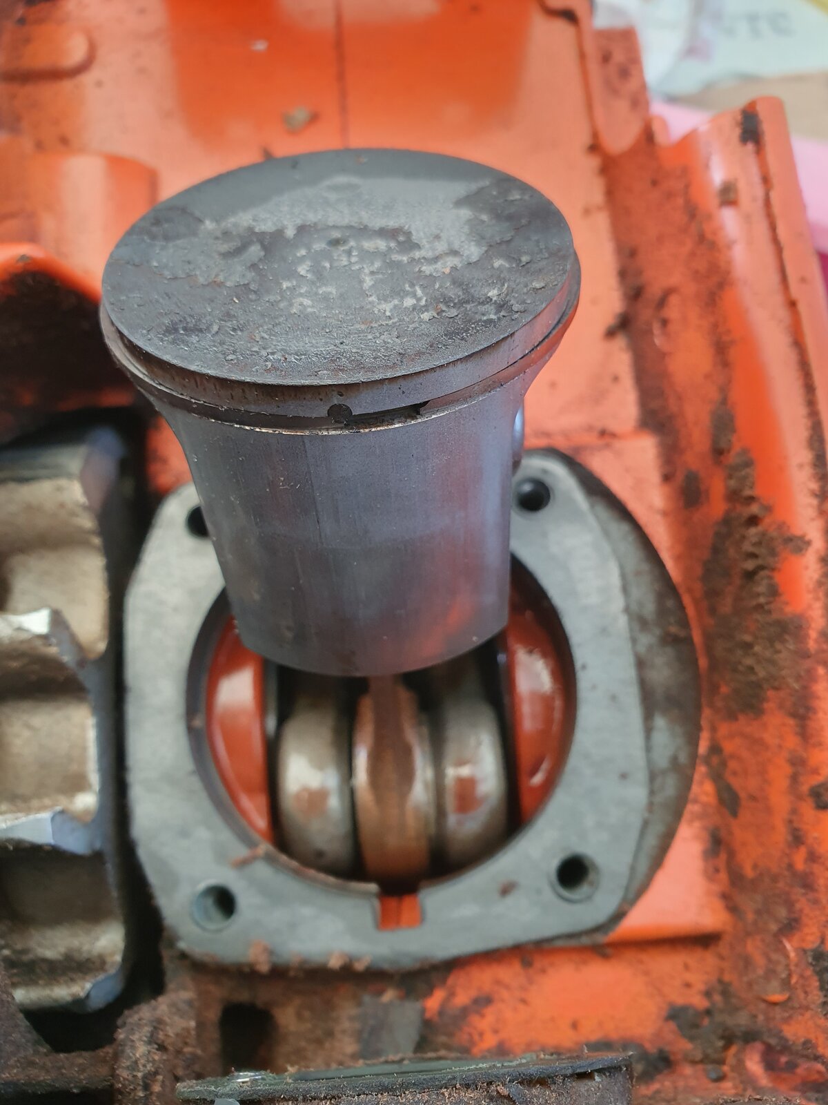

Here you piston photos
GhS got comet piston. Oem parts are very expensive
What do you think?
Piston seems okay unless they worn out

I would investigate the valve. Pour a dribble of oil down the plug hole, and if that doesn't help the compression, it's the valve passing.
That piston isn't as good as I'd like to see - it's a bit matt on the thrust faces. Ideally there shouldn't be any real abrasion there.
I'd go for the GHS piston, genuine ones are horrific in price....it will come with a ring, gudgeon pin and circlips - please use all of the bits!
John :)
John :)
