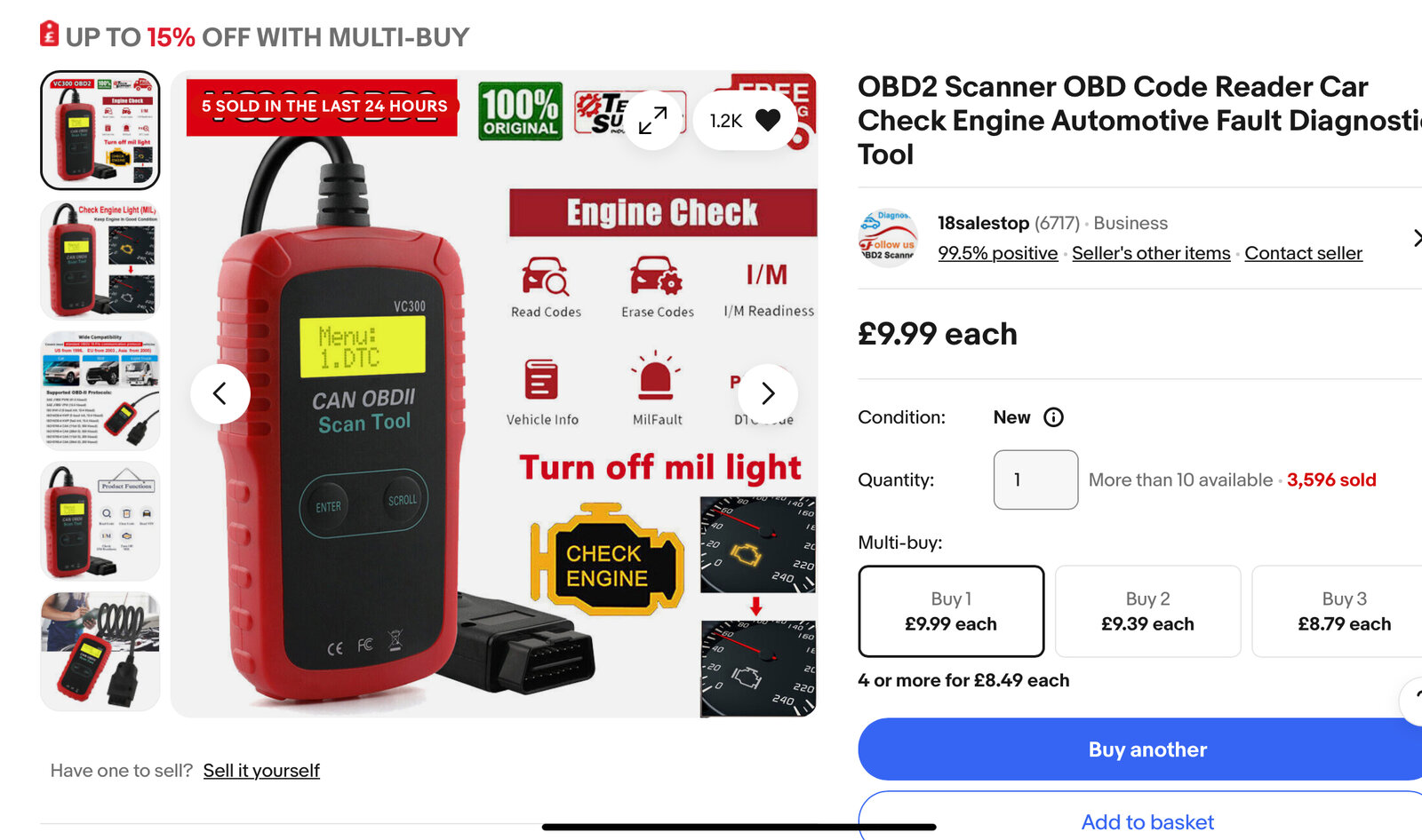

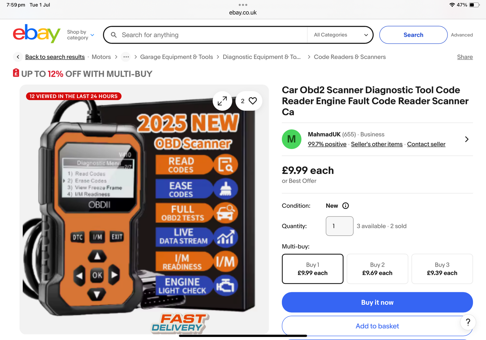

Bought one of these, about as much use as a concrete parachute, didn’t show any codes at all….
Some scanners, only show/work with engine codes, and that is what you have. ABS controller, body control, safety system, setting and tweaking options - need something more specialised. I have one, that gives me full control, I can tweak all sorts of settings, via my laptop..
Will that 1 do abs codes ?
Actually, looking at it properly, I don’t think it will. I’m sure my mate bought one for less than £20 a few years ago to clear an intermittent abs fault code on an old Volvo he had.
