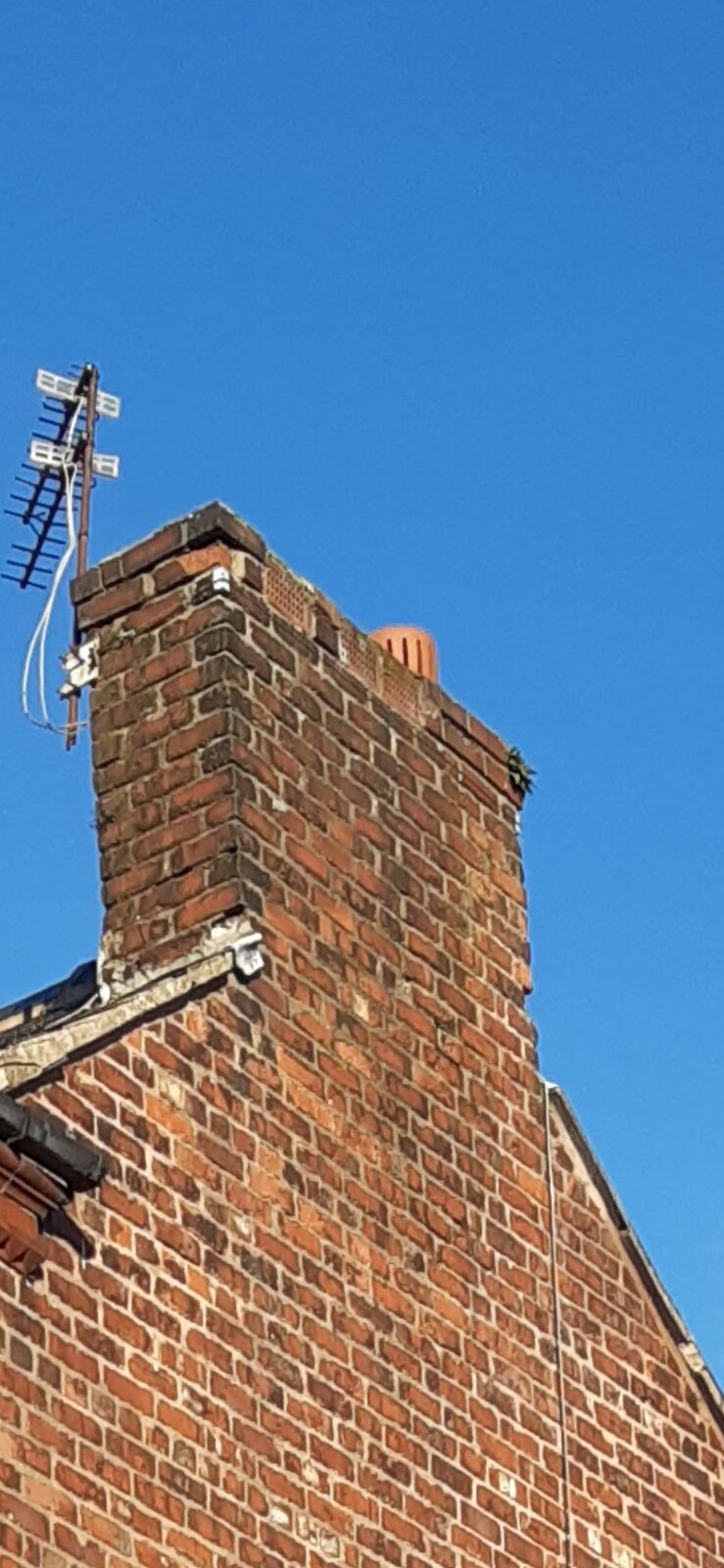

Hi, Heres a pic of the top of the chimneys, hard to see as it's a 3 storey building, there is a fireplace on each floor

Your pic shows a clay venting terminal - typically used for through venting a redundant flue where there is an opening or a vent at the bottom fireplace.
The pic also shows three air bricks in the stack brickwork suggesting that the air bricks are venting other redundant flues.
Your pic does not show how any of the flues have been capped - if they are indeed capped?
If you posted (as previously suggested) pics of all your fireplaces it would help?
A somehow obtained pic of the top of the stack - the flaunching - would also help?
Have you experienced leaks or staining on that gable wall and chimney breasts?
are all the fireplaces disused ?
The pic, of course, shows a clay venting terminal - the vertical slots indicate, to those who have experience and knowledge, that its an air vent for redundant flues.
Its not, and shouldn't be used as, a gas terminal.

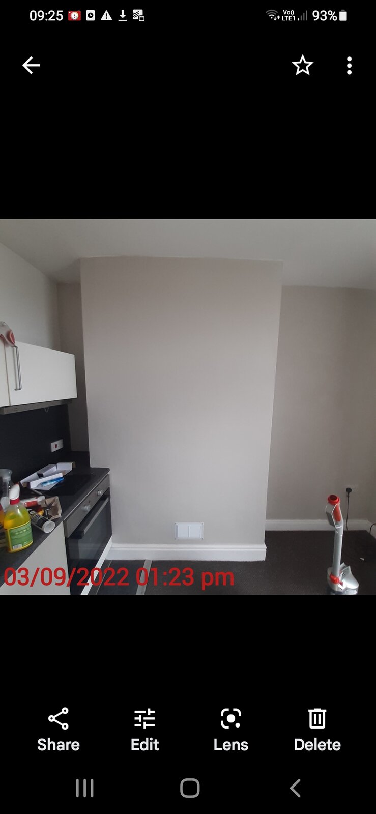

Thanks for your answers, I have only just had time to post the picture of the fireplace.
I have drilled a few holes behind the vent cover.
The fireplaces are all disused.
I don't get much damp on the chimney breast, but want to generally improve ventilation in that room, the surveyor recommended that a vent be fitted.

The pic shows a chimney breast with no signs of chemical staining. You could stitch drill or use a masonry hole saw to open up behind your plastic vent.
Pics of all the c/breasts were asked for - you might not see much but I might, simply due to experience.
Thats why I asked.
Best practice is for all chimney flues to be smoke tested and swept before any fireplace blocking up - and the condition of the stack flaunching and terminals determined.
