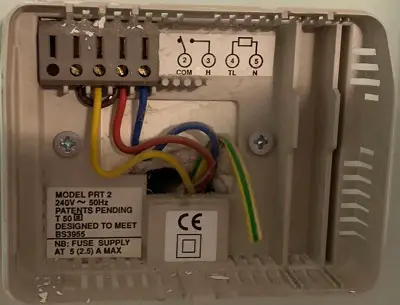

If your PRT2 is wired like this:
The wire in PRT2 TL would go to Tado COM (red in the example above)
The wire in PRT2 H would go to Tado NO (yellow in the example above)
The wire in N is not required and should be isolated and parked safely out of the way. (blue in the example above)
No connection is required to the NC terminal.

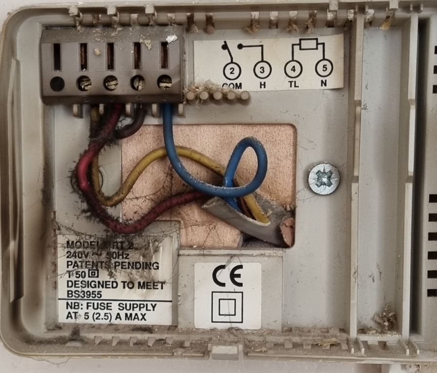

I got the Tado as mentioned by Stem, thanks for the recommendation, i took the cover off my PRT2 and it is wired a little differently to the one you have shown (please see attached - this has been up and running for at least 20 years as youcan see from the dust in there)
Mine is wired as follows:
1 -
2 + 4 linked
2 - Yellow
3 - Red
4 -
5 - Blue
Do I wire mine up as mentioned above but swap the red and yellow
The wire in PRT2 TL would go to Tado COM (Yellow in the example above)
The wire in PRT2 H would go to Tado NO (Red in the example above)
From an electrical connection point of view it is the same, just that the L wire is connected to the other side of the link.
Anyway in your case:
Red wire = Tado Com*
Yellow wire = Tado NO*
Blue wire in N is not required and should be isolated and parked safely out of the way
*In reality, because Com and NO are just an on/off switch it doesn't matter which way around the two wires go. When the switch is 'on' they are electrically connected together and when it's 'off' they are not. But convention is that the live wire goes to Com.
