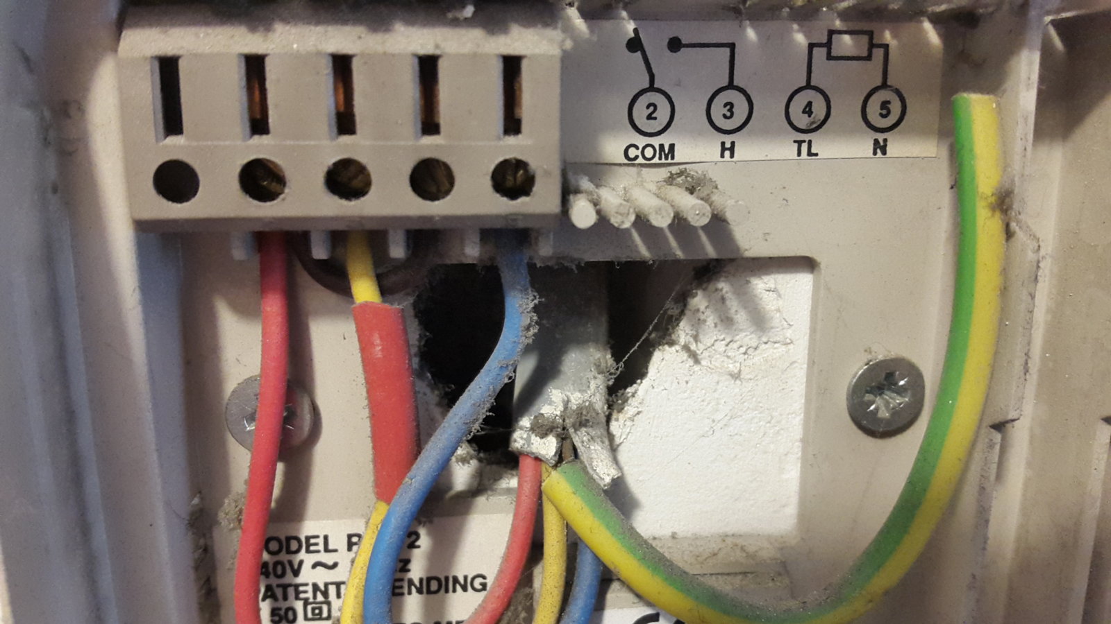

Hi folks, Im a bit of an electrical novice, but can the prt2 in the hall be replaced with a wireless equivalent of some kind so the thermostat sender can be moved into the front room?
The prt2 does work to a point, but more often that not for the boiler to kick in, I have to turn the dial below the room temperature and back up past it for the boiler to click on (suprima 40),
I would use the receiver in place of the prt2.
Im not sure if id need extra wires to support the connections to the wall base receiver.
Any recommendations on something which may fit also?
Many thanks in advance

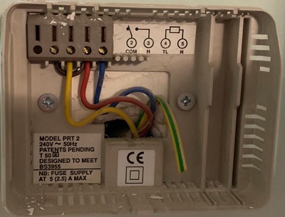

If your PRT2 is wired as below.....
.....with a live to terminals (2) & (4)....a switched live to (3)....and a neutral to (4)
Then you can install a receiver in its place. You would need to buy a programmable thermostat (one that provides both time and temperature control) and then the existing programmer would need to be set to be 'on' 24/7 so that power was permanently maintained to the receiver.
If your wiring is different, post back what you have.

Thank you for the detailed reply.
I will check the wiring later, would you know why the boiler does not kick on straight away if it is below the desired temperature? I manually have to sweep it anti clockwise and back to its original posiition
I'm not too sure of the internal workings of the PRT2. Older mechanical thermostats do get inaccurate as they age because of the wear of their internal parts, the newer electronic versions don't tend to suffer the same failings. Although the PRT2 has an old fashioned dial, so I guess that's one moving part, I seem to think the internal workings maybe electronic.

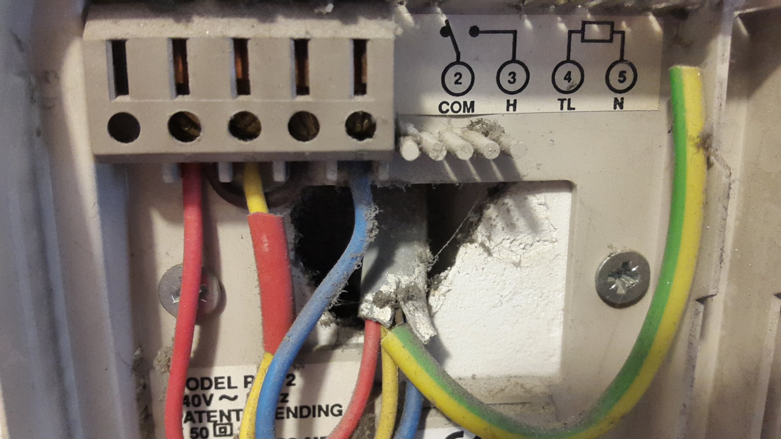

I've taken a picture
So yours is the same then as the photo I posted. The only difference is that the red (live) wire is physically in 2 with a link to 4. In the photo I posted the red (live ) is physically in 4 with a link to 2. But electrically speaking exactly the same.
L = 2 & 4
N = 5
Switched live = 3
