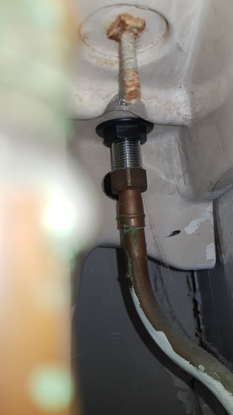

I may need to replace this tap is there any particular tools or advice that will help with access?
30 Sep 2013
372
6
Lanarkshire
I have a dripping tap in my bathroom sink, I have been advised on this forum that I'm better replacing it rather than fixing it.
The drip is getting worse, it's now turned into a fast drip and I can hear what sounds like rushing air coming from it aswell now.
For replacing the taps I'd probably rather just get someone in to do it but I'm unlikely to be able to get anyone till the middle of next week. I'm not sure how these problems usually progress but as it seems to be getting worse I'm concerned the valve might fully "go", as this is just a small washbasin it would not cope with that level of leak.

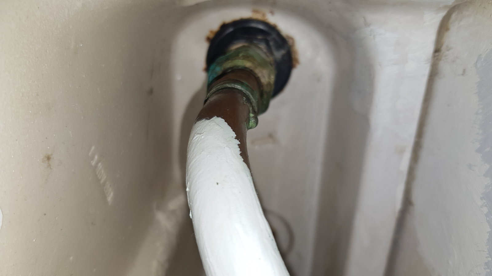

Anyway I'm looking at access to the nuts (both for the pipe to connect to the tap thread and also the securing nut for tap onto the sink) both look very awkward to access, I assume this is a common problem so are there any particular tools that would help with this or any advice on how to go about this?

Thanks, so are these pretty specific tools I'd need? I'll have a look, I was hoping to get away with some gland pliers and a shifter...
I had posted a thread previously where I was told it would be hard to get the replacement insert, I'm going to buy a set of flomaster inserts from screwfix on the off chance they will patch it up should it get any worse.
Is there any other options I could use to temporarily stop a leak for a few days until I can get someone out? I was thinking I could wrap the tap outlet in self amalgamating tape to seal it but not sure if this will cause any issues with pressure etc in the system. Basically I'm just looking to have a few options up my sleeve.
On the fibre washer, where is this fitted (ie between tap an sink?) and do you know the standard size I'd likely need so I can pick some up?
Thanks again
Thanks again

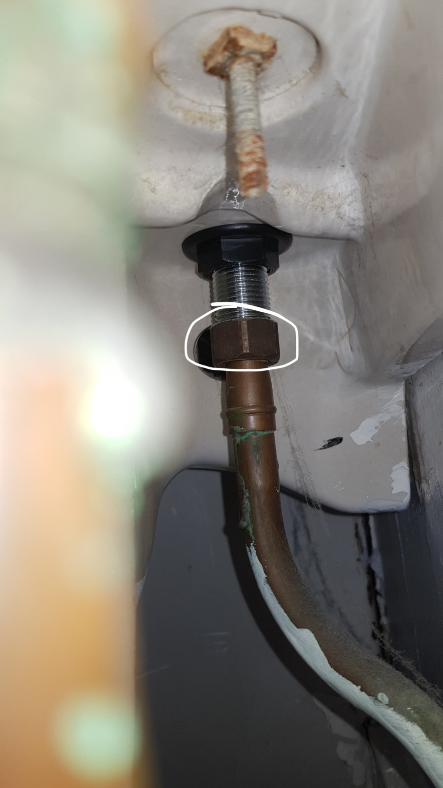

  • You couldn’t stop it dripping all together until repair/replacement is done if there’s an isolation valve fitted, if not you could fit one?
  • Half inch fibre washers and they go between the tap and tap connector

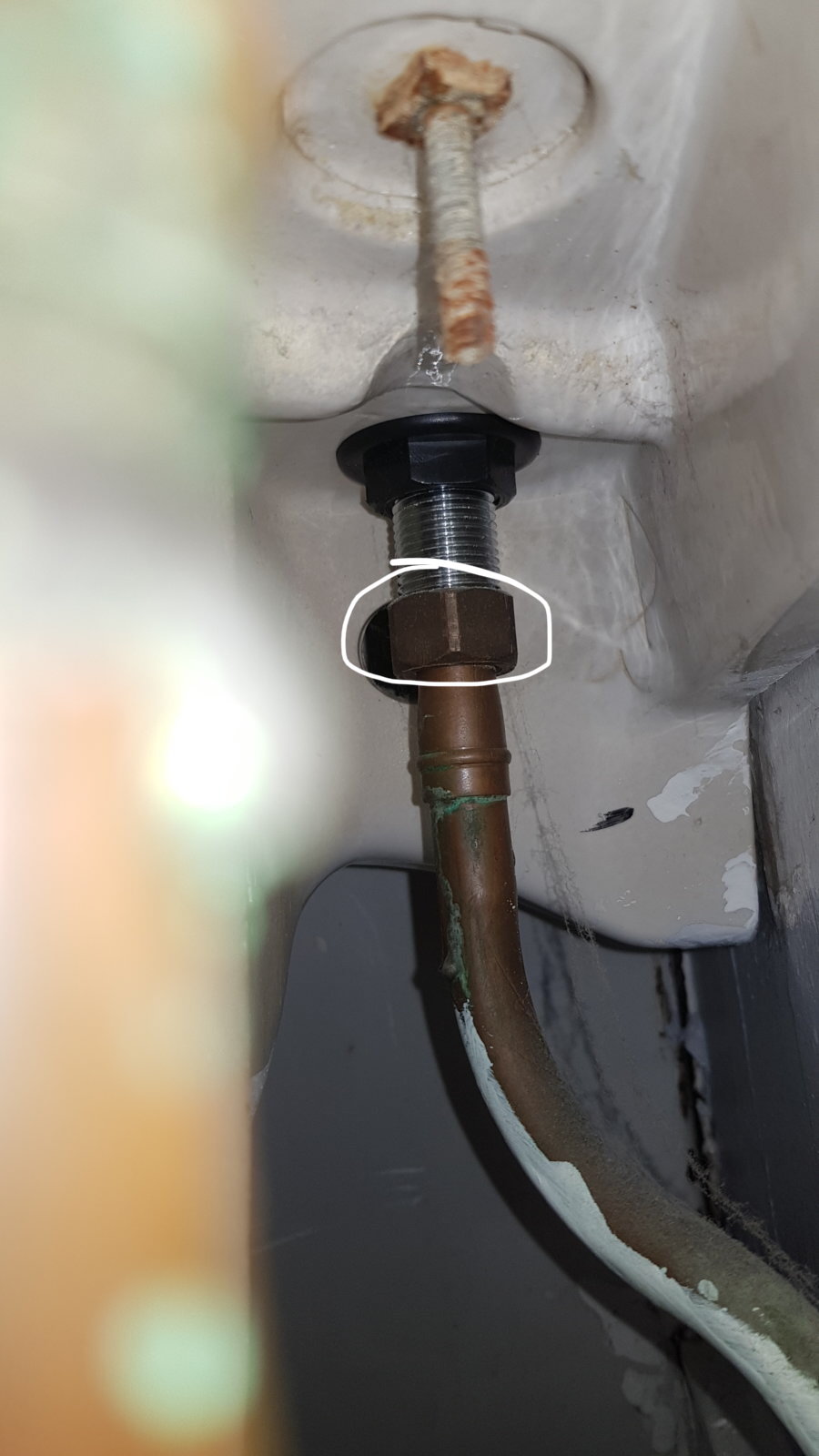

I have inserted your photo edited (circled in white) is your tap connector, but you also need to make sure all of the old one out otherwise it will leak.
