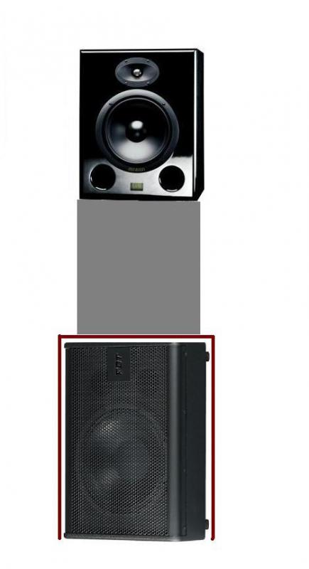

I think I have finally come up with a plan for my new speaker stands in my recording studio...!
I need to make speaker stands that have a heavy mass and high density (so that they do not transmit sound or resonate). But I also need to have some space at the bottom to site my PA speakers...
Here's an awfully crude and out of scale mock drawing:
The red part will be a metal table, the grey a concrete block. I had racked my brains for how to make the table part - first I thought wood, then I was going to have a concrete table made. But then, whilst at work having a fag (tut tut) I was looking at the heavy duty metal gate and thought - hmmmmm - I can use that!
But I'm not even sure what metal the gate is from. It's very heavy duty and weighs loads. I'm sure a table made of that would have no problem taking the weight of the concrete block and speaker....
What I have no clue about is where I could go to have something like this made. My first thought was a fence/gate maker, but I'm not sure. So I thought I'd ask on here. As you can probably gather, I'm quite clueless in this area! So any pointers would be great.

If you cast the concrete in a block you could just leave the legs sticking up out of the mould, then turn it upside down.
You will have a massive point load where the legs meet the floor though, so you probably need a base as well.

A gate is usually a rigid array of tubes that gets its rigidity from being in an array. A single tube eg a table leg is going to have to be a lot more substantial.
Re point loading, if you can put substantial screws into the joists then you can use spike ends onto the screwheads to get a stable support that doesn't disappear through the floor. A triangular rather than quadrilateral arrangement for the feet will always be stable.
A welded joint should be as strong as the metal, which if it's thin tube won't be very strong in bending. Kee Klamp you just cut to length and bolt together.

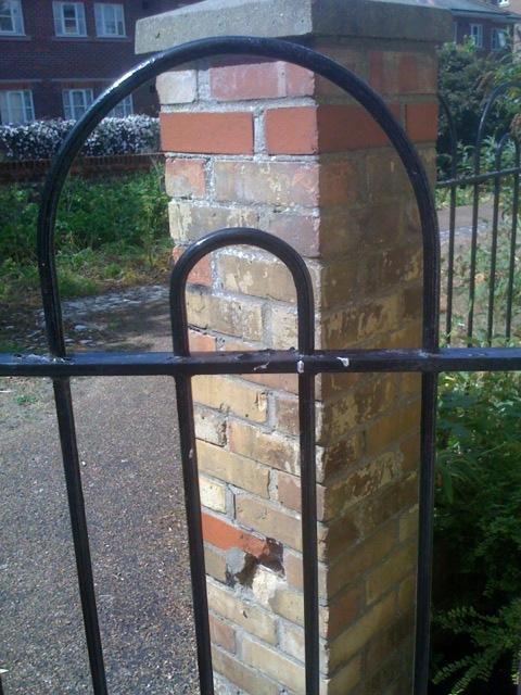

RE: materials.... what would the strongest metal be that would allow me to have the legs as thin as possible? Wrought iron? Steel? I'm not at work this week but I've asked a colleague to take a pic of the gate - which I'll add once I have it. +1 for modern technology!

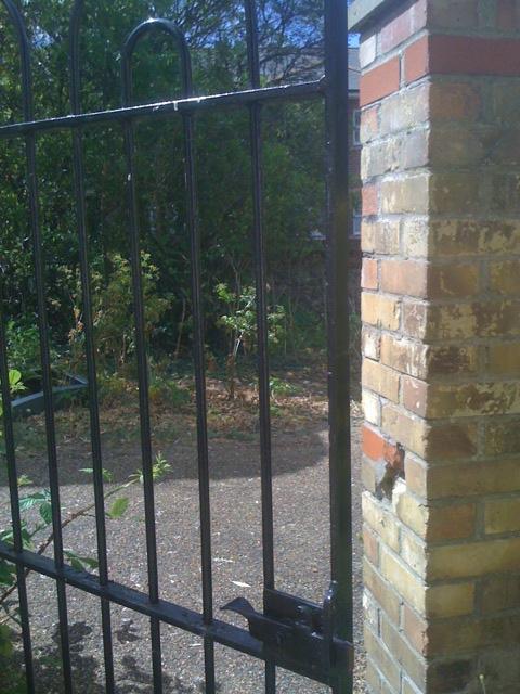

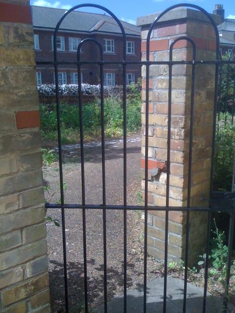

you could probably bend the rods on those gates with your bare hands.
The problem is that individual legs have no lateral bracing and will collapse as soon as there is a load which starts bending them.
If you made it as an open-fronted (5 sided) cube then you could do it in chipboard quite easily, because the sides of the cube brace each other.
Try it as a cube with no back though and the sides will easily go squinty.
Hi
It wasn't the rods in the middle of the gate I was referring to, but the rectangular strips that form the outer of the gate. They felt pretty strong to me....
Good point, so maybe I can add (or ask to have added!) some lateral bracing all around apart from the front (so I can slide the bottom speaker in and out). So - near ground level - horizontal bars will join the front legs to the back legs, and the two back legs together.
Not a bad idea and one I'll think about.... Could I use 18mm MDF? Would this kind of structure definitely be strong enough do you think?
