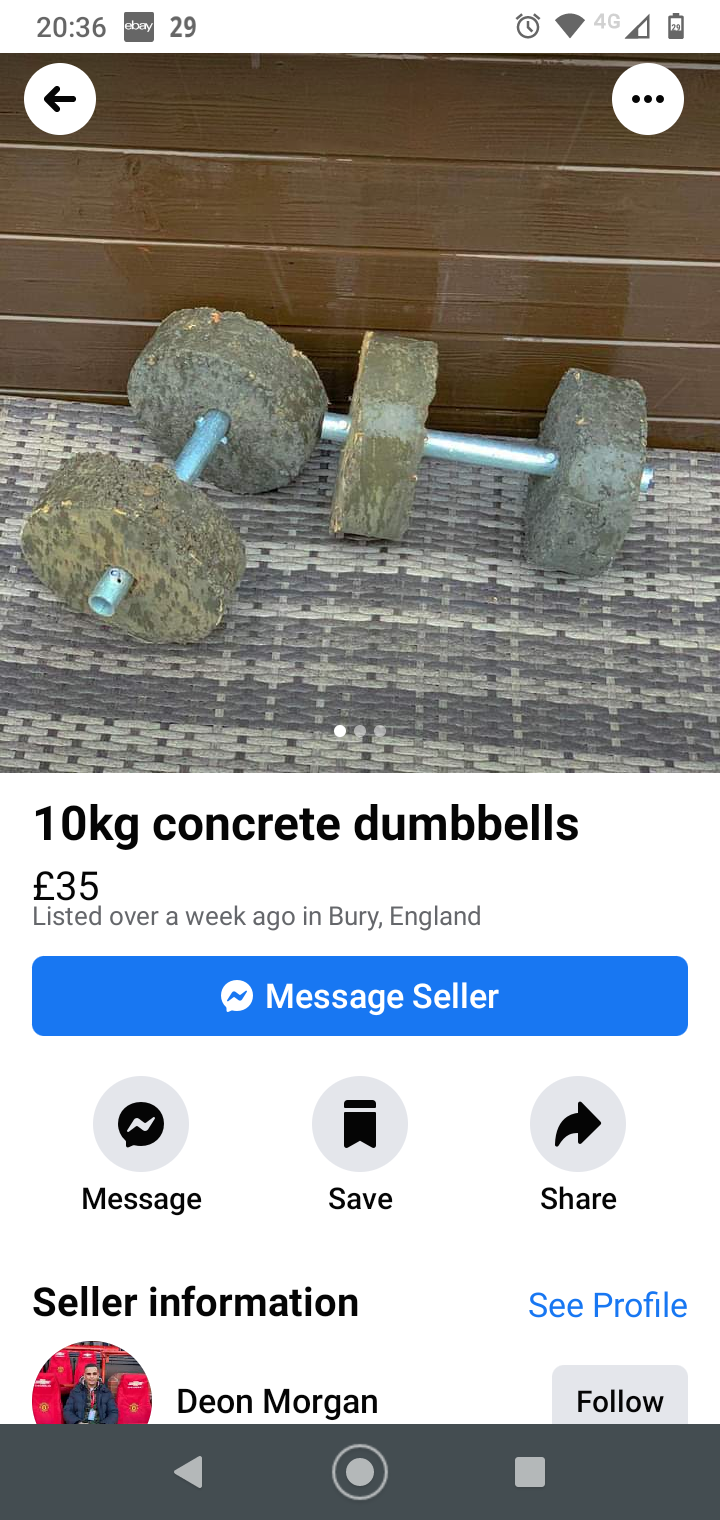

    Unfortunately they're like gold dust at the moment - all the reasonably priced sets in Argos have been bought up by scalpers trying to sell them at 2-3 times the price on Facebook. Or even greedier:

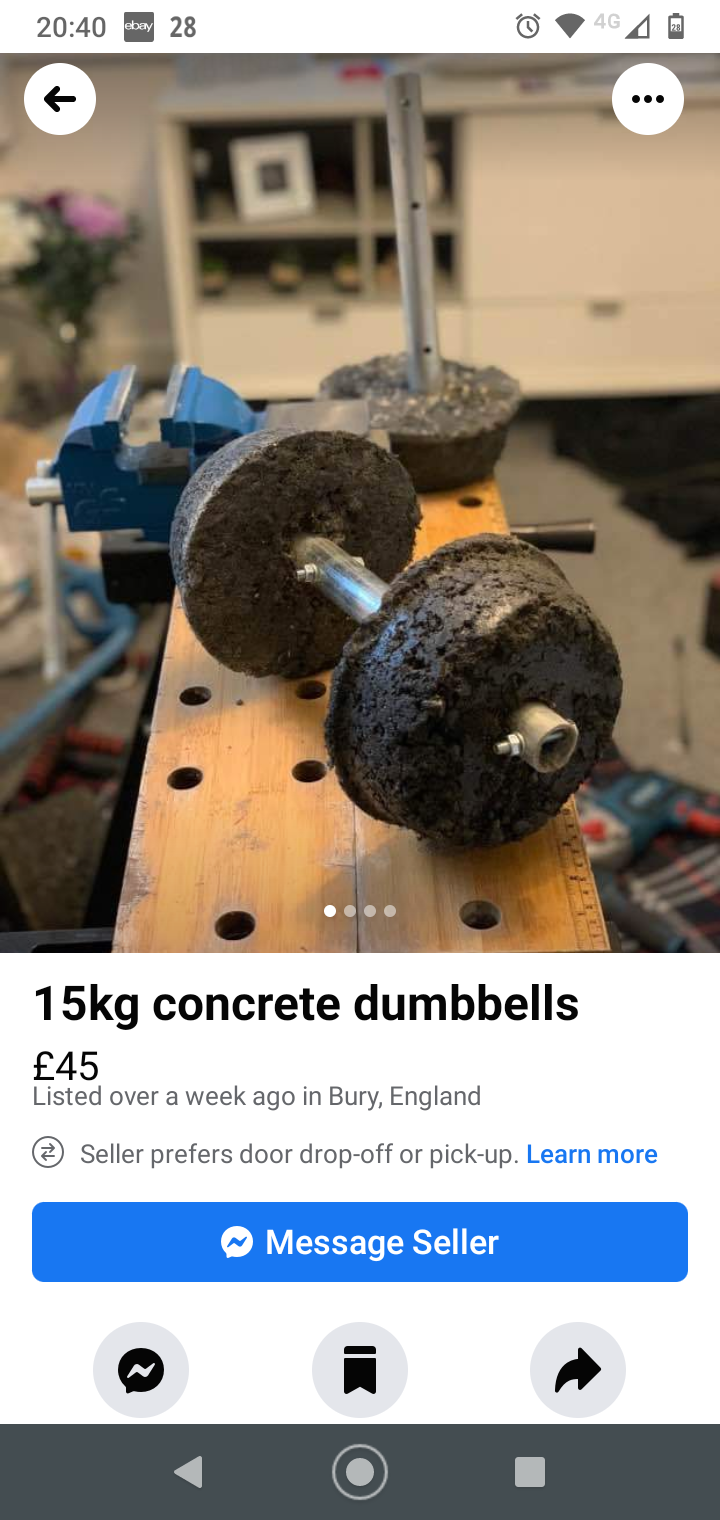

    £45 ouch -
    And they do not know how pour good concrete
    Or how to vibrate the molds to make a nice surface.
    And in use I would be worried about tearing my hand on those overlong bolts.
