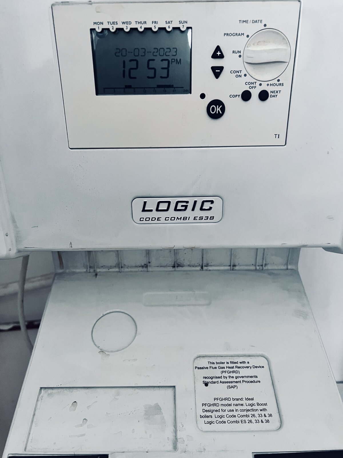

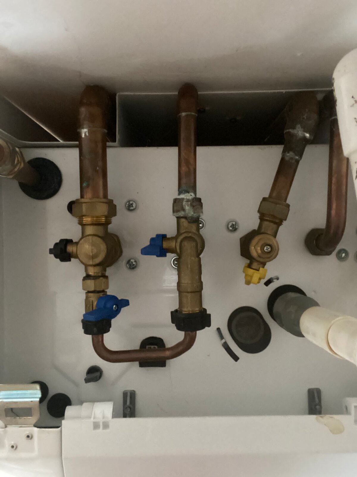

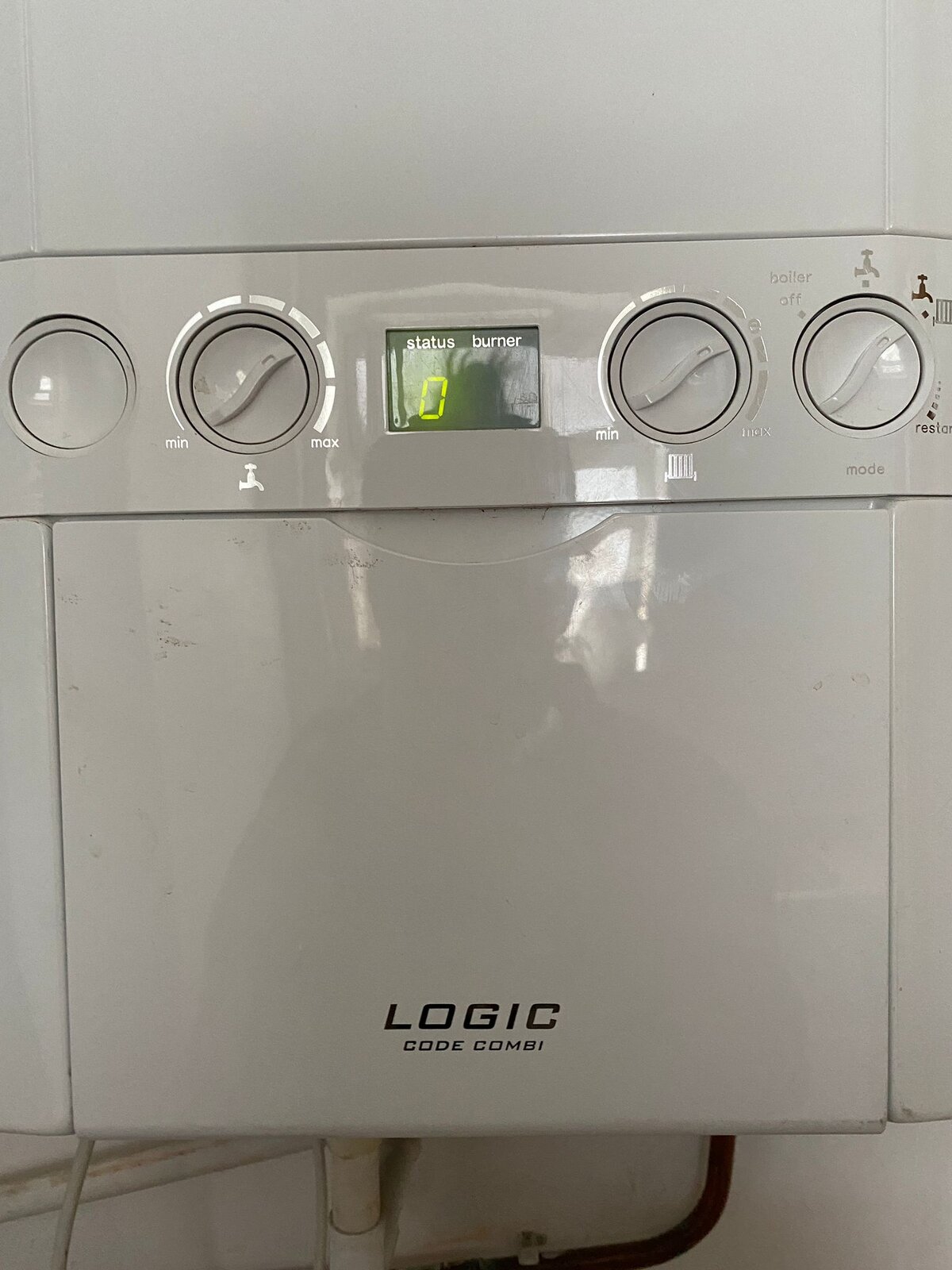

Hello there

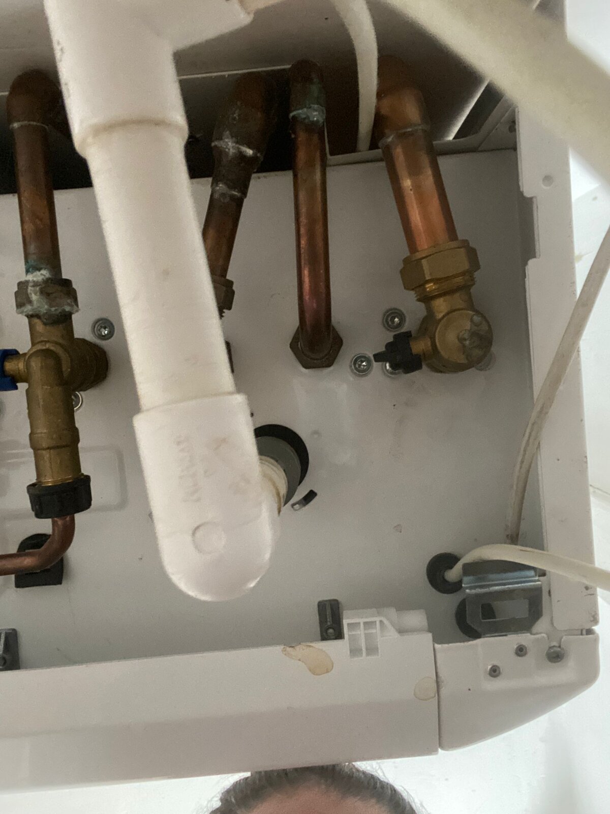

My daughter just purchased a house and she had a plumber to replace 2 radiators
After bleeding system and radiator fitted, plumber couldn’t find pressure gauge on the system
Here are some photos . Ideal es38 combi
Any suggestions

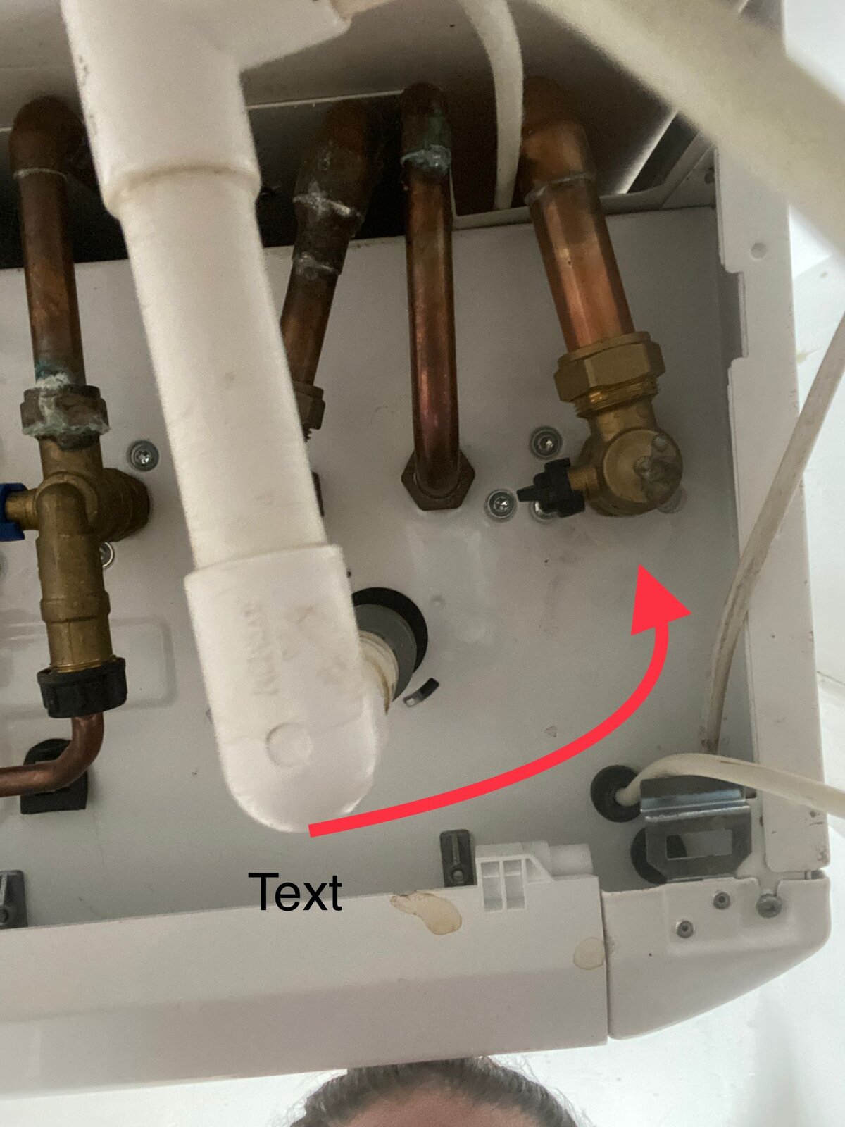

There is the flow pipe but not pressure gauge
Photo was taken upside down

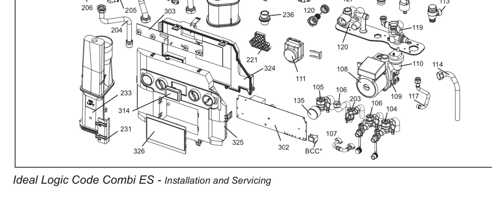

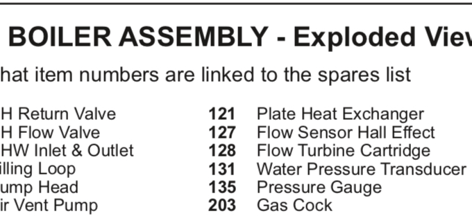

So , shall i remove this elbow valve and replace it with a one with a pressure guage attaced to it " the proper one 175528 ", I double checked and can not trace a pressure guage attached to the system. Do this flow valve comes with a new boiler or purchased separatly?
Item number 135 on diagram hth
