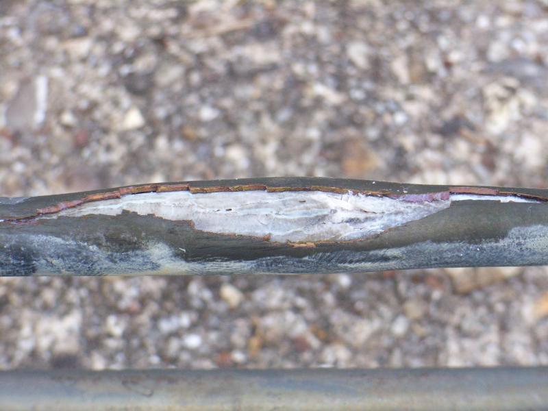

Hi guys, help needed before I change my immersion.
My water seens to heat up slowly and not very hot (im on electric and have immersion only), it has heated up scalding in the past, but seems slow and warm but not as hot as usual.
Stat is fine, but resistance of element is 3.8M ohms across terminals and 1.8M ohms from terminal to earth. Obviously nowhere near the 18ish ohms it should be.
I'm an electrician so know how to test etc, but this reading doesnt make sense to me, just thought has someone else experienced this?
Any ideas?

Replaced the faulty element now . It was wrecked, 6 splits in it see pics :eek:
It was a bugger to remove, had to tap union with a hammer to free up and then tap the box spanner. Thought it wasnt going to shift but it started to move :D , just had to ease left to right until free then it came out. Couldnt drain tank after it was moving as I reckon the drain is clogged, nothing an old towel couldnt fix.

Joking, fully earthed, no tripped breaker and voltage/current flow ok. Yeah, it does seem suprising but as the water was getting luke warm only I can only guess that the element did not short to earth and the current was flowing through the water (water providing resistance), hence heating water slowly.
