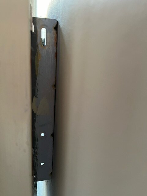

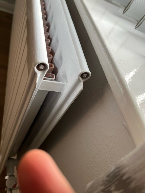

We've been in our current property for 13 years. It was built in the 90s. All the radiators were roll-top and imperial sizes.
We're replacing the boiler, so it's a good opportunity to replace a couple of the radiators that have been repainted numerous times and so the heat output has been reduced, and the awful orange colour they painted the walls can be reached.
Looking at the measurements of the radiators they exactly match the Myson Premier HE imperial range. The only concern I have is that the bleed valves are sited in the end of the sections of the radiators, and the brackets are 239mm high rather than 249mm shown in the Myson technical drawings.
If they are Myson radiators the question would be whether they are an older version, and whether the current version would fit on the old brackets, or I'd need to replace the brackets as well - in which case, go for something like Stelrad.
Could these be another make from the 90s?

I'd be amazed if you can get rads to fit onto existing brackets.
Few minutes job per rad to fix new brackets.
If you fancy stelrad look for henrad they are identical made in same factory but sold through independent merchants often at a better price.
Just a fancy name - anything with ECO attached to it just now is really just an advertising gimmick. Convecting radiators haven't changed in years, as they can't really improve on the efficiency of the design.
Myson were the best know for round top rads as they were sold as a safety feature with no sharps edges etc and a bit better on styling. There were a couple of other manufacturers that created similar ones with bleed screw at the back of the panel but none to any great degree.
As suggested, best just to fit new brackets.
