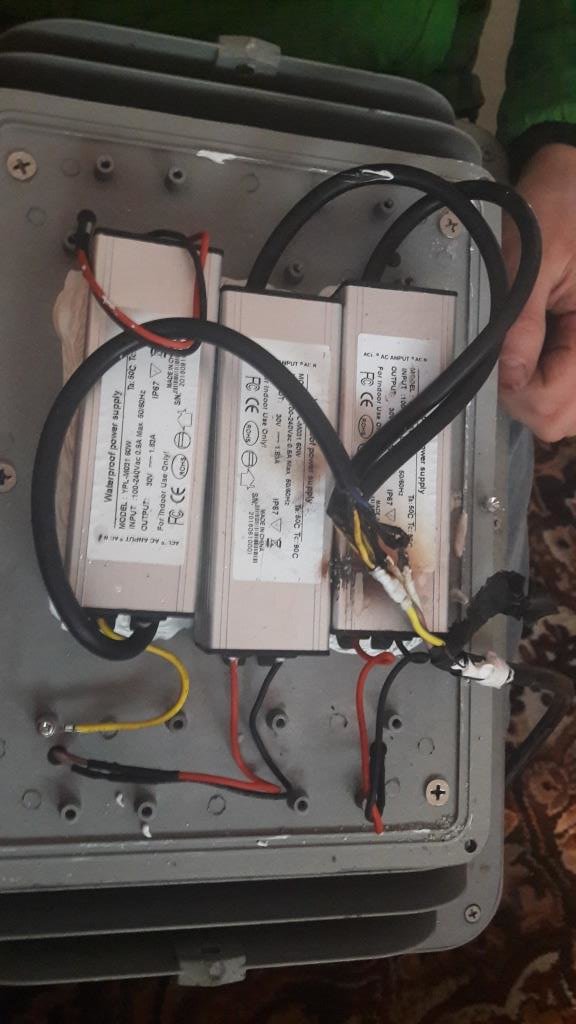

nuisance tripping caused us to look into this deck floodlight.
230VAC spliced into the driver whips. heatshrink not fully covering the splices.
This gear is imported (possibly exclusively but I doubt it) by aaaweb.co.uk
