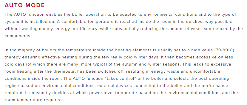

the user manual is not quite informative. i suspect the Auto function is more related to CH than to HW.
I have read the manual. The boiler seems to have a built in weather compensation/load compensation mode called AUTO. How it works depends on which controls and sensors are fitted to it.
When you have the HW on by itself, without the CH, is the boiler temperature higher?
If you turn off AUTO, you can set the flow from the boiler by pressing the +/- buttons on the right of the display.

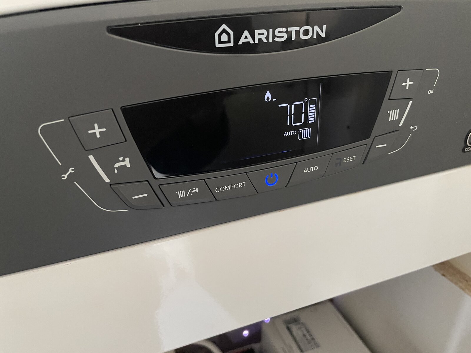

first thing in the morning i set the cylinder thermostat to 60C and let the boiler ran DHW on for a full hour (with CH switched off and boiler's Auto function on). after an hour, my boiler was still running at 70C and the cylinder thermostat did not seem to have kicked in.
water coming out from the tap was hotter than before (my gut feel was maybe 10C hotter) after an hour of boiler operation.
I then continued to run DHW on for another half an hour to see if the thermostat would kick in. After another 20 minutes the boiler finally stopped running.
Considering the cylinder was not emptied the night before, is 1 hour and 20 minutes of reheating time indicative of any problem in my system? I start wondering if my cylinder/boiler/insulation is too inefficient for DHW.

So after say 1.5 hrs the cylinder stat is reaching 60C, if so and if the whole say effective 110L was heated from 25C to 60C then the cylinder coil is emitting < 2.0kw, something very wrong there, was the boiler cycling on and off very frequently?.
Check the cylinder coil return (bottom) pipe and see if it has a valve on it, either a wheel valve or a valve with a lever on it.
I think your boiler's minimum output is around 3.5kw so may have been cycling or borderline.
Is any heat reaching the other radiators? If the 3-port valve is old and worn out, this can happen.
I don't know the limits of the heat exchanger coil in a yellow cylinder. If it was only 3kW, it would take about 2 hours to heat 120 litres. There might also be sludge in the pipes. There will be losses from poor insulation. Presumably it is fully pumped? Please show some photos of the pipes, cables and devices around the cylinder.
Have a look in the loft and see if the feed and expansion tank is hot.
P.s.
Buy some thermometers so you can accurately test the water.
