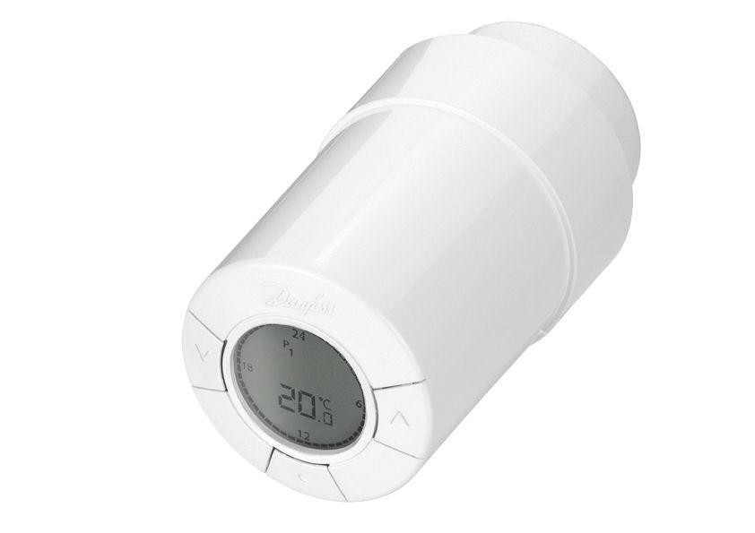

So next thought is:- Electronic programmable heads for the two rooms, to get rooms to required temperature, rather than the hall, either that or some electric head and wall thermostat.
However my son is telling me the by-pass valve will fail if it operates for too long? He tells me I must have a thermostat to turn off boiler, (a Worcester combi-condensation) and I can’t use the valves on the radiator to control heat alone. With a wired head I could clearly combine the two radiators so if either one calls for heat the boiler will run but the thermostats are normally single pole which means a couple of relays or maybe a PLC I have spare.
I have tried setting the existing TRV but don’t seem to be able to get a happy medium either mum complains too hot or too cold. With my home thermostat you can press the hotter or colder buttons and at next temperature change it reverts to programmed temperature some thing like this would be ideal.
So what head can I get for the TRV and do the heads have micro switches like found in motorised valves? Will the programmable TRV be any better than a standard head at controlling temperature? And are the heads all the same or do I need one special for that make?
Yes I know could use two motorised valves but they are bulky ugly things. Heads for existing TRV would be far easier to fit.

sensor heads are £12 to £40 and although I am not looking for cheapest option I am uncertain what the extra £240 will give me. OK don't have to bend down to alter settings but both are measuring temperature close to radiator rather than at other side of room so can't see advantage.
All the units there seem to be a host of different makes seem to lack info as to what valves they fit. Some can be controlled from ones phone but my mother has a problem with TV remote never mind an android phone so it will be a case of set and then forget until batteries fail.

Horstmann DRT2 Programmable Digital Room Thermostat in each room and a programmable TRV both set to same program and for the two rooms £75 would both switch off boiler when warm enough and control radiator but is this all required?
The problem at the moment is carers fiddling with the temperature settings. With best intentions they screw up the TRV or wind up the wall thermostat and roast my mother who then also plays and is near frozen.
The programmable units if I am right allow on to change temperature but at next program change they revert to program so within 12 hours any fiddling is cancelled.

Evohome will give you a boiler interlock. So it only fires when it needs to rather than than scooting round the bypass circuit unnecessarily heating that loop and cycling the boiler even more.
