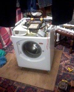

dryer heater look anything like this on top?
