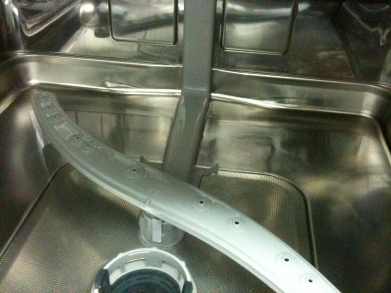

Hi have an Indesit IDF 125 dishwasher that started misbehaving after two power drops. The cycle starts, rinses and drains first time. It doesn't open the detergent cup, and never goes in to further steps. It remains flashing the "Start" button light and then goes off after 1 hour so. When left turned off, eventually will start draining and the middle-bottom led and the start button led will blink intermittently. After a good time doing this, it will turn off.
I cleaned and pumped with plunger, I removed the machine's bottom cover and accessed the drain pump, I found a screw within the turbines that looks like the one from the sink of the dishwasher, but none of them were missing. I mounted everything back and still the same behaviour. The only difference is that it doesn't make noise when drains I guess the loosen screw was obstructing.
Any ideas what to look for? Thanks in advance.
Do the basics
Cancel any previous programme
1) 2 jugs of water in tub, turn on, select any programme, wait for drain to finish, open door, all gone?
2) close door, start cycle again, wait for it to finish filling, open door, wheres the water level?
Thanks Yardi for replying,
I did as you said.
1. I poured the water on tub and without turning on DW and starting cycle, the DW drained the water. However, I tuned it on and started cycle, the drain continued but the remained blinking middle -bottom and start buttons.
2. I turned it off and on, started a new cycle, and then machine drained a bit, then started filling water and I paused and open door when stopped filling. The water level was up to the elbow of the vertical rinser, i.e. the edge of the tub. I closed it and left it continue, but then the cycle stopped at start button blinking again.[/img]
I think a photo of inside the tub to see how high its filling with the aide of your description above could help.
Do you think it could be overfilling?
This is what the DW does though it is turned off. It has been like that the whole night. It is just flashing without draining.
This is the water level during the rinse part of the cycle.
It is overfilled? I have no idea as I never checked the levels, can you tell from the photos?
