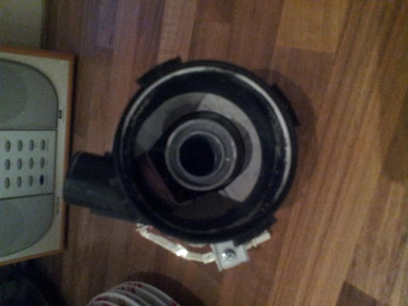

The water level is not clear in the photo but it should really only need to cover the bottom filter plate that the filter screws into.
I think your water level is probably ok and believe the problem is more likely to be related to the heating element.
Do you have access to a meter to test?

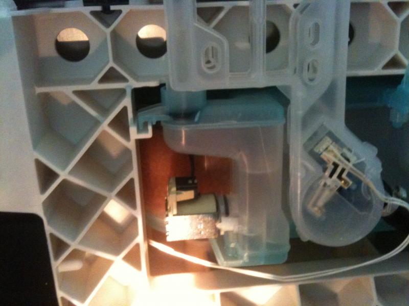

I removed top and left panels. I know for sure both waste and intake water hoses are fine as I checked them yesterday. I selected the soaking cycle and it finished. I saw the water coming normally. The left hand side looks like this

What is that orange at the left-bottom side? is it normal?

Not sure what the orange part is, photo not very clear but there is a valve just below it which lets in softened water, not always activated!

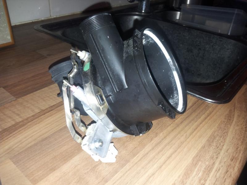

You got a heater fault. Part no is coo256527. Cost about 40 quid or less.
How old is the machine from new? Curious!
Buy a cheap multimeter with test leads, £5 one will do for basic testing.
If you find the fault to be the heater you'll know its worth spending the £40 on a new heater.
Rocks : do these heater types have a high failure rate? i.e not the thru flow on most dw and not the common bosch ring type(similar to wash machines).
I'm guessing they are a newer design of heater type being fitted to many new machines now.
Yes very high. I do loads of them. It's because the mc don't get cleaners though them very offen. The mc does a test at the start and errors in 30 seconds if theres a fault.
That applies to all heaters surely just wondered if this type was exceptionally prone to failure due to design.
