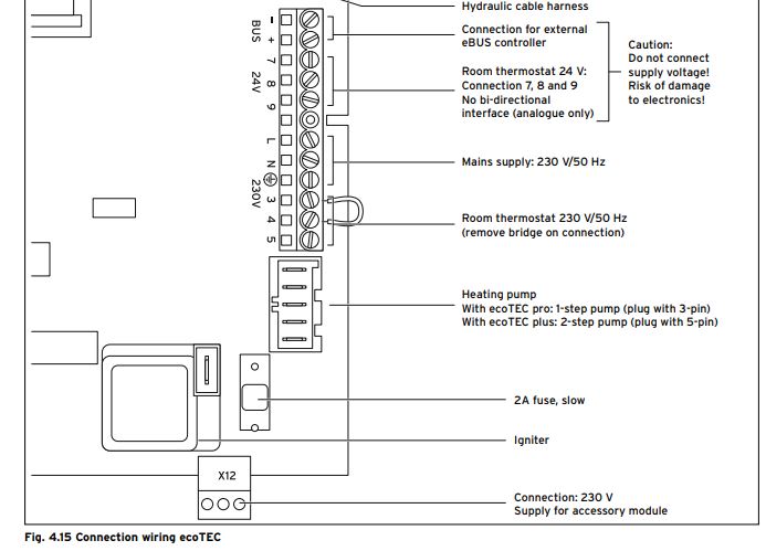

Not sure why you have posted a link to a post about a Vaillant Turbomax, that's a different boiler. In the same way that a Ford Ka is not a Ford Focus. Anyway, the manual I have for the ecotec pro, shows that it is suitable for 24V or 230V thermostats
But you should check the manual supplied with your boiler, yours may not be exactly the same, Vaillant do change things from time to time.

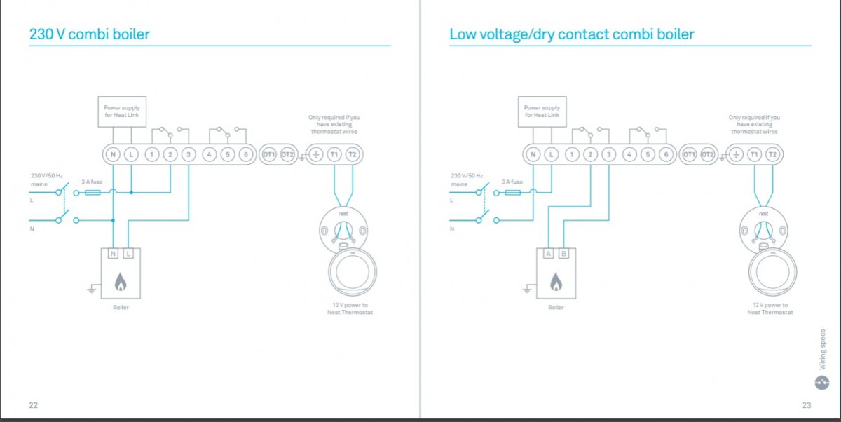

However, having said that, it isn't really that relevant, the Nest Heat link has 'voltage free contacts' so will switch 230V or 24V (aka Low voltage) whatever it is connected to it. The diagrams below show the two ways of wiring it according to the voltage.

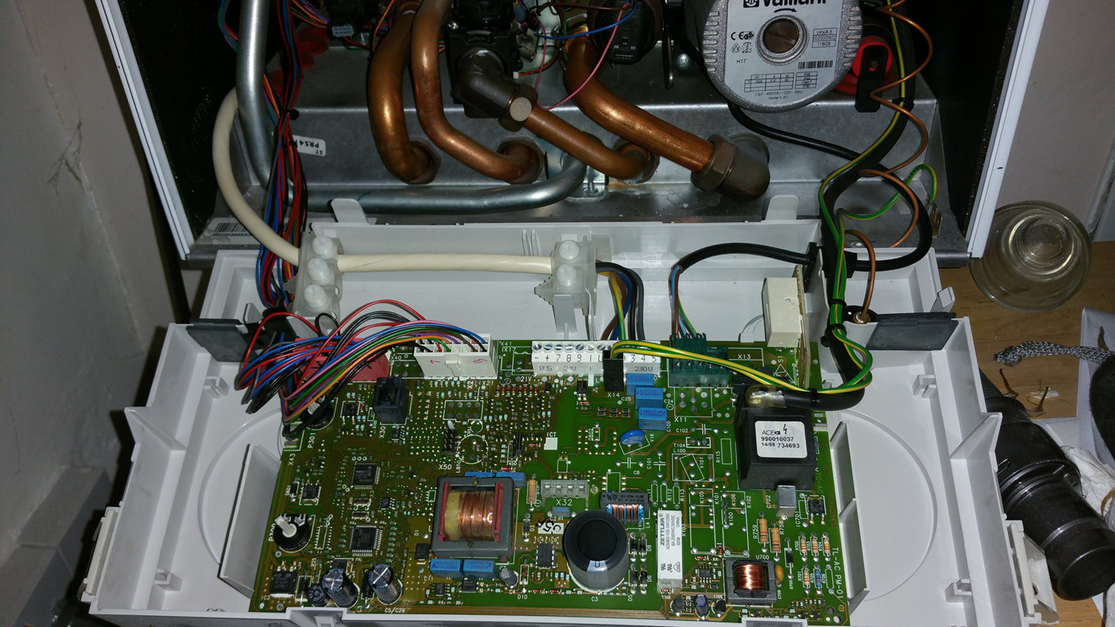

That's true - the top cover has to be removed then there is a drop down panel to access the wiring.

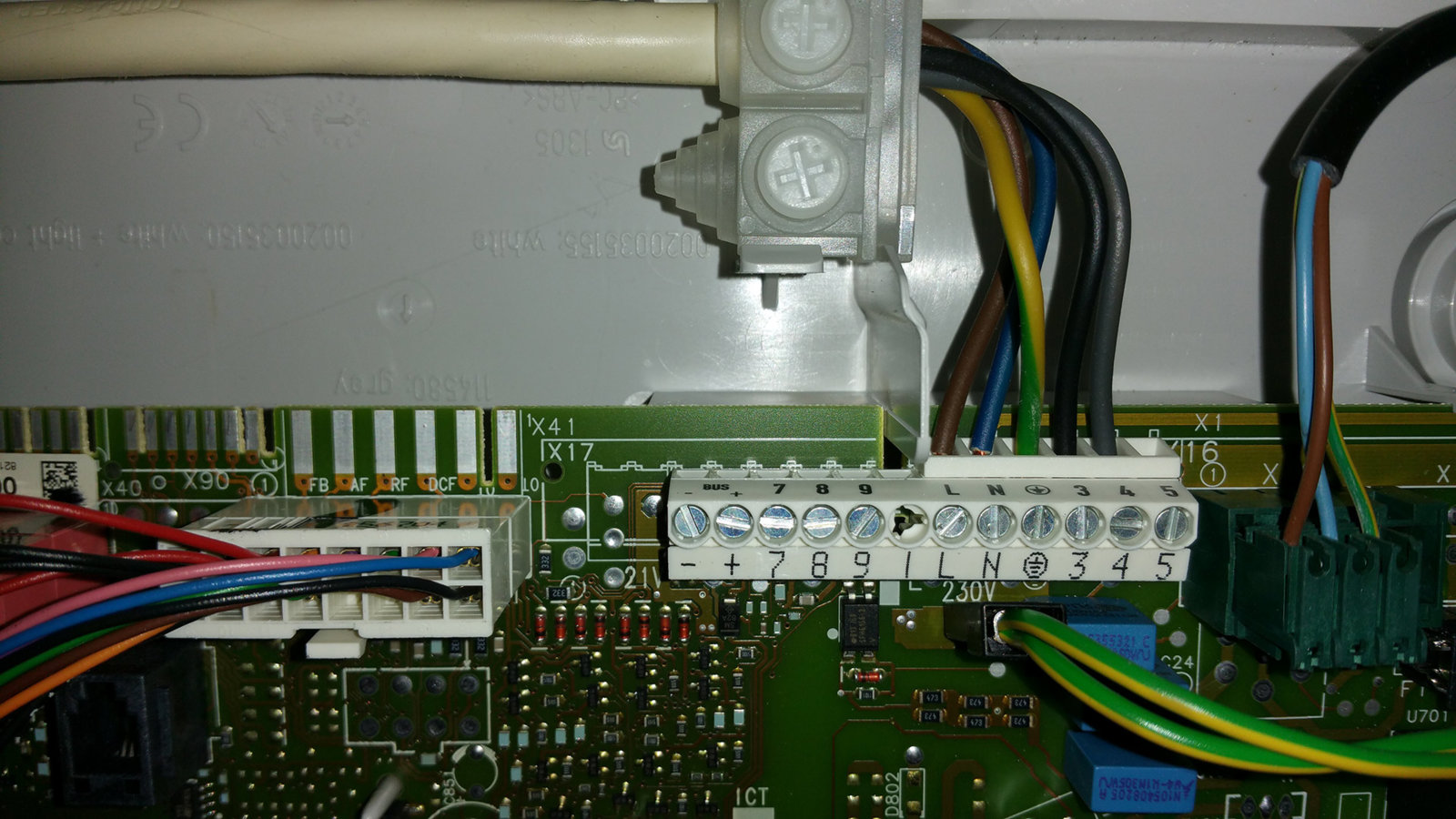

I opened it today to check:
I am presuming the black / grey wires going to 3 & 4 on the block are from my existing (non - wireless) thermostat
That is correct for your version of the Vaillant. Terminals 3 and 4 are shown below with a link (i.e. no thermostat fitted) hence why I said check the manual that came with your boiler.
That cover is the room-sealing cover which should only be removed and replaced by Gas Safe Registered Engineers
