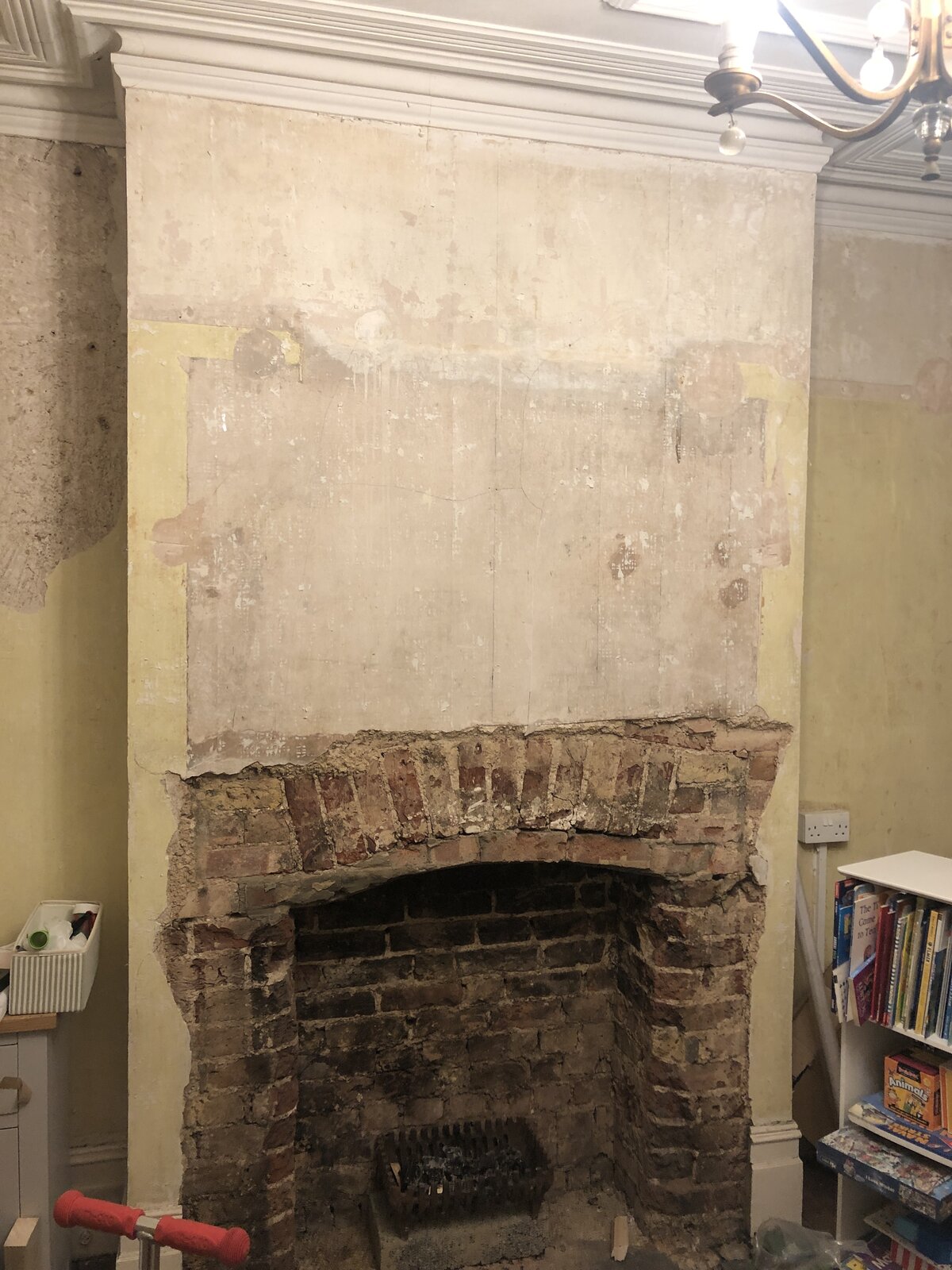

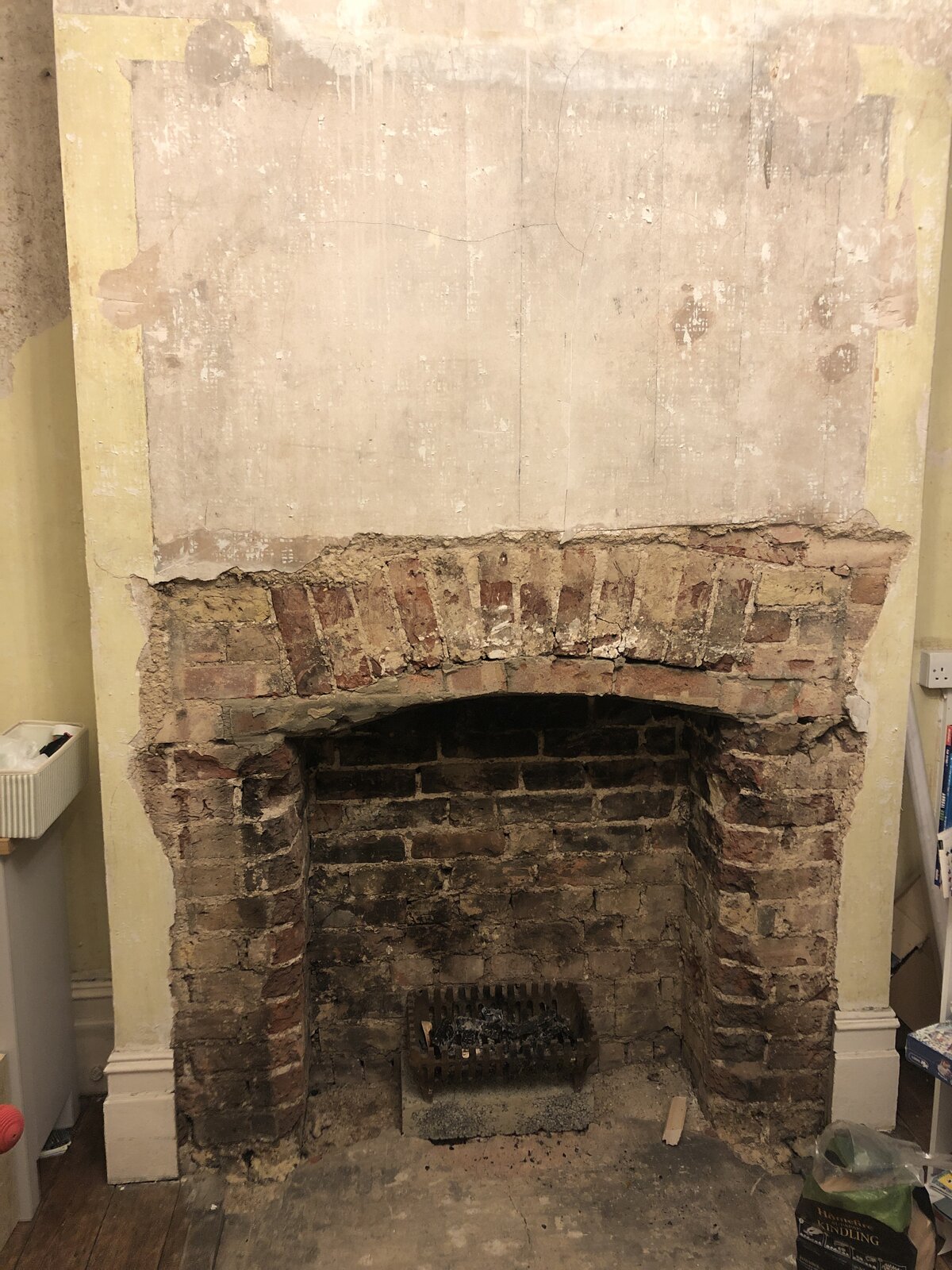

While you have the scaffolding it may be an idea to cover the chimney and light a smoke pellet and see if can detect any leaks . have you a picture of the fireplace
You wouldnt necessarily get much better draw with a liner in a cold flue unless the old one was leaking.

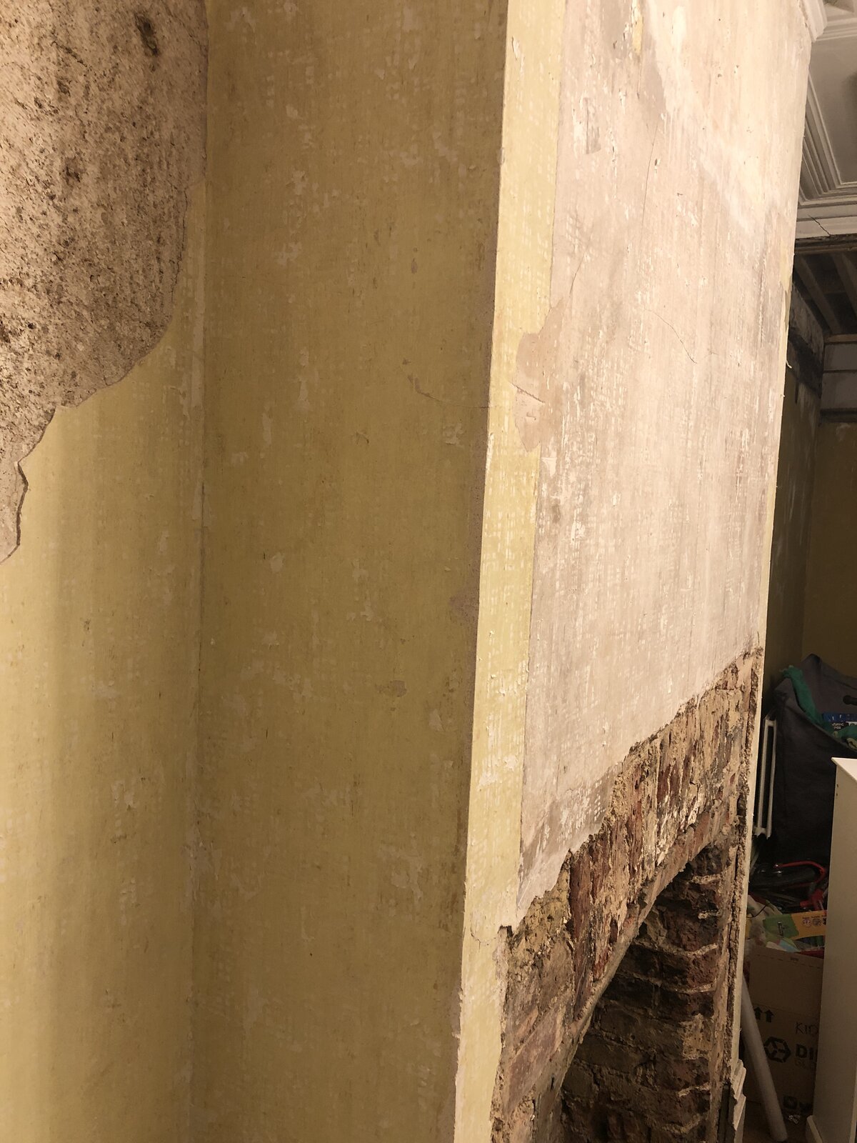

It looks a very shallow recess for a large opening. is the flue brick built all the way or is there a gather and liner. Do you know what similar properties have had done
Its about 12 inches deep, dont know about similar properties on the road but I will investigate. When you say gather do you mean how the chimney narrows just above the opening going up inside the chimney breast?
