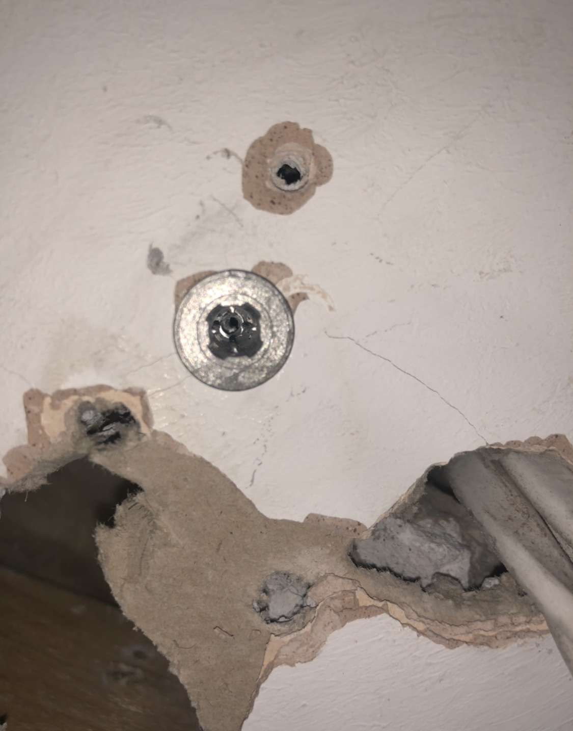

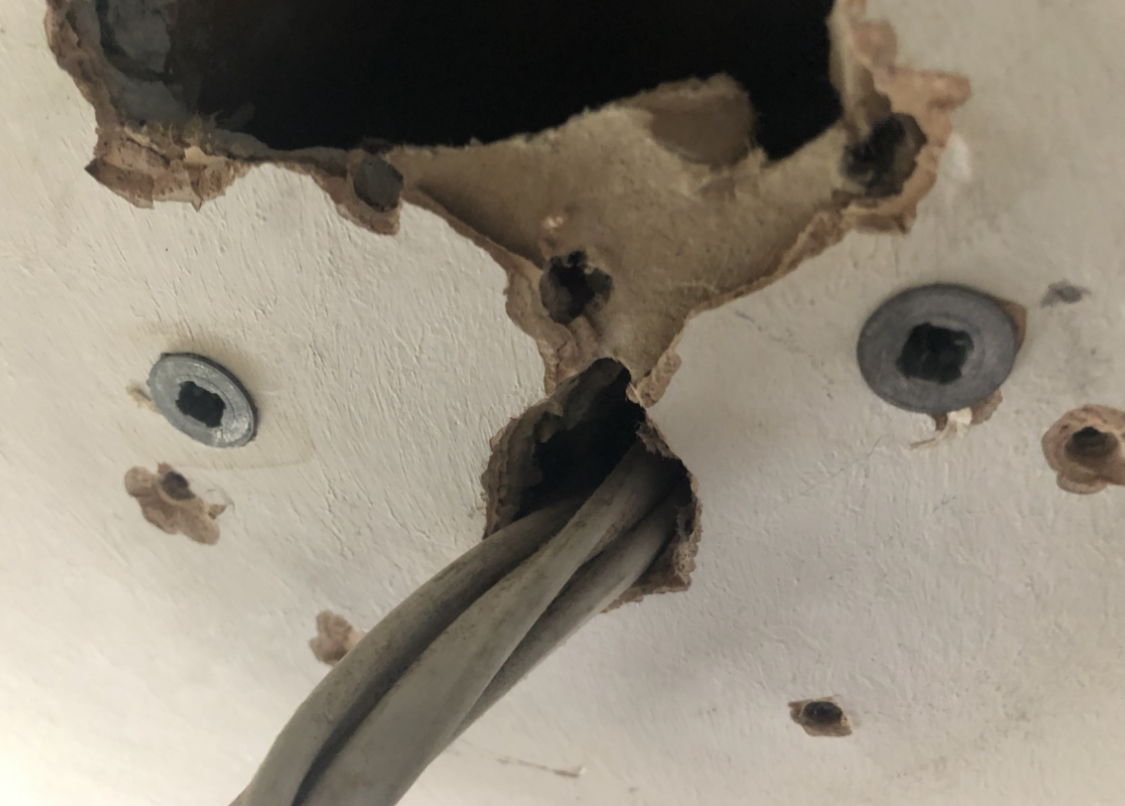

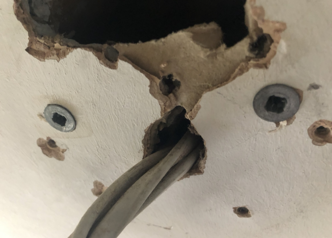

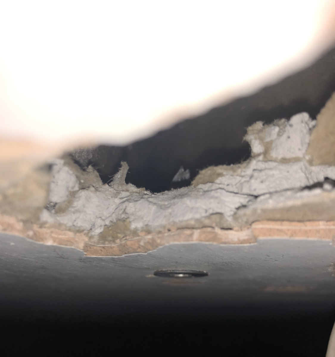

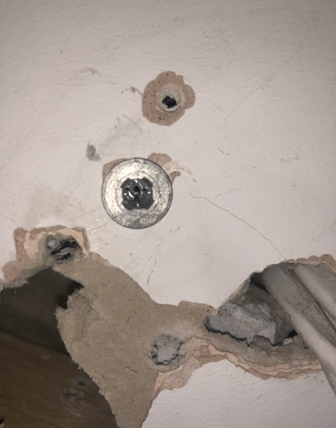

I need to install a ceiling fan that weighs about 4kg but the ceiling is just plasterboard & there is no way to fit to a joist as it’s too far away. There was a fan installed here before & it seems it may have been screwed into these plasterboard self drill fixings as you can see in the pic. Would these be ok to put the new fan up with?

Probably the plasterboard is a bit weakened now with all the holes?

I wouldnt trust ceiling fan on the plasterboard. It's not too tricky to patch and fill...

You need to bite the bullet and remove the ceiling to install proper support between the joists...the vibration from the fan will put to much stress on plasterboard fixings.

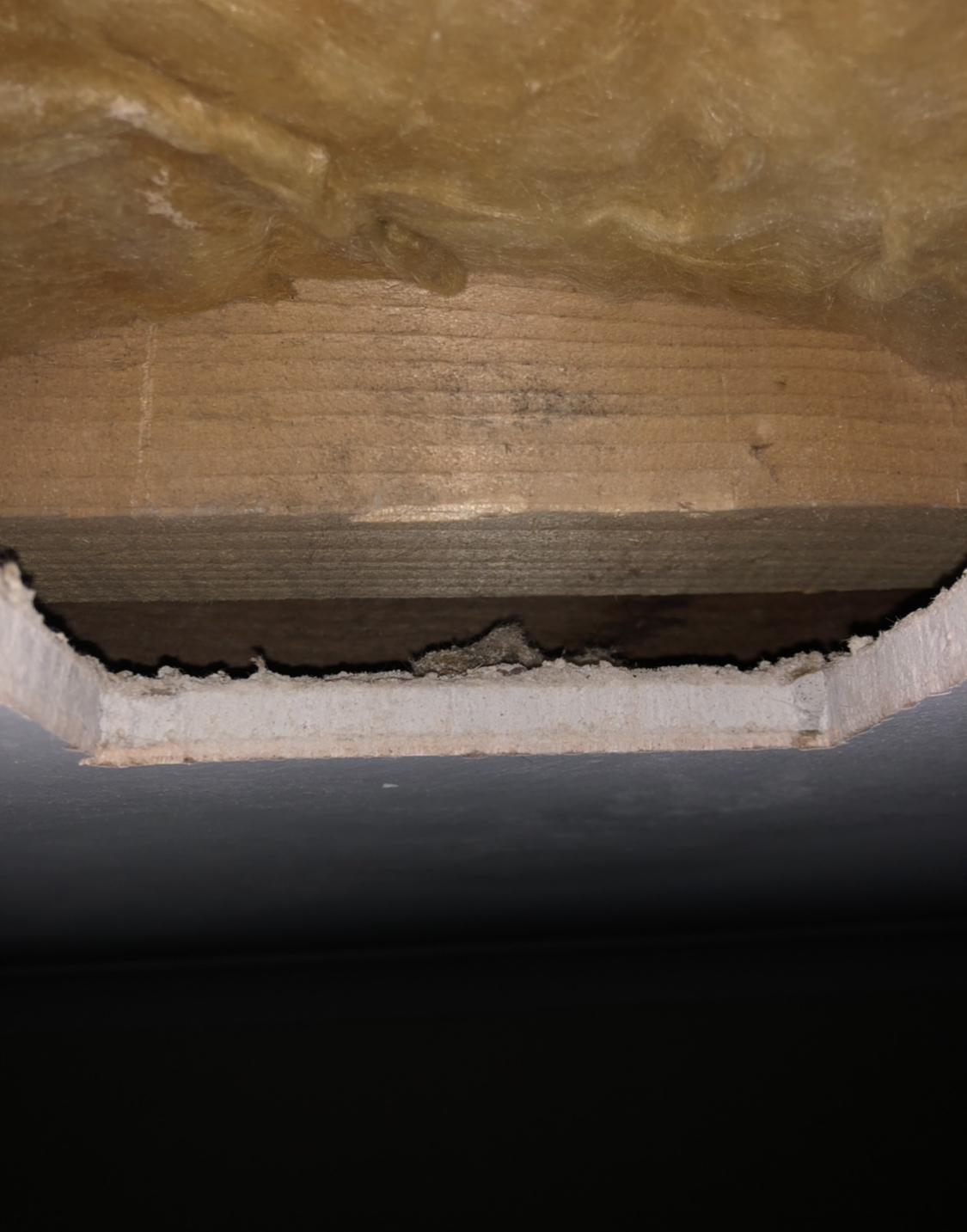

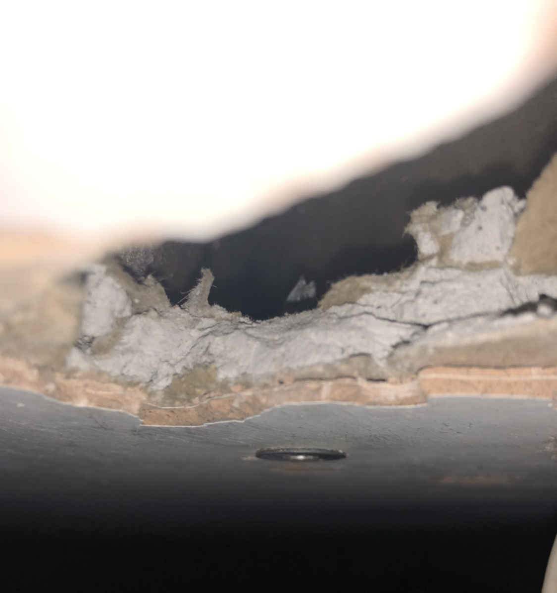

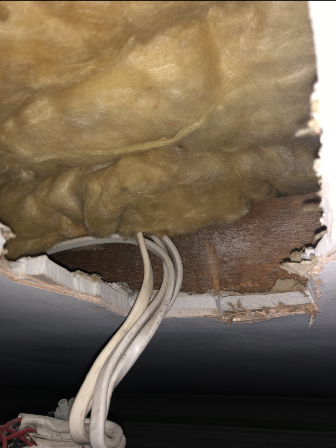

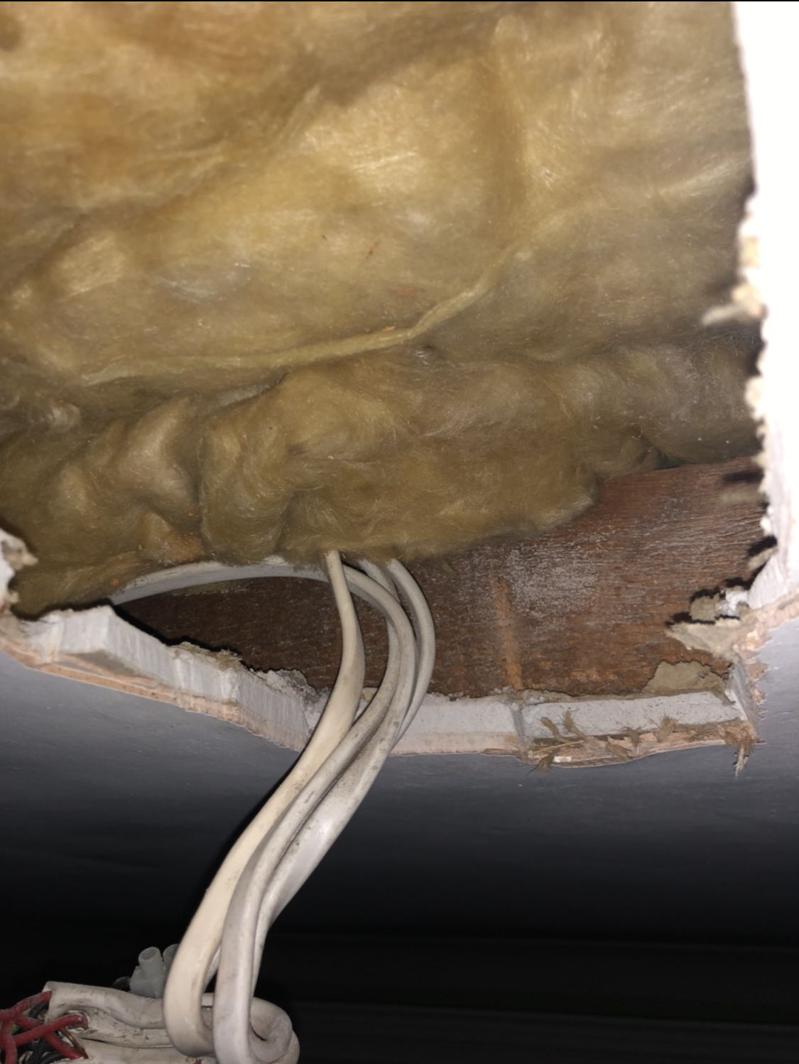

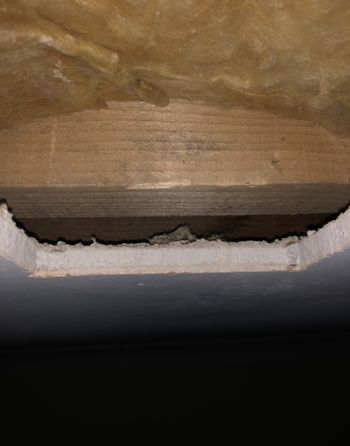

So I’ve cut the ceiling & I’ve got one joist on one side & there’s another on the other side but as you can see there is this piece in front of the other joist that is a little higher that is very solid in there. What would be best to do?
