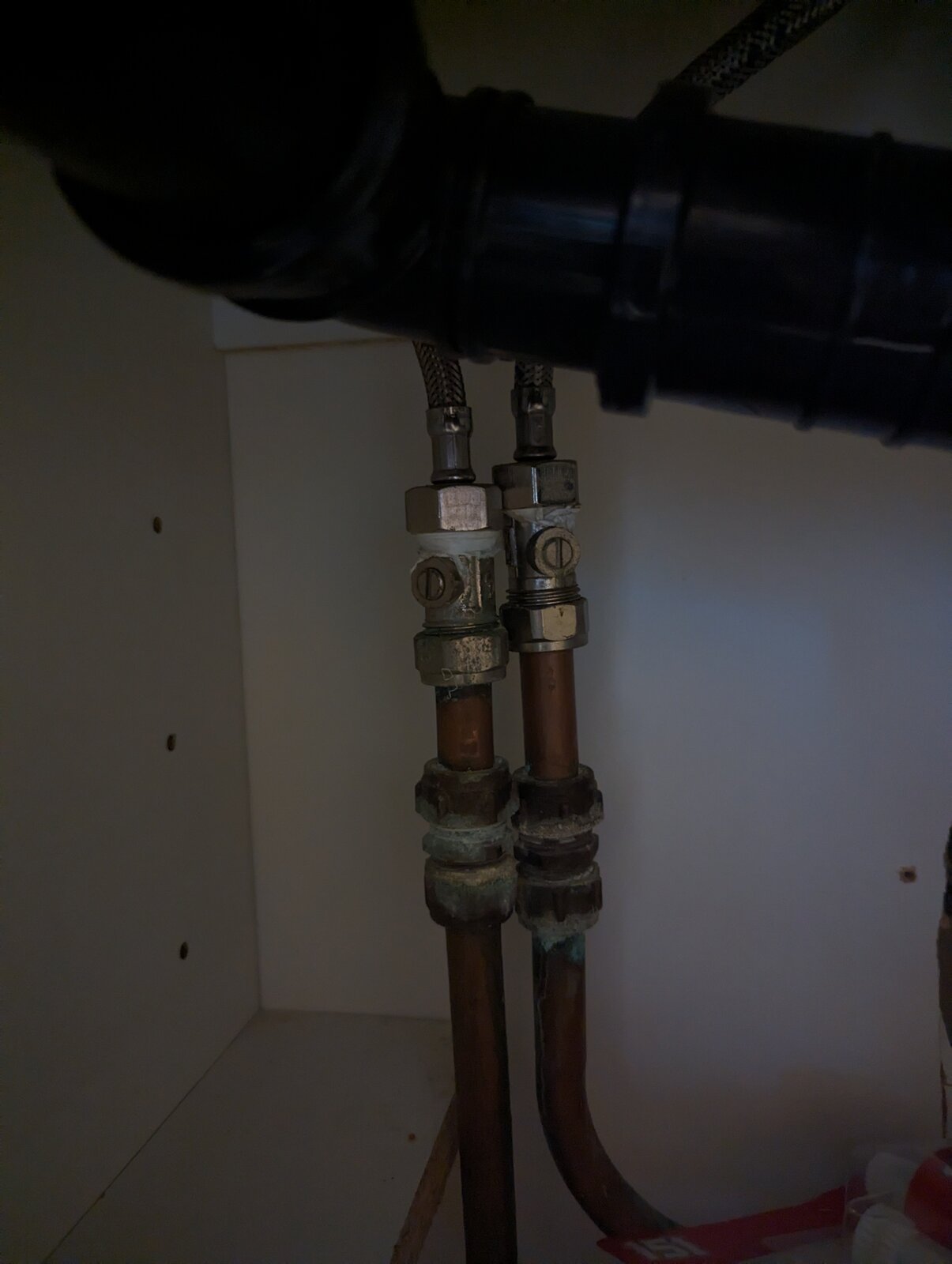

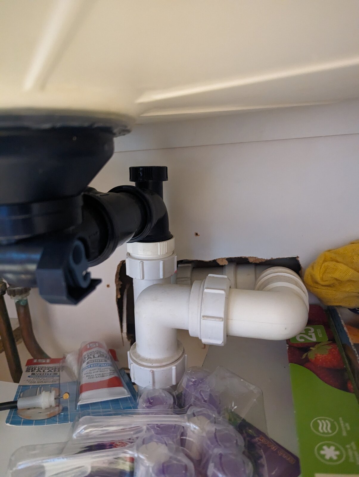

Hi this is my first post here. We've just moved into a house that has not had a dishwasher installed. We've brought one with us I just need a bit of help to make sure I put it in correctly.
I've attached photos of the plumbing already under the sink. Do you think I could add this
https://www.screwfix.com/p/floplast...VWxdyTUx7NHtWQOdo7IaAtQQEALw_wcB&gclsrc=aw.ds to the black connection just under the sink? Or will I need to get one of these and add it just above the u bend? https://www.screwfix.com/p/mcalpine...XfWR2YV81bVGL2WwutUaAn5MEALw_wcB&gclsrc=aw.ds
Also can someone please advise on where to put the connection on the water pipe. I believe it's just a t piece I need. Correct me if I'm wrong.
I would have paid someone to do it but we will be ripping the kitchen out soon so don't want to pay for something that isn't going to be there long. Desperate for a dishwasher in the meantime.

It would be the latter as the former is for fitting into a compression tee.
Trouble you may have is the latter will drop the level of the trap outlet connection for the waste. Would need to see what the waste run behind the trap is like and what that compression connection is and therefore how much of an alteration in height could be made. That may need the waste pipe run modified a bit too.

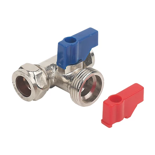

The cold supply would usually be the right hand pipe. So it would be - turn off the cold mains > disconnect the straight coupler top and bottom and remove> put of these in its place. Put a wrap or 2 of PTFE tape around the olives if the nuts and olives are being re-used to avoid weeping connections.
