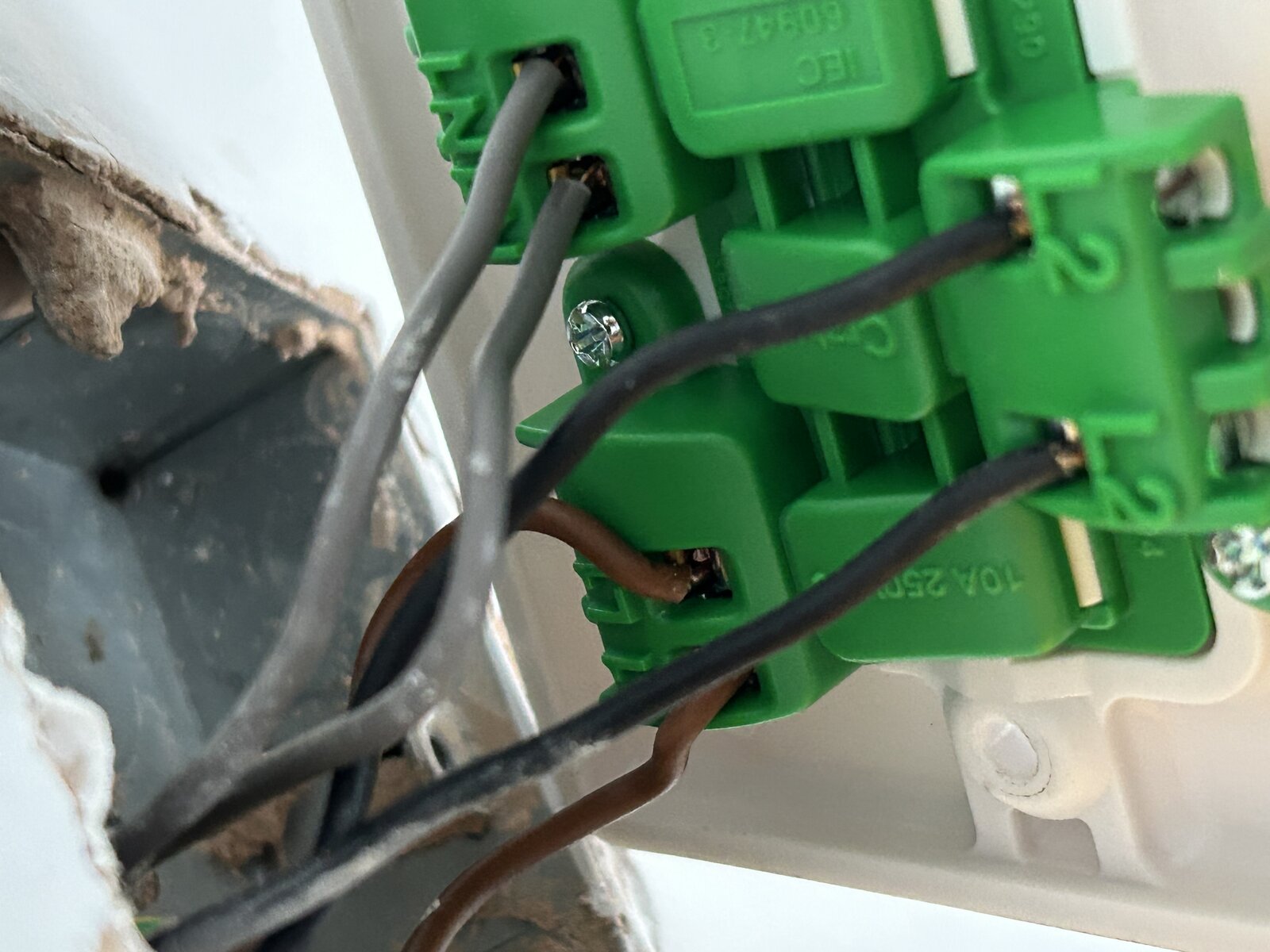

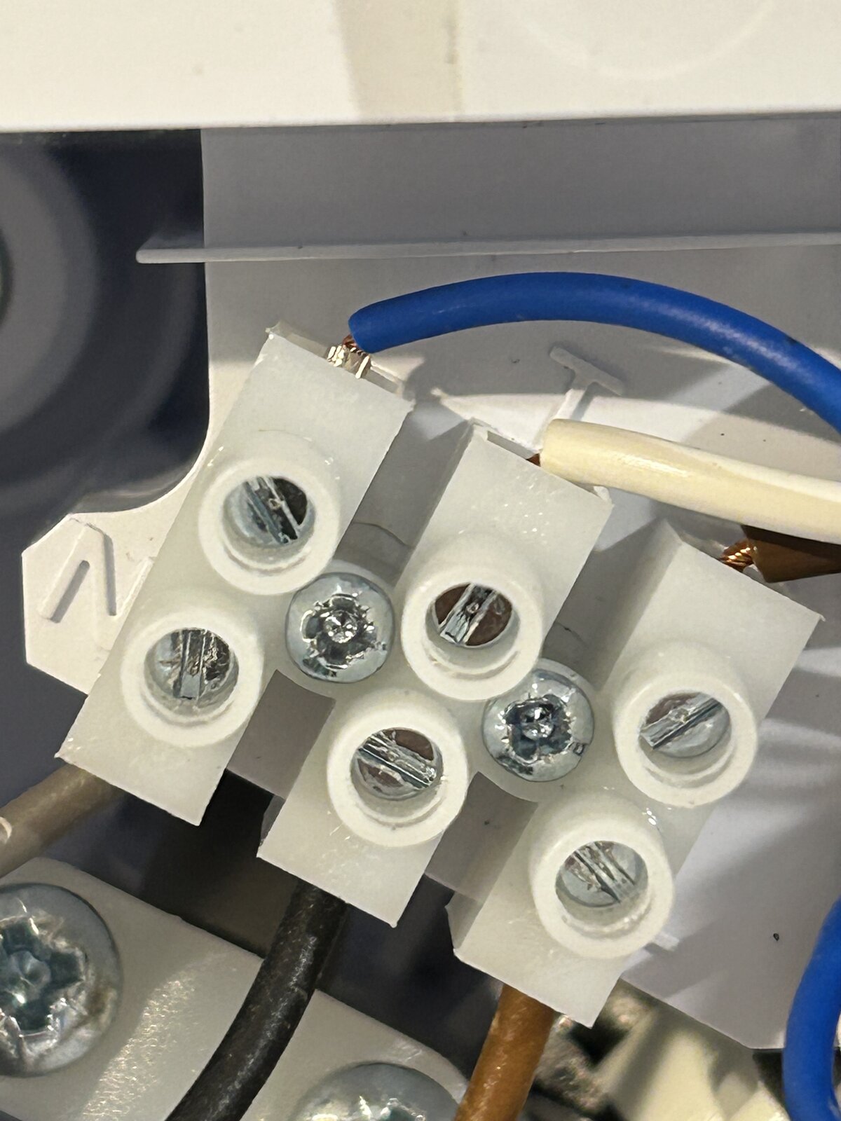

Hi I am installing a fan but the wiring isn’t well documented on the instructions. I have wiring as per photo1 on the isolation switch on the outside but on the fan itself, there is a L, N and T. When I isolate/turn off the switch, no power comes in. When I turn it on, there is power to the black and brown wires. So really doesn’t matter where I wire these to the fan - L or T?
Unless the electrician has wired the switch wrong?
Thanks in advance.
The T connection should be controlled by another switch - usually the light switch..
Does the fan not come on when the light is switched on?.
Hi, it’s a humidistat mainly for the shower so not fussed about it coming on when the light is turned on, want it to come on when the humidity is high.
It would come on with the humidistat even if it were switched by the light switch.
If you don't want it to come on with the light then your thinking about the wiring is correct.

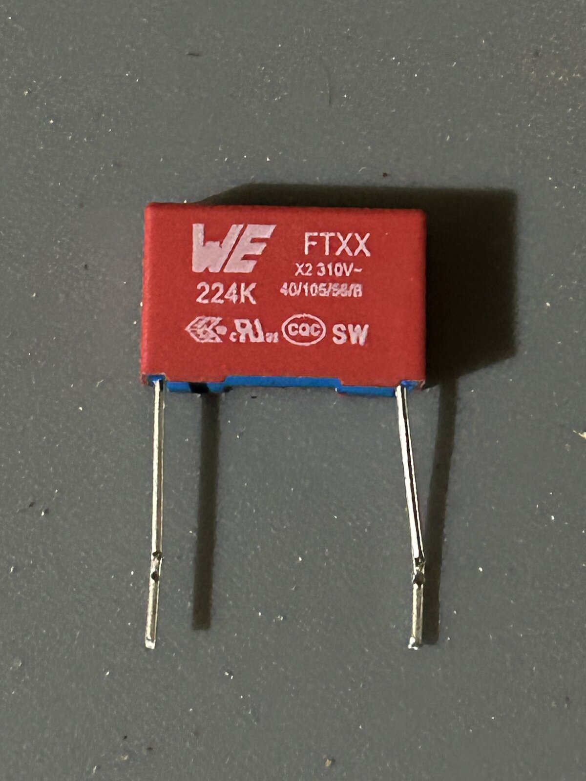

This came in the pack too- not sure if I need this?
