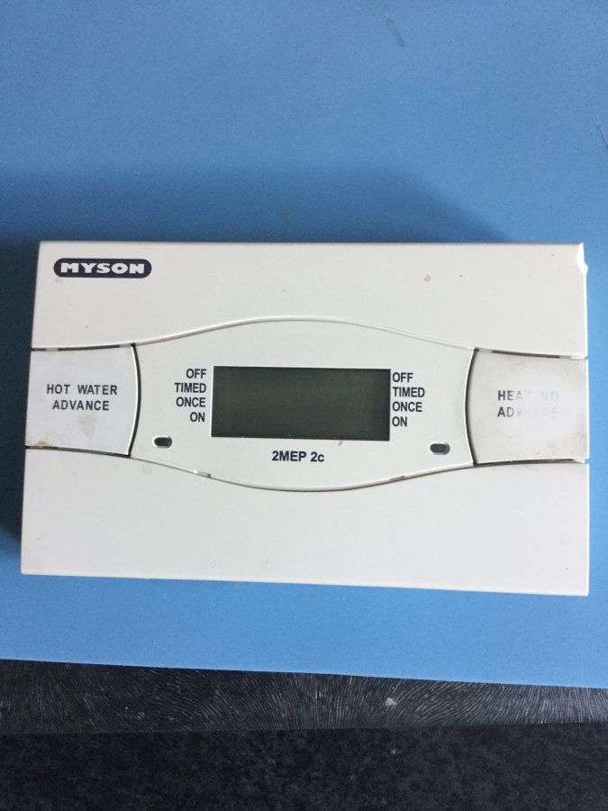

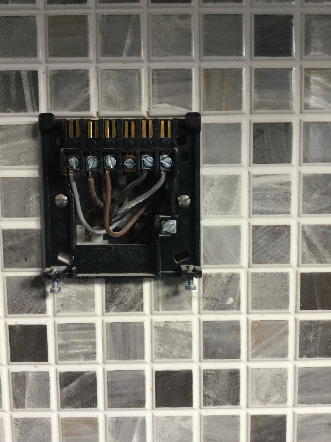

Just after a bit of help with this install.
Current system uses Myson programmer, wired room and cylinder stats and Myson MPE 322 3 port valve. Wiring centre has no labels at all. Cheers installer!
I have the dual channel Hive receiver, just not sure if I need to disconnect one of the wires from the existing programmer back plate.
Also mentioned in the Hive installation is to loop out the redundant (once Hive is installed) room stat. My stat only has two wires going to it, connecting those together or turning the stat to its hottest setting will have the same effect won't it?
Cheers
Hive should go straight on that back plate.
The wired need to be linked for the stat. Preferably in the wiring centre
Cheers Phill, so no need to disconnect wire 1, programmer wiring diagram shows it going to cylinder stat and the 3 port valve
Thanks. Just wanted to make sure it wouldn't interfere with Hive operating.
