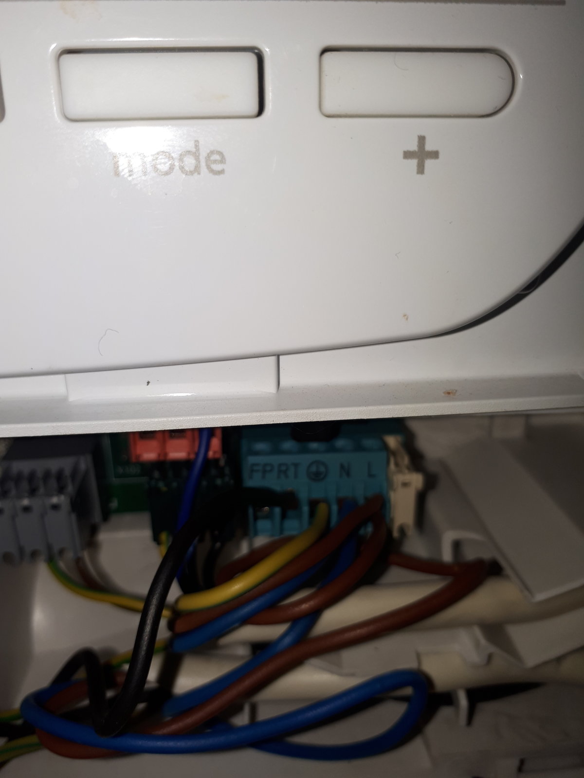

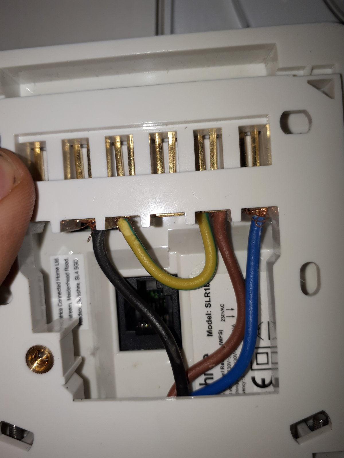

I have followed instructions on here on how to install a hive system onto a flow worm. I think I have everything done but its as if the timer on the boiler is overriding the hive.
My current setup is as follows.
followed instructions on sticking a loop in L and "1".
Then stuck:
L in L
N in N
Black in RT

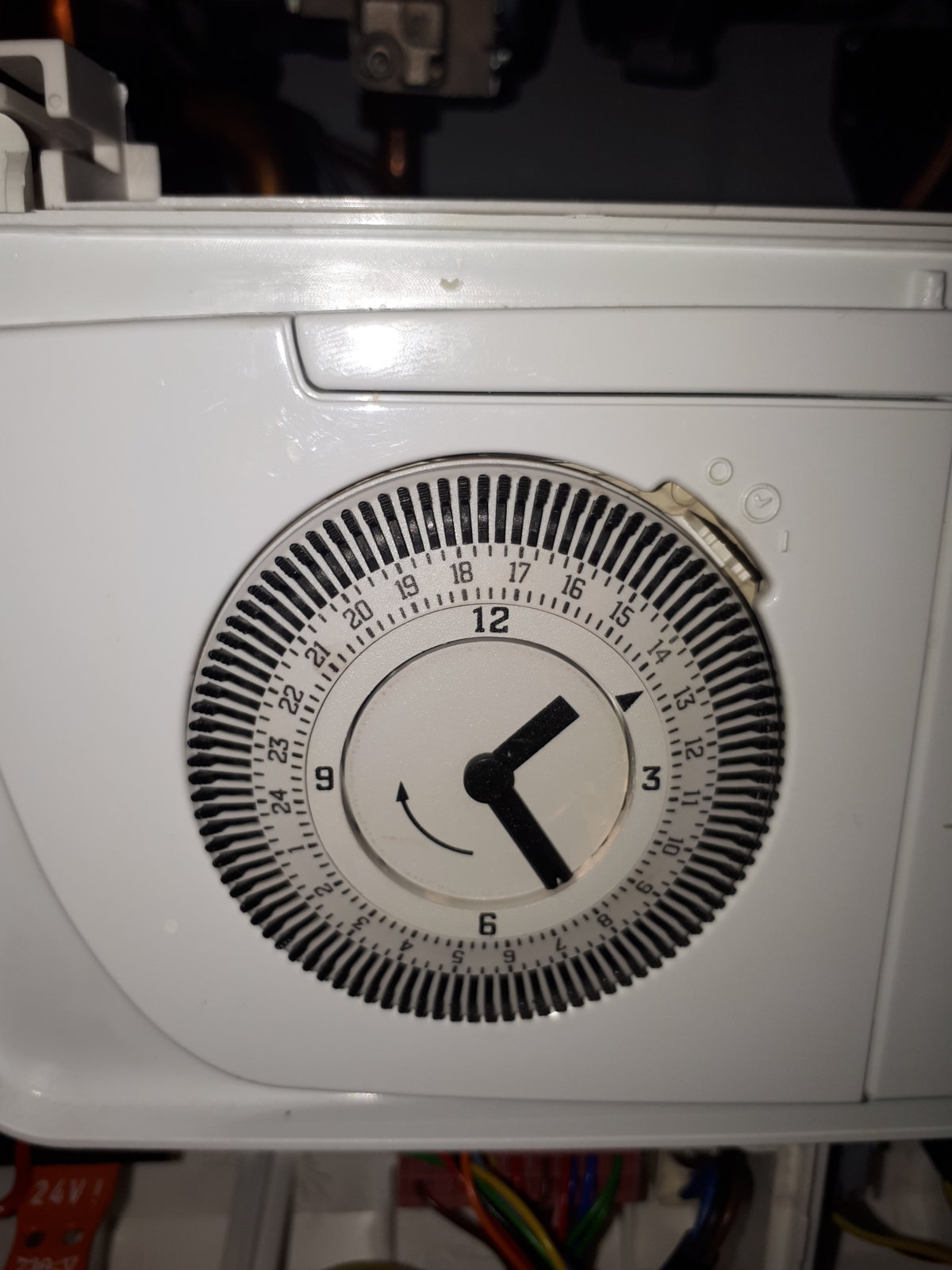

stick the timer on and fire all the black switches into perm on.
turn the power on and the receiver lights up and connects but if a turn heating off on the five the boiler continues to go even though the receiver goes "click" as if it has taken the command but does nothing with it.
I did read that taking the connector in the x17 stops the override of the timer with the boiler but when trying this it just went the boiler didn't work at all - even sticking boiler into on rather than timer.
any ideas what I am missing here?!?
