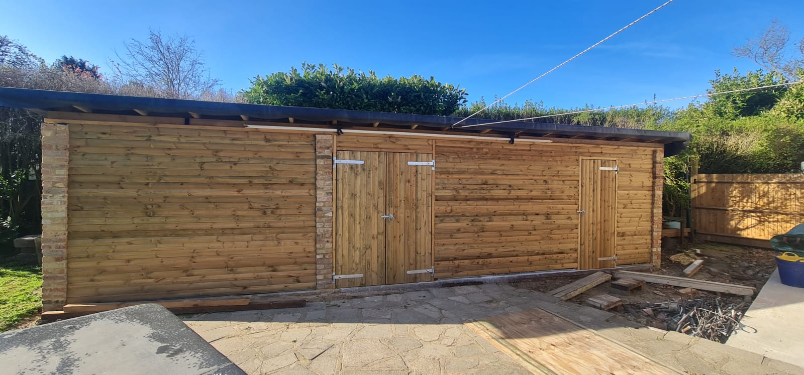

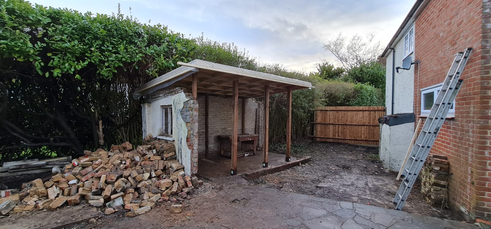

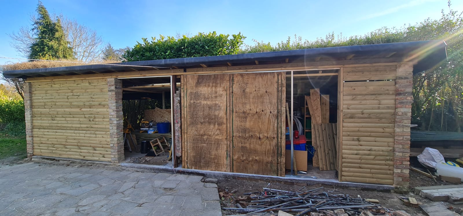

Hi All,
I have an outbuilding that I've built and now want to improve the inside. I appreciate that I may have done this a little back to front
These are some of the photos from the build. It's a mixture of brick wall, brick pillars, a timber "ring beam" and a noggined 4x2 roof at ~600 centres. The cladding is 28mm loglap attached directly to 50mm steel framing
Walls
I was wondering how I could effectively insulate the structure. I was thinking of using 50mm PIR (or batts) between the steel and finishing the inside with plywood. Do I need a waterproof layer to stop condensation? It's not a live-in structure, just for use as a workshop. I mainly want to stop tools going rusty
My plan is loglap - insulation - plywood but if I do need a waterproof layer, does it matter where it goes

Ideally you would have plywood + vapour barrier + insulation (stud layer) + breathable membrane + vertical battens + horizontal battens + cladding.
Thanks for the reply. Short of taking the whole thing apart (that I could do as it was built to be demountable for the planners) what is the practical downside of?
The cladding is tongue and groove so gives a fair amount of structural rigidity as well (the middle picture was partial - the steel is at ~450 centres
