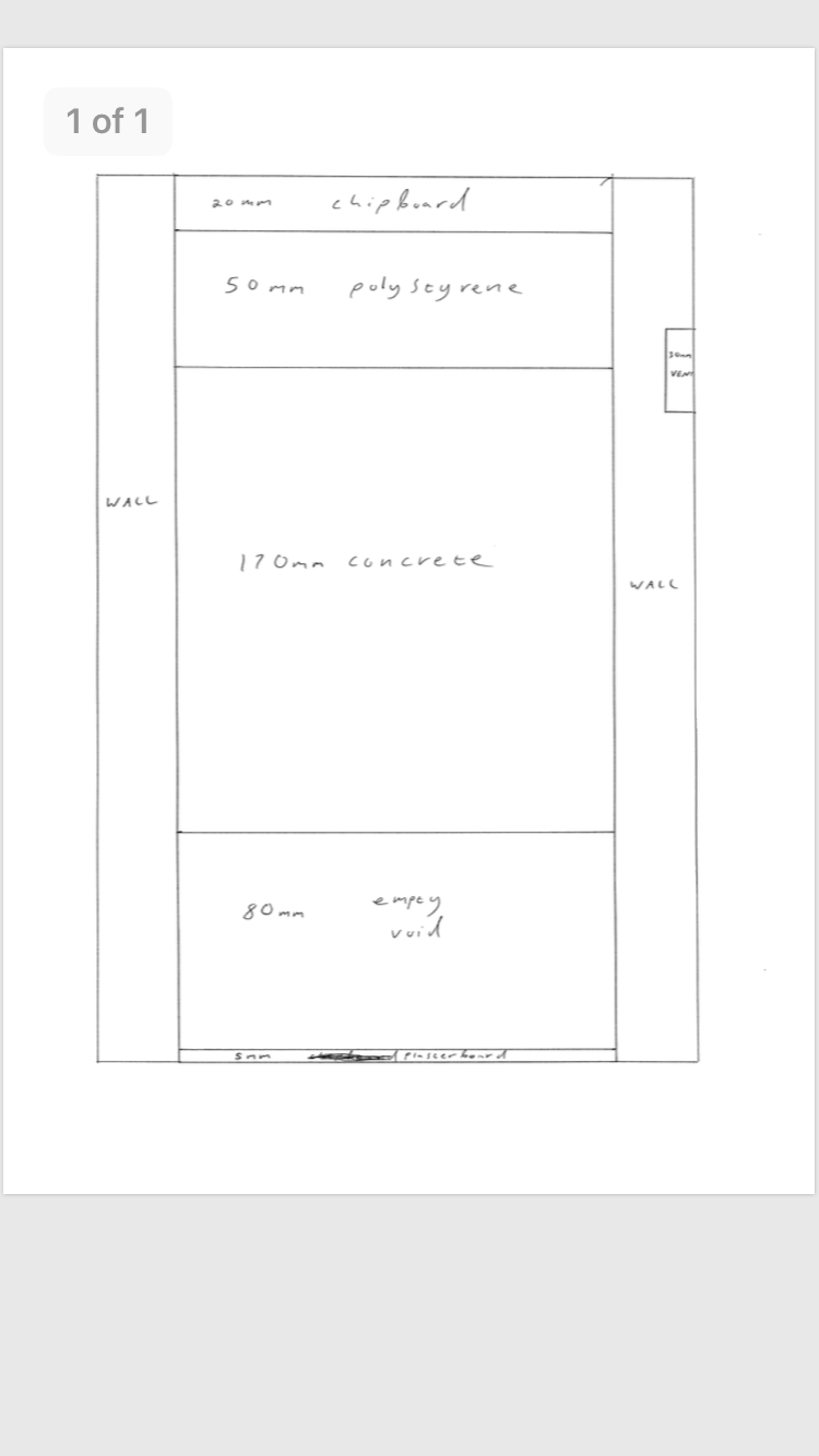

So flooring is
20mm chipboard
50mm polystyrene (in line with vents)
Concreate
80mm Void
5mm plasterboard?
Carport

Replacing the polystyrene with kooltherm will make a difference but you might want more. Filling the 80mm void is the next option. You could use mineral wool there (there are fire safety issues), but is the void needed for some reason? I don't know. Anyway insulating there, if the void is continuous below the bottoms of your internal walls, will make those walls warmer too; this will be significant if they are solid walls though not so much if they are studwork.

Management company probably don't have authority to grant you permission, unless the landlord and management company are one and the same? Assuming for a moment that someone forgot to insulate the concrete and all you have is 50mm of poly.. then U-value estimate is something between 0.5 and 0.7 depending on the other bits. If you put 80mm (e.g. 100mm rolls) of rockwool in the void, then you should get that down to something closer to 0.3. It wasn't that long ago that this was considered good.
IMO its not worth spending a lot on:
- you can't easily insulate the side of the underside, so its never going to be perfect.
- better insulation will be harder to fit and have fire issues
- addressing the fire issues with a combustible material will be expensive.
- lowering the U-value below 0.3 probably wont get you a payback

Diagram just to make it a bit clearer. Although plasterboard is aparently not plasterboard
