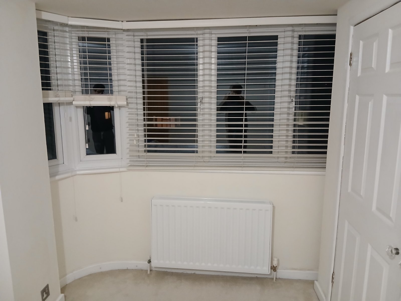

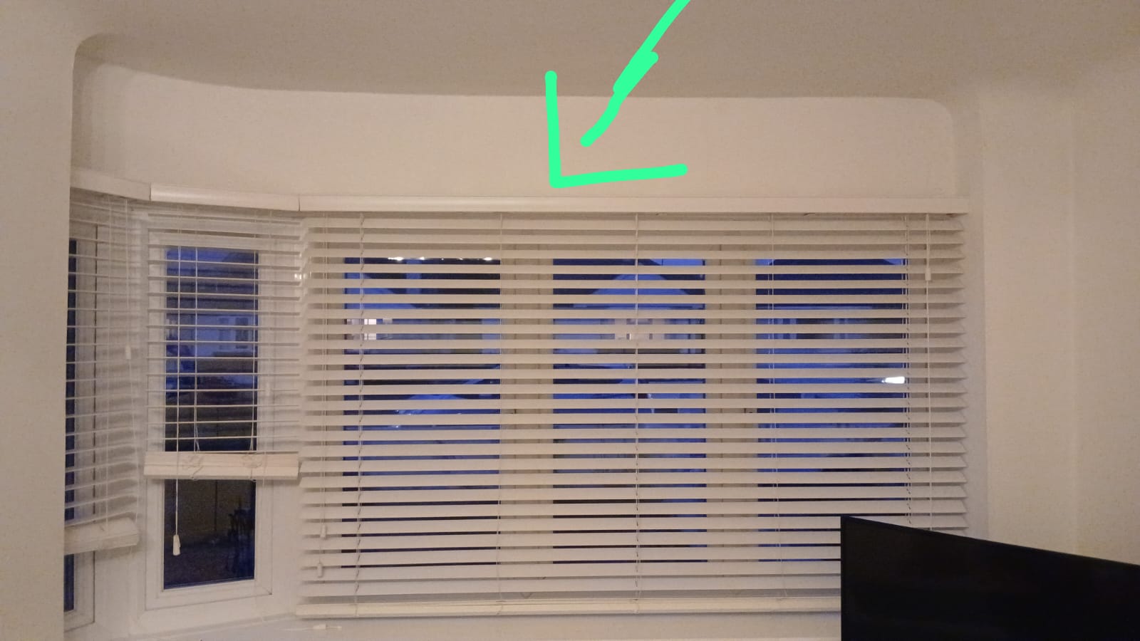

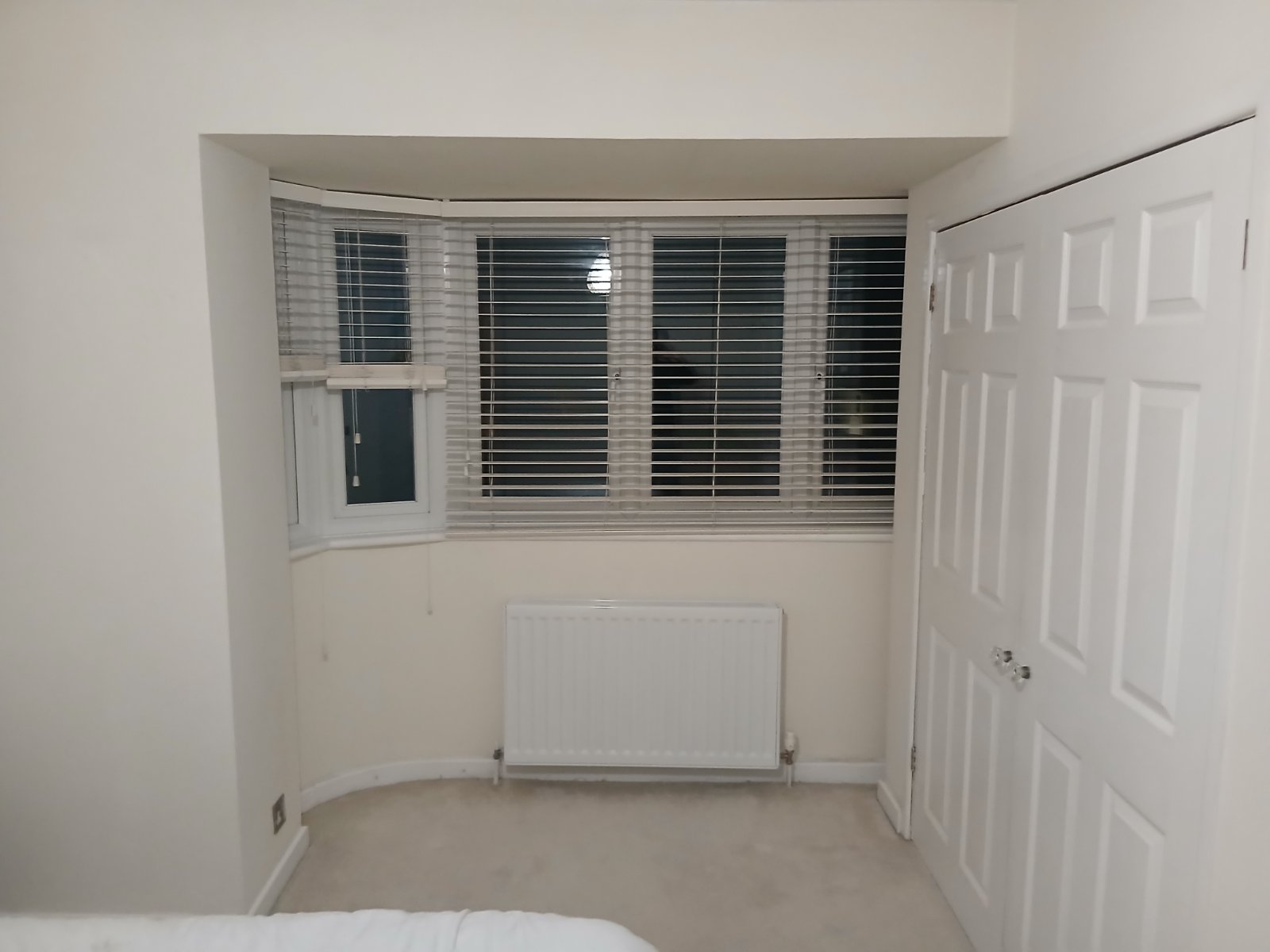

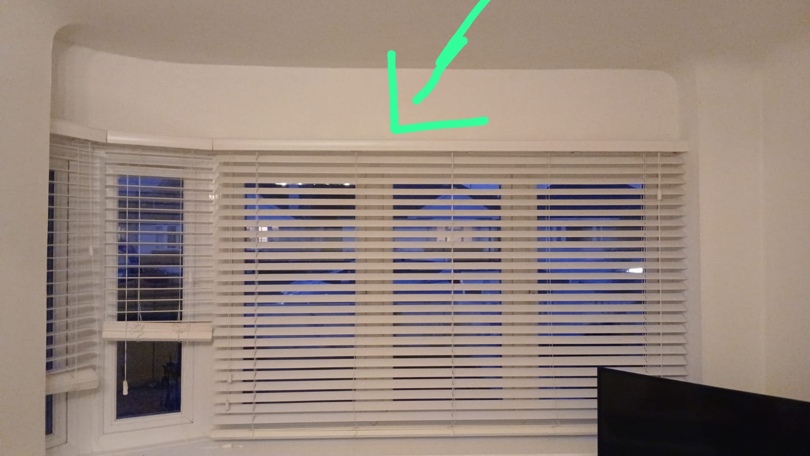

I would like to insulate the wooden frame bay on the 1st floor of my house which sits above double glazed windows on the ground floor (green arrow)
I have looked at options used on previous posts about this and most suggest using celotex but I have a few concerns about this:
1) Risk of an incomplete vapour barrier causing condensation. The curved nature of the bay increases the risk of gaps and therefore condensation. I also don't want to reveal the full length of the timber frame due to extent of work and disruption, instead pushing celotex from top into studs below floor boards and into bottom of frame above ground floor windows. But this means I cannot put a vapour barrier at the base or fill gaps with filing foam hence my concern about condensation.
2) It will be more tricky to fit celotex in curved section although not impossible. Also harder to fit curved plasterboard over the top although again I know you can bend plaster board.

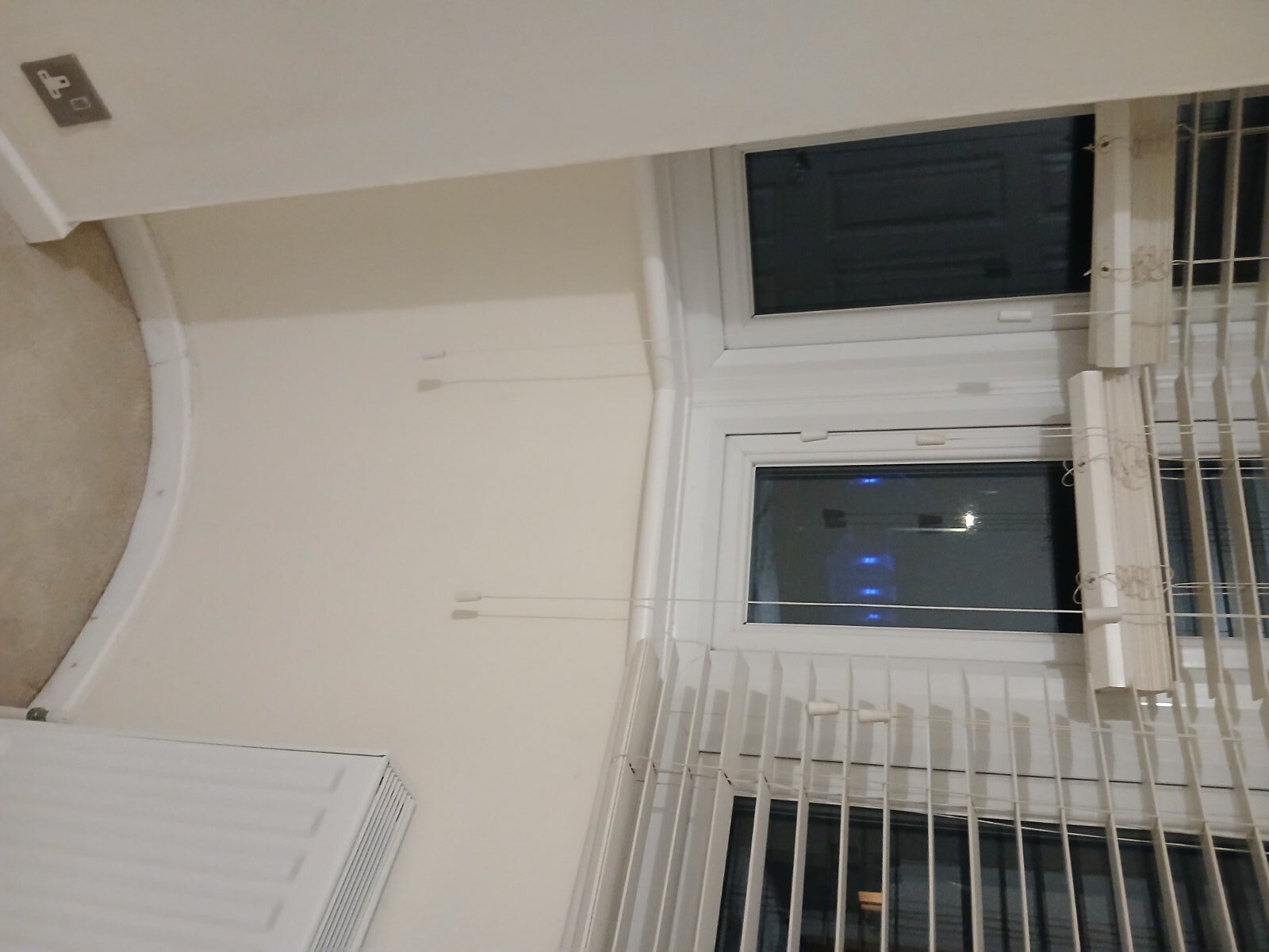

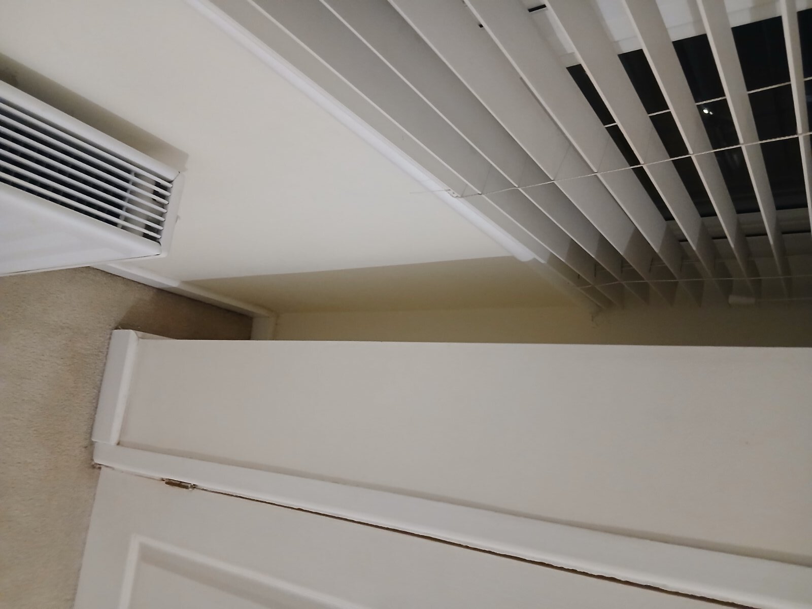

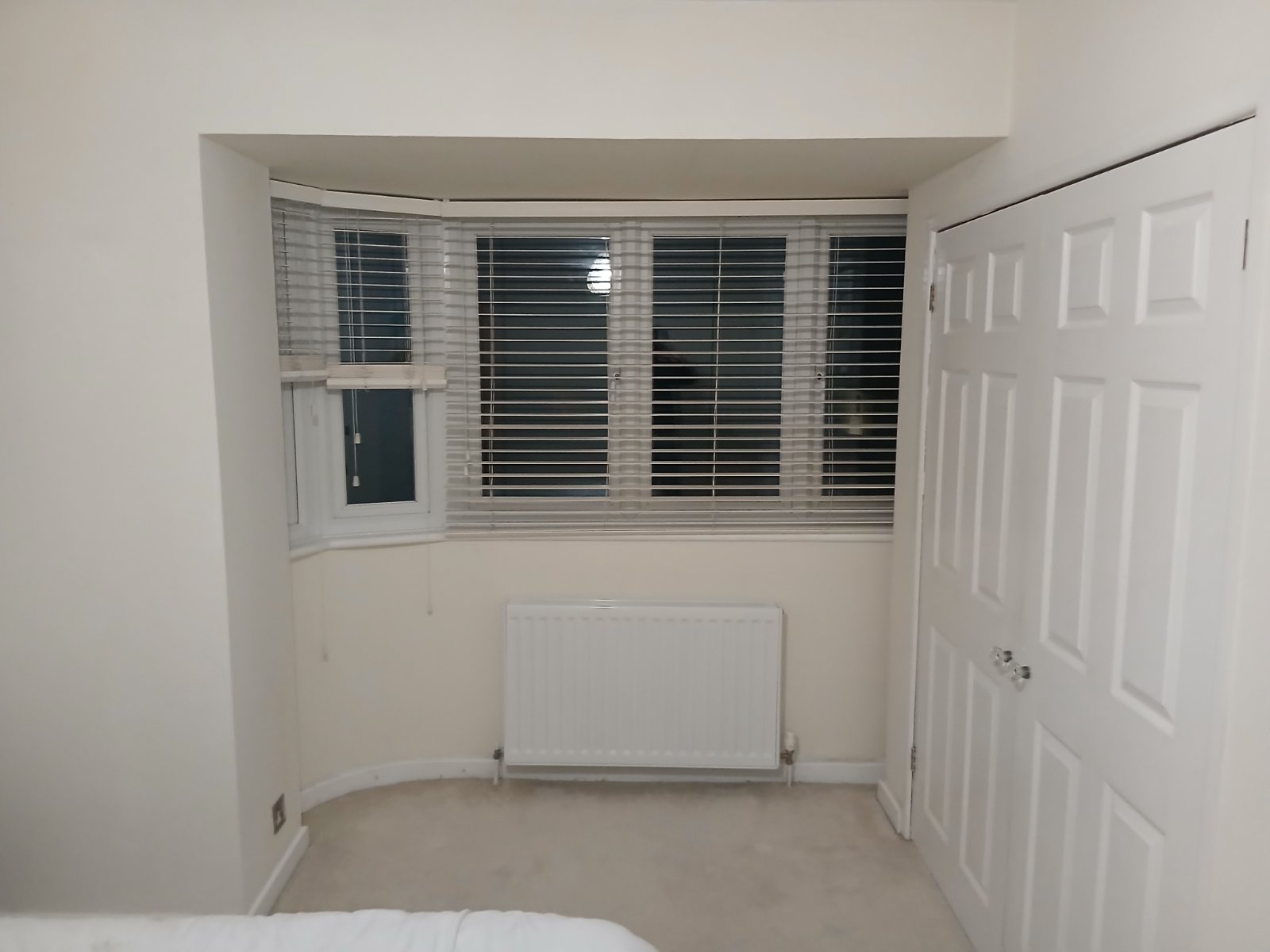

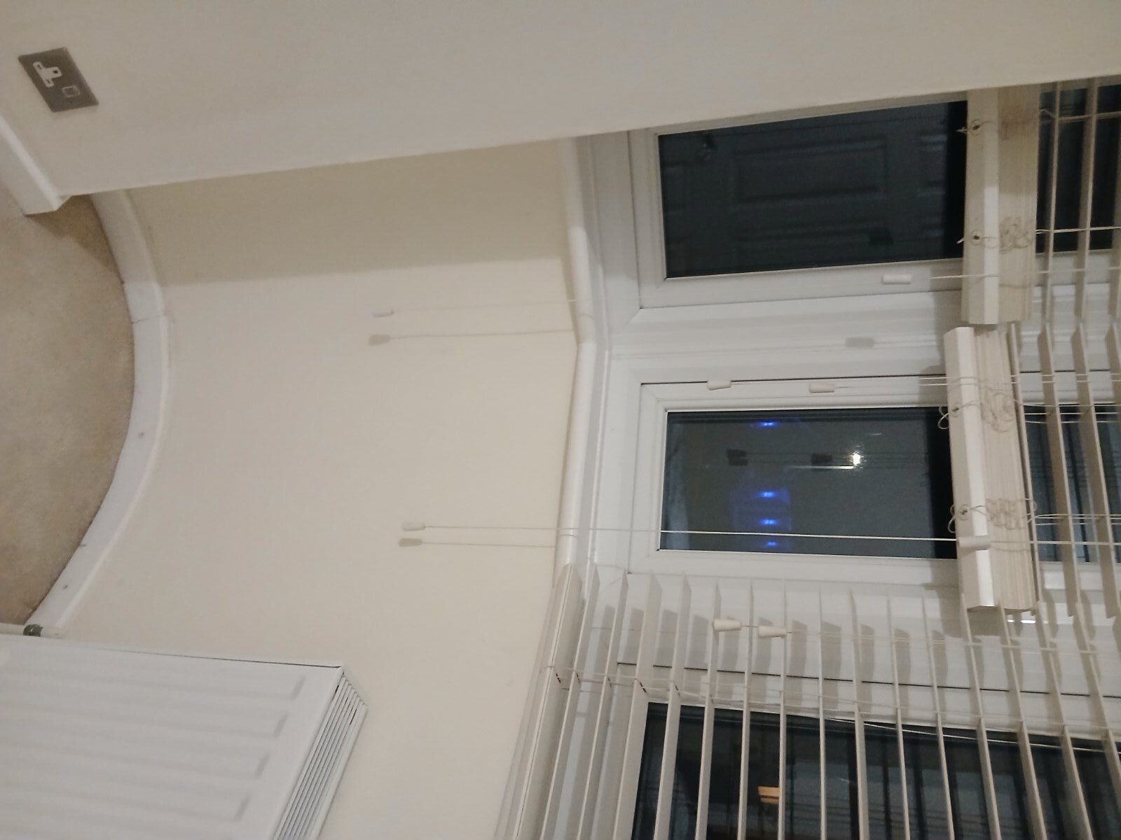

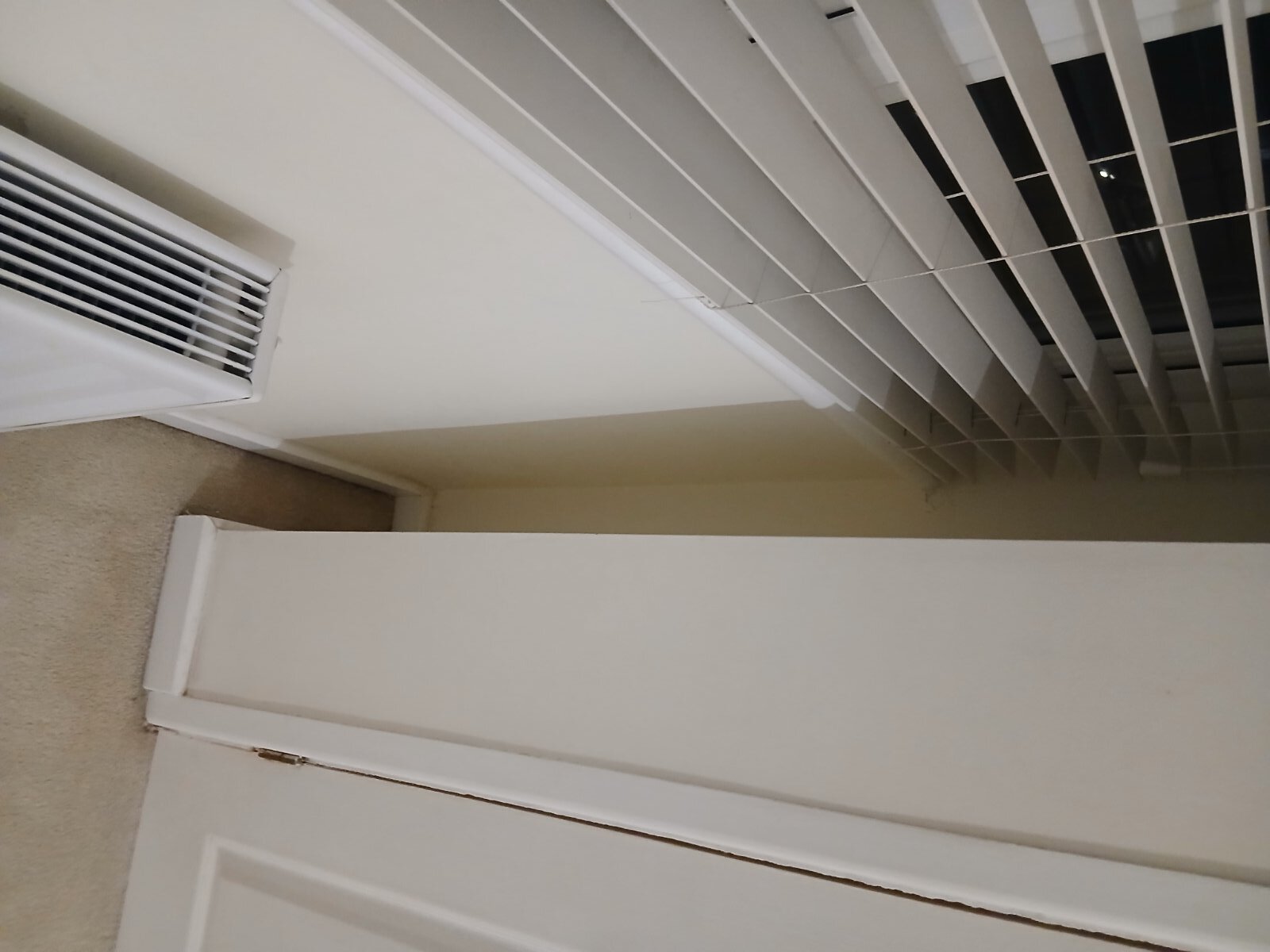

3) There is a corner at one end adjacent to a wardrobe which will make access for that part more difficult (see images).
I have recently insulated the ceiling so am waiting to see the effect this has on warmth and condensation. It could be that having insulated the ceiling that that is enough but if not, I wonder what people's thoughts are for using celotex or perhaps suggest another insulation. A friend suggested vermiculite as it would be easier to install given curve and also less prone to condensation but I am concerned about thermal performance. It would however be a much simpler method and would maintain the current curve.
Thanks and suggestion and thoughts very welcome. I am happy to consider all types of insulation vs ease of installation vs thermal performance. Cost not an issue

1) from your description, sounds like you will struggle to achieve full coverage and may end up with cold spots.
2) you can score the back of the boards to make it 'bend' into the space. Not ideal as you will have cold spots where the cuts are.
3) Close that gap off, fill it with insulation, cap it off with a bit of painted MDF/window board.
The ceiling having been insulated will probably increase the likelihood of condensation on the wall section.
You might find that theres already something in there, might just be 2" of sagging fibreglass insulation or something equally retro.
The fact that it's curved, means that wool slabs will be the easiest to install.
Something like Dritherm 32 in the void, go over it with a thin insulated plasterboard to cover the studs.
Don't not cover the studs unless you like zebra's.

Thank you. I have added pictures of the bay roof before and after adding attic insulation which in itself seems to be making a difference. I'll add a picture of the bay front this morning.

Thank you ok yes this makes sense and a better option then celotex due to less risk of cold bridging. What about vermiculite? That would be easier to install as I wouldn't have to rip out the current plaster board completely.
Vermiculite is a poor insulator compared to modern materials. It also absorbs moisture, which may not be ideal in this case.
If you want something that you can pour in, consider polystyrene beads.
Beware that poured-in insulation tends to find its way out of the bottom of the space you're filling and under the floor, into the room below, etc. There are systems where you add a binder as you pour and it sets in place. I don’t know if that is DIYable.
You also need to take care if there are electrical cables in the vicinity. Polystyrene can react with PVC cables.
Thank you. It seems like some sort of flexible wool based insulation would be best. I know there are many types. Do people recommend fibre glass type or natural forms such as sheep's wool or does it not matter?
Things to consider: price, ease of handling (“traditional” fibreglass is unpleasant, but some modern products are softer), acoustic properties (would you appreciate more sound-proofing here?), local availability.

FWIW: you have a semi-cant bay. google "cant bricks" to see what cant means?
Paster board at the cant end will be fixed at 16" centres in individual pieces over the spaces between each stud.
Rigid or soft insulation will work - make sure to fill the full space between studs.

Use two layers of foil sandwich PIR (one between studs one across) plenty of foil tape, plenty of foam or sealant for bigger gaps and use Duplex plasterboards. You'll have robust VC right there.
Thanks. So it seems like PIR might be best. In terms of the curved/canted section would it be best to use cut pieces of PIR like celotex or a board that is designed to bend like Jackoboard? Also will duplex plasterboard bend to a curve? The radius is about 50cm. Many thanks for all comments. Think I am getting a clearer idea now
