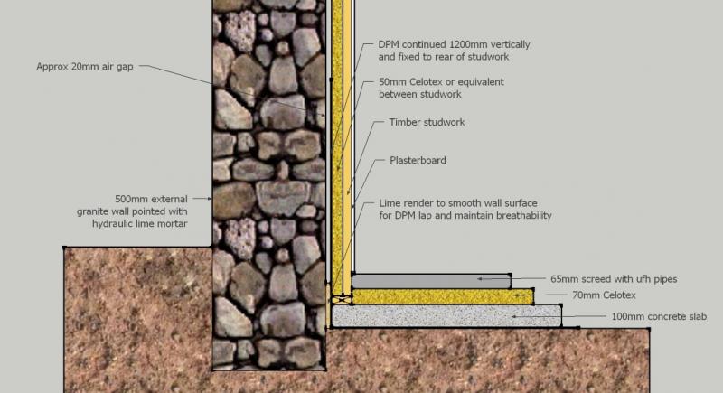

    The main issue I'm having difficulty resolving is how to best insulate the exterior walls whilst maintaining breathability and preventing moisture problems. After much deliberation over the past twelve months or so (!) I've drawn a basic cross section of the approach I would like to adopt. (See below)
    I have discussed this approach with the local building control officer who was happy with the specification but concerned that moisture might get trapped between the DPM and insulation. Current regulations obviously aren't that helpful when it comes to trying to merge the old and the new, so I would very much appreciate any thoughts or advice that any of you may have.

    Well if you have been following this forum for a year , then regrettably I have to say you haven't been paying much attention.
    In every thread about insulation, the phrase "vapour barrier on the warm side of the insulation" is likely to appear. You however have put yours so the on the cold side so the BCO is completely correct. What did you dad have to say about this ?

    "I'm fully aware of where to place the vapour barrier with regard to interstitial condensation. "
    So why then does your drawing - which is presumably intended to give us an accurate representation of your intentions - show it on the wrong side of the insulation ?
    Edit:
    Having looked again at your drawing , I wonder if in fact it is your intention that the Celotex acts as your vapour barrier ? If nicely butted and taped ( can you get T+G in 50 mm ?) that would be fine. As far as the DPM on the outside goes, it seems to be generally accepted ( I'm just repeating here as I am not entirely certain ) that it is not a good idea to sandwich the insulation between two impermeable layers ( although that would be much more relevant with fibre-wool insulation.)
    Since, however, the Celotex is waterproof ( I am not bothered about the last 0.01% permeability here ) I don't see any benefit in putting the DPM there, so would suggest you don't bother.

    It is indeed my intention that the Celotex acts as a vapour barrier. I should have clarified this.
    The principle of running the DPM up behind the studwork is to prevent potential moisture penetration at the point where the studwork meets the slab. (I've circled this detail in the image below). As mentioned, the walls are constructed with lime mortar and so I have to assume that water ingress may pose problems. Running the DPM as high as 1200mm, however, is probably wrong. I was simply considering potential rising damp levels.
    With regard to insulation thickness, I could probably stretch to 65mm. The studwork timbers will be 89mm, the idea being to leave space in front for wiring. (The idea of cutting into this extortionately expense stuff makes me feel somewhat nauseous!) I can't afford to lose any more floor space.

    With the walls as you describe, it may be a good idea to have the DPM. Obviously you will want to have treated battens to resist possible damp: have you considered using metal-channeling ? This would be water resistant and has holes in the uprights to allow easy passage of wiring.

    Mointainwalker; I hadn't considered metal channeling. It would be a great solution in this case, although we simply can't afford the quantities we would need.
    The original lime mortar joints are in a bad state of repair so yes, the whole building will need repointing with hydraulic lime. (This is also to satisfy the conservation officer as well as breathability).
    Simply as an extra preventory measure, do you think running the DPM up 1200mm or so to protect the (treated) timber is necessary? There will be an air gap between the stud and stone walls.

    Don't know UK costs for metal but not much more than wooden battens here and only 45 mm deep.
    Is your 20 mm gap the same all the way up ? I would expect the wall to taper towards the top thus increasing the gap. I would probably go with membrane for peace of mind since cost is not too great ( remember I don't know your financial circumstances ). You could always use the Celotex as a barrier on this side too and just take a short width of your DPM from "wet" side, under the Celotex and lap it up the inner side to prevent any seepage into floor/battens.
