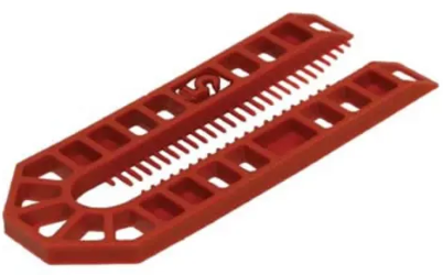

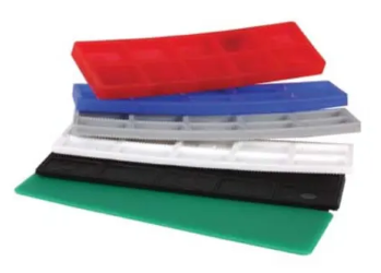

Yes. Precisely that. Using either glazing packers or horseshoe packers:
But against using a low expansion foam it is a LOT of work and the advent of low expansion foams has made the technique almost obsolete
