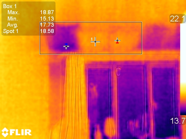

All my upstairs rooms have sloping edges, or vaulted edges if that is the right term, checked with a FLIR and the edges are cold.
Checking the loft there is no insulation at all on the slopes, just single plasterboard. I've got enough room to get in a 50mm PIR board and leave 20mm clear above it for ventilation.
Armed with some 50mm board, saw and solvent-free grip filler, decided to try a couple, nightmare to get right into the corner. Due to the way the joists are bolted to the rafters the board has to be fitted in 2 pieces, first bit slid down then across behind the end of the joist etc
Is there an easier way to do this?
Certainly looks better on the FLIR but took all evening just to do 3 rafters (2 in pic below) and got about 60 to do :(

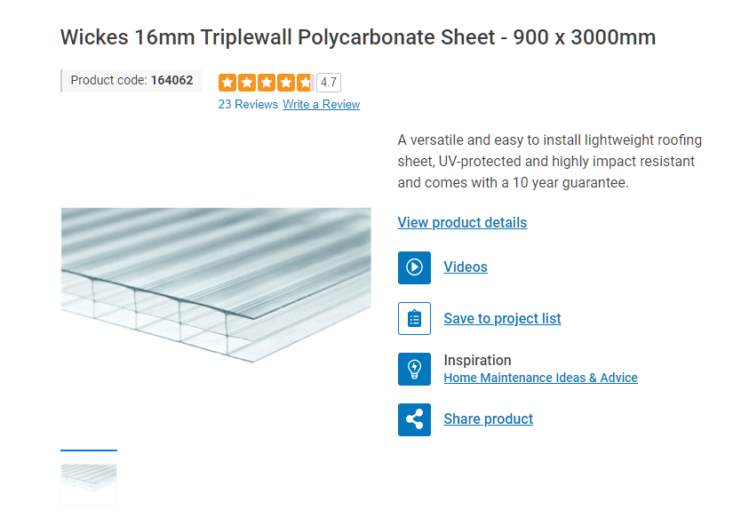

I just had another idea, how about rockwool with hollow polycarbonite sheet wedged between the rockwool and the sarking, I found some 16mm sheet on Wickes that looks like it would let the air through above the rockwool?
Yes, and that needs to come off or insulated over then reboarded.
I see what you mean but I might have to just put up with the end of the rafters being a cold bridge for now.
What do you think of my idea of using rockwool with hollow polycarbonate sheet wedged above it, I've found they do 10mm one as well, thinking I could use 100mm rockwool with 10mm hollow sheet wedged on top, would compress the rockwool a bit but should fluff into the gaps?
Trying to do the best I can without ripping too much apart and it not taking me forever to get some improvement...
The problem with Rockwool or any quilt in that location is that it will be subject to cold air movement not just above, but within it, so it may not perform very well, or as well as expected.
If you used cavity slabs as mentioned by cbde above, then that would be easier and no need for polycarbonate.
