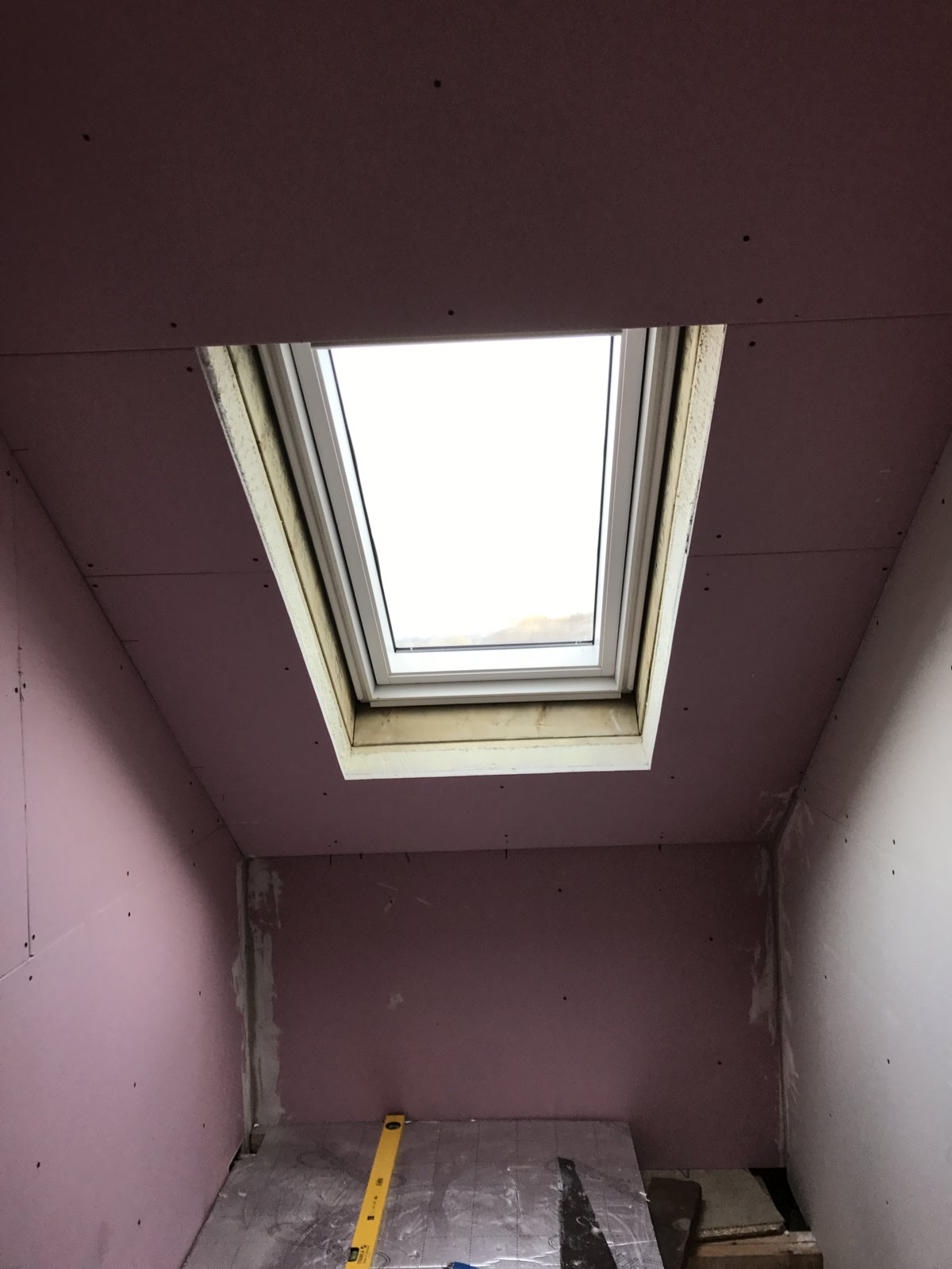

Insulation around a Velux?
14 Sep 2010
7,056
902
Rochdale
Should I use foam around the edge before I board it, fill it with rock wool or leave it for air to circulate?
The window is above a staircase, not in a room.

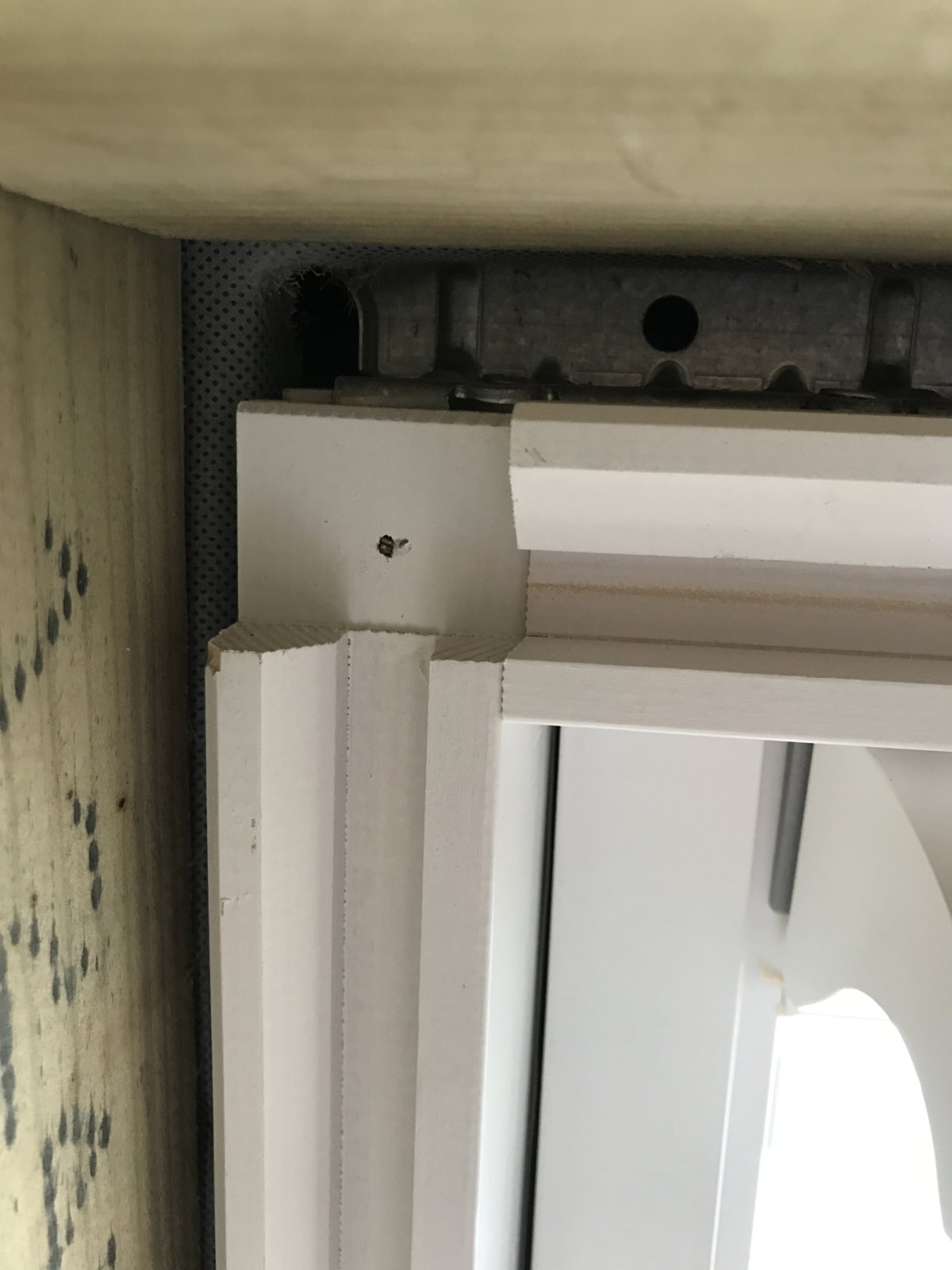

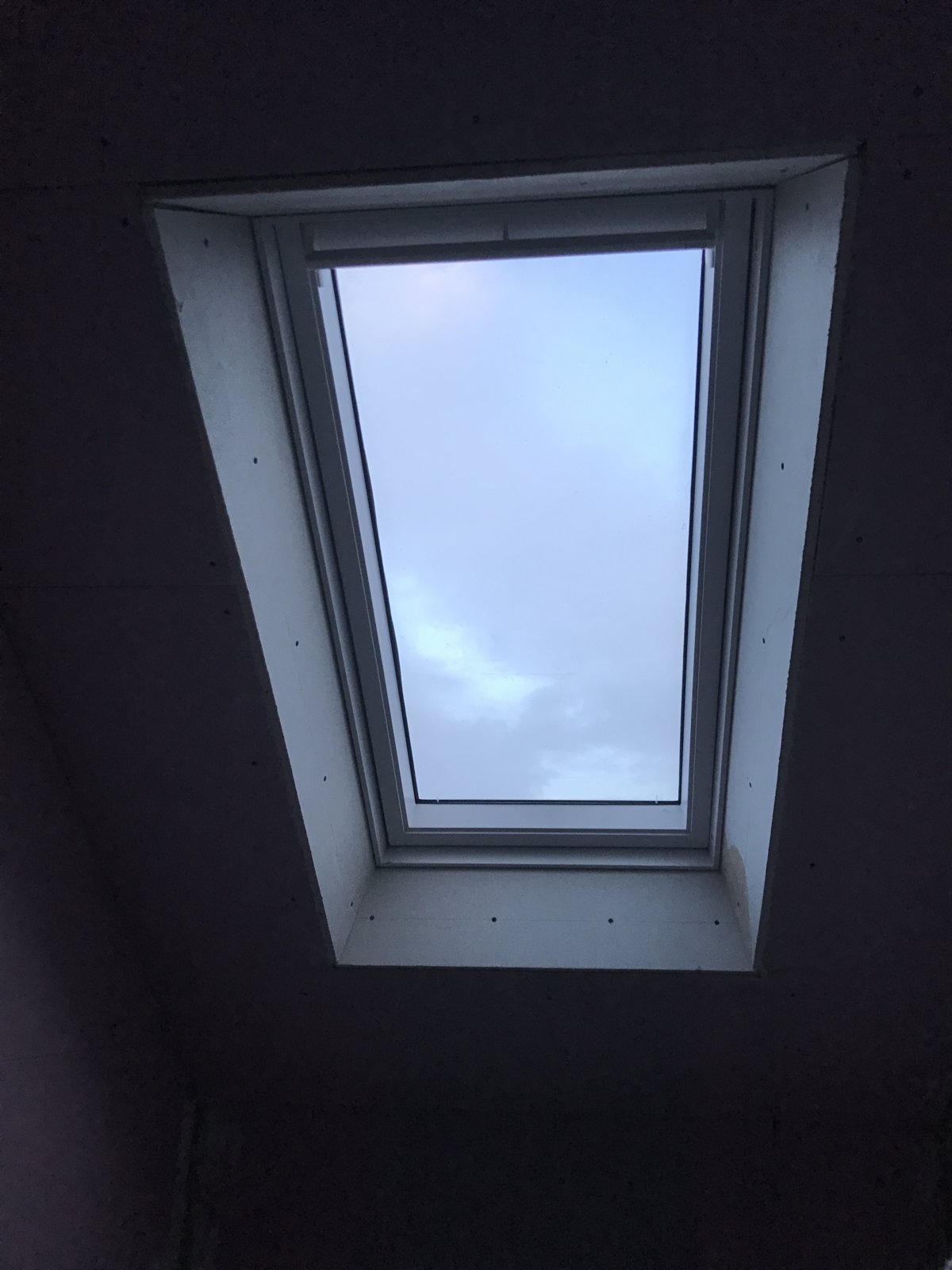

the new ones come with a expanding rubber strip that fills that void but we used to foam around window then add 25mm insulation to sides then board but looking you may get 50mm on there
That rebate is for the plasterboard to slot into so that will leave whatever gap is left to pack with mineral wool or something.
