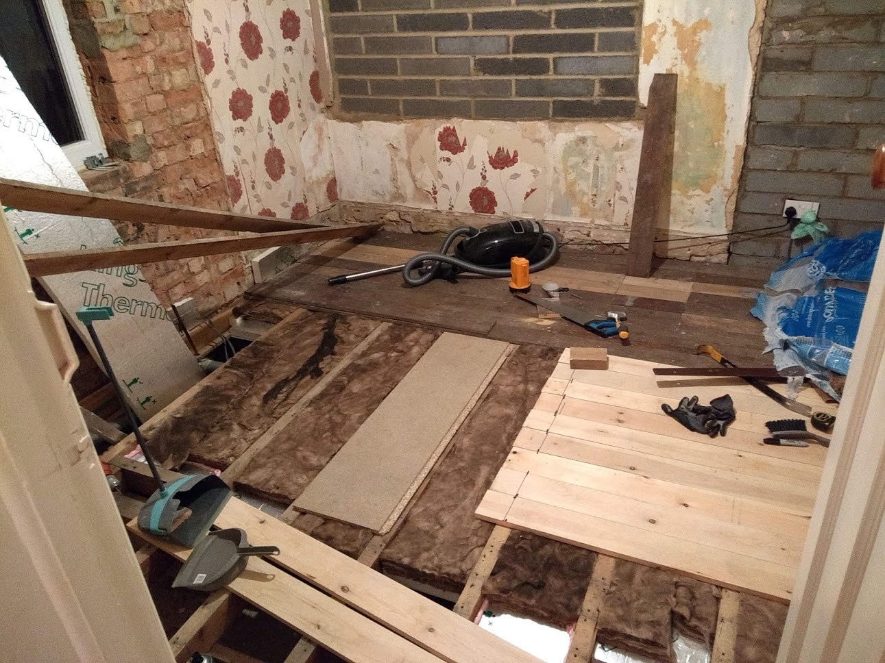

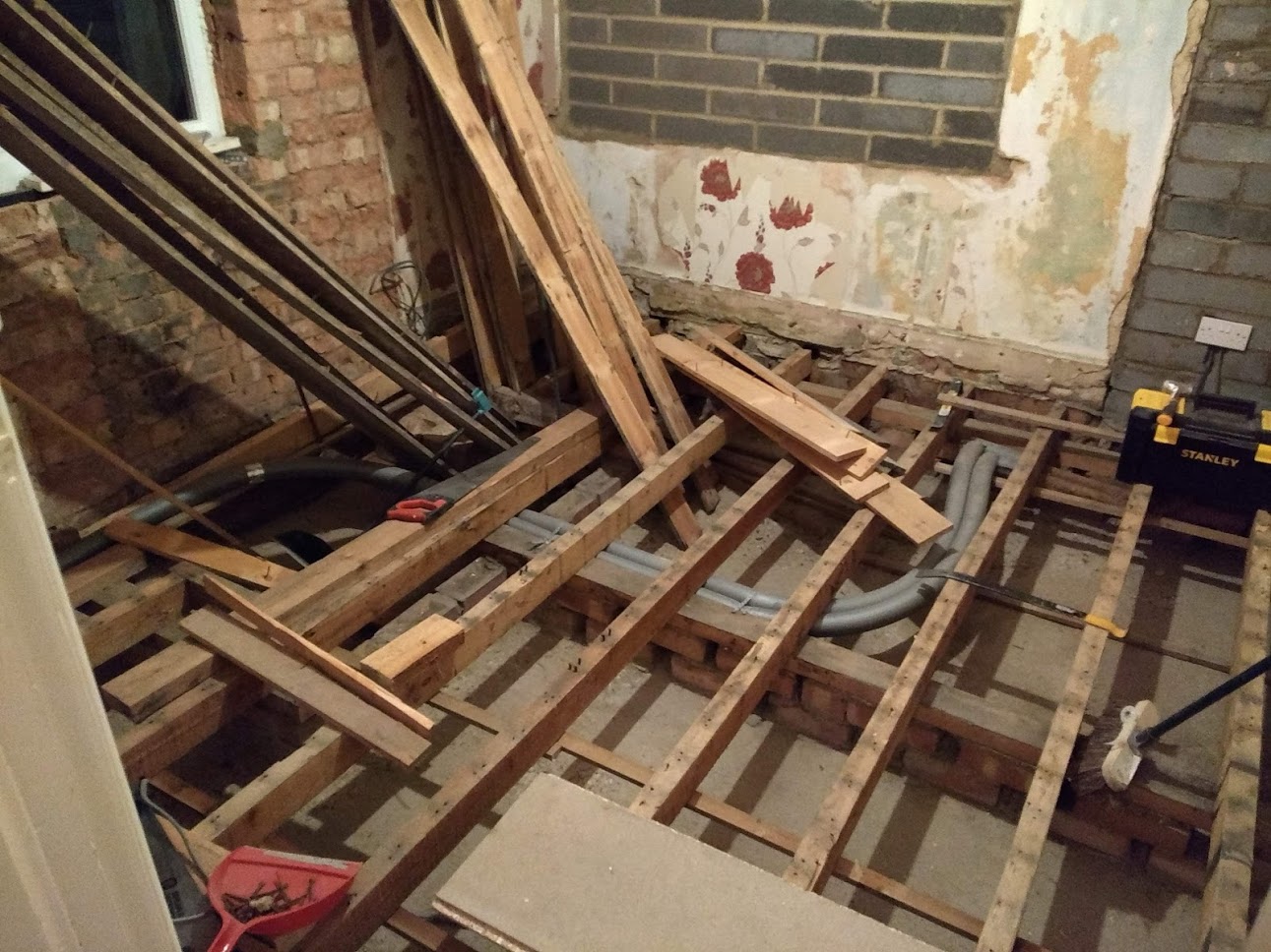

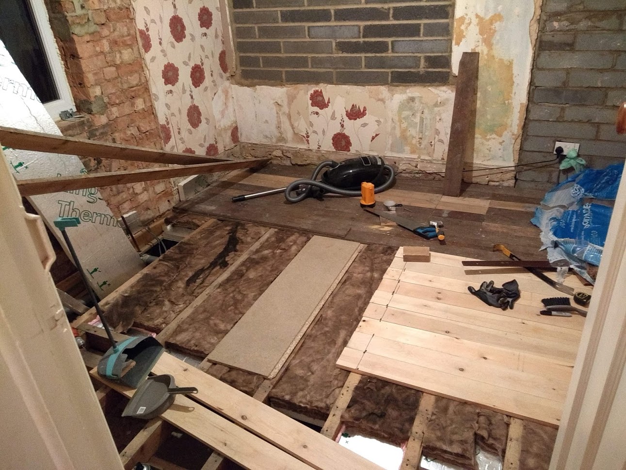

I've been doing this in my 1930s bungalow, it is making a huge difference.
My preferred method - remove all floorboards, clean out subfloor, clean out air bricks, update electrics and lag pipes if need be.
Use trellis poles (because i had loads spare) and fix under the joists, then lay 50mm kingspan over them, then 50mm rockwool on top.
In bathroom I put in 100mm kingspan, just in case if there was ever a leak it would get soaked up into the insulation. Seal it all in with expanding foam or insulation tape.

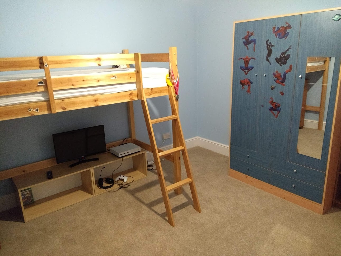

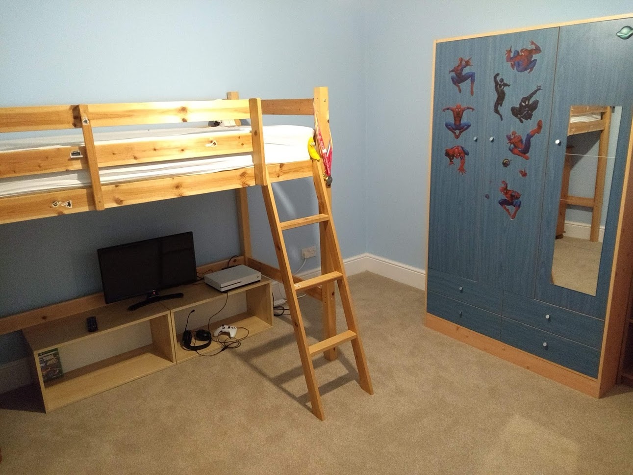

My son's bedroom:

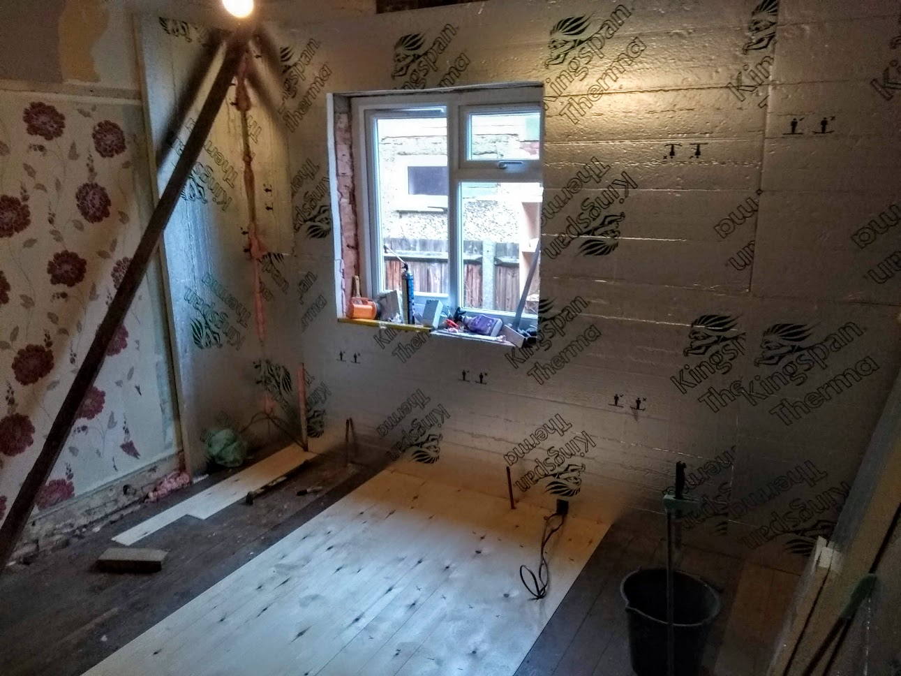

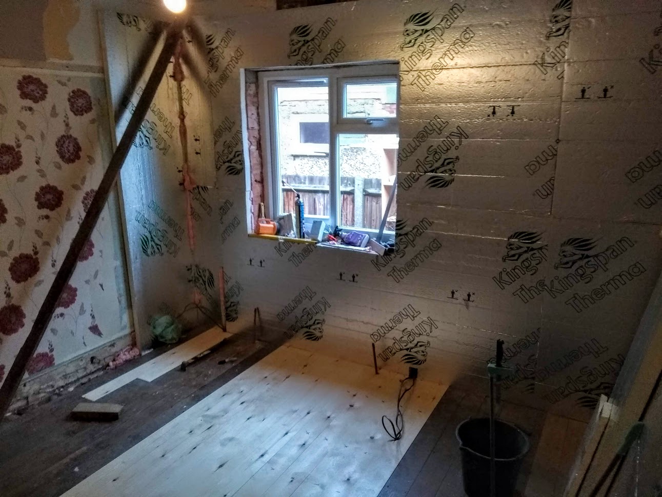

I also insulated the walls, but had no cavity to use:
Finished:
Lots of work but turned cold and damp room into cosy, warm and dry.
My son's bedroom:
Finished:
Great job!
How did you fix the wall insulation? Was this a cavity or solid brick wall? Any reason why you did not consider external wall insulation?
Great job!
Thanks.
Solid walls, fixed with Everbuild pink drywall foam, with a few mechanical fixings for good measure. I did consider external wall insulation, but as also had an extension put on the back and was removing chimneys and putting in new windows, and money was tight, it worked out better to do internal. Meant I could do a little at a time and more importantly DIY to save a lot of money. The walls needed plastering anyway, and old electrics ripped out in some rooms. Plus I was a bit unsure about cables outside - I have gas pipes, electric and telephone cables running under soffits and was not sure how external insulation would work around those. Internal just seemed simpler and cheaper.
Although, I do need to get the house re-rendered at some point, and was considering having a thin layer of insulation put on externally, but probably won't bother.

What was the reasoning behind have 50mm Kingspan and the rockwool on top? I was thinking of just using 100mm Kingspan.
Were your boards T&G? Any special tools you used to get them up?
What did you use to sit the Kingspan on to prevent it dropping through?
Not much reasoning, money really. 100mm kingspan is probably the best idea, I was thinking of doing that for the last room and hallway.
Boards not T&G, I just used to utlity bars.
Trellis poles were fixed under the joists, although the 3 wall plates supported most.
Can see the poles in this pic:
