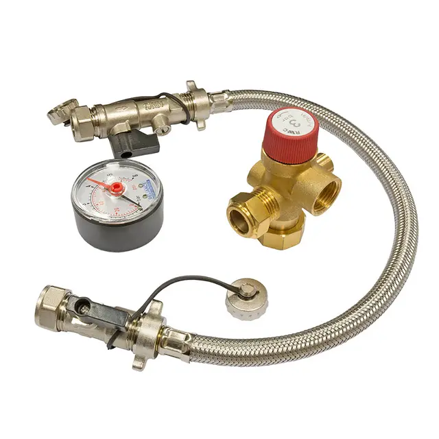

Okay, I feel a bit of a plum here (not unusual) - my son's Intergas HSE 36/30 Compact boiler had the expansion vessel fail. After contacting Intergas for a quote (£490) he gave the job to me.
As the expansion vessel is behind the boiler, replacing it would have been a boiler off the wall job - therefore Gas Safe only - so I went down the route often recommended on here, an external expansion vessel.
I chose a 12L vessel as it seemed a more suitable size for the property than the 8L fitted. It was primed to 0.9 bar as per Intergas recommendation (I phoned them!) and was connected to the Tesla(?) fitting below the boiler where the original had been connected.
The PRV valve was also replaced as it had been letting by with the failure of the old vessel.
All this was achieved without removing the room sealed casing, so hopefully I won't have Agile chasing me up!
Having refilled the boiler and bled via the top valve, all seems to be working on the boiler except that the pressure, at 2.7 bar is higher than when I set it at 0.8 and the PRV valve is letting by again.
Have I overlooked something obvious here? For example, should I have tried to bleed the new expansion vessel even though it has no valve or would the water find its way in there automatically?
As far as the boiler is concerned, nothing has changed except that it has a new, larger, expansion vessel outside instead of inside and connected at the same place as the original.
Thanks for your patience in reading this far...... any ideas?
