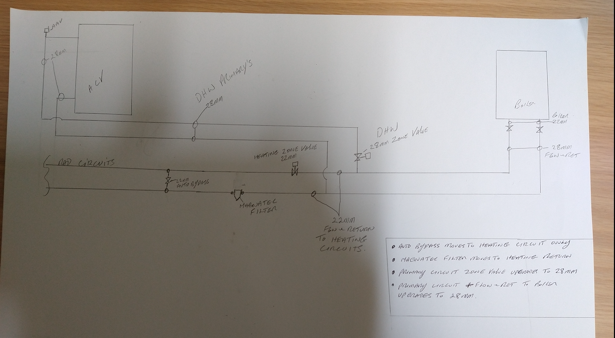

Pipework drawing for info:

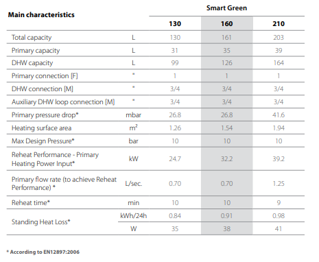

Could it be to do with pump speed and flow rate? The manual for your cylinder says a 0.7 litre per second flow is needed for maximum reheat performance. That is 42 litres per minute, which is pretty high I think. There are some options in the parameters for setting pump speed. I can't tell from the graphs whether your boiler can even produce 42 litres per minute.

A 31kW coil will only absorb 31kW when the cylinder is completely cold, although the boiler should be able to modulate to suit without cycling. Why did you go for the 40SB? Presumably the house doesn't need 40kW if it's surviving on a 160L cylinder?
Is it a long run from the boiler to the cylinder? There's not much residual pump head on the 40SB so if circuit resistance is too high it simply won't be able to shift 31kW round the system. In fact, if JonathanM above is correct and the cylinder needs 0.7l/s then that is in excess of what the boiler's pump is capable of producing

Yep, you seem to have interpreted that correctly. 0.7l/s gives 32.2kW at a dT of 11°C across the flow & returns, which is usually about what cylinder manufacturers will target.

I want to express my thanks for explaining to me what's going on. I had completely overlooked the effects of the appliance loss at that high flow rate.
The 40SB was put in about 5 years ago - and forgive me, I can't recall the reasons for the sizing of it at the time, but it looks like it's a perfect case of 'bigger isn't always better
I have it 'tuned' to around 53% power (22kw) and it seems to be giving me a reasonable reheat time (just over 13 minutes for the 130l stored water after showers) . Not what I had planned on when I wanted to capitalise on the 30-40kw but you live and learn!
