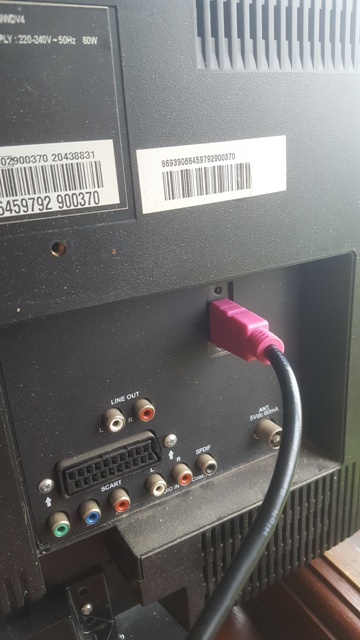

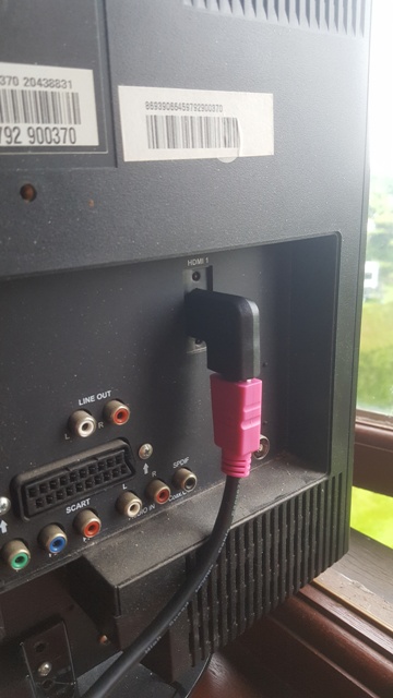

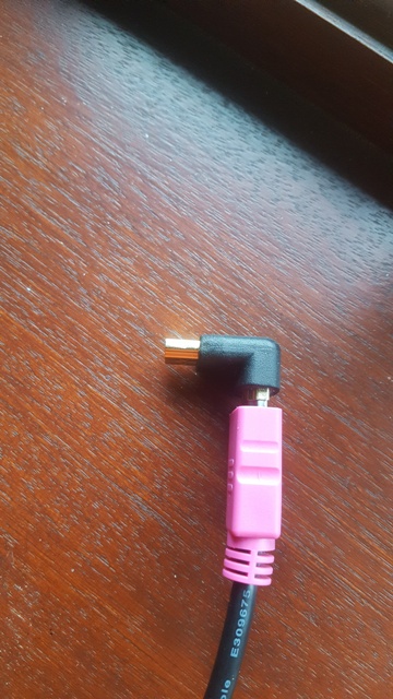

it is not the downward pull that moves the plug out of the socket its the leverage the weight of the cable produces when it sticks out from the back of the tv. imagine hanging all your weight on a screw in the wall that sticks out 1/2 in then do the same with a screw that sticks out 3 or 4 ins. the latter will bend the former will not. if your hdmi sockets are horizontal unlike the one in the pic you can also get adapter like in the pic of just the cable. the adapters are described by different sellers differently so if you decide to try one look at the shape of the hdmi socket (its not rectangular) and try to envisage which one of the adapters will suit, some are described as left/right or 90 degree/270 degree or up down (the last pic is a horizontal down)
Yes- the correct L shape will allow the cable to (for example) come into the socket from the left on the pictures above. A self adhesive cable tie can stick to the tv and act as strain relief.
thats what i did with my telly and the vent slots on the back were in just the right place to get a cable tie in to stop the cable moving (and to make it look much neater with all the cables together exactly in the middle at the back so hidden by the stand) (i cant stand seeing cables everywhere)

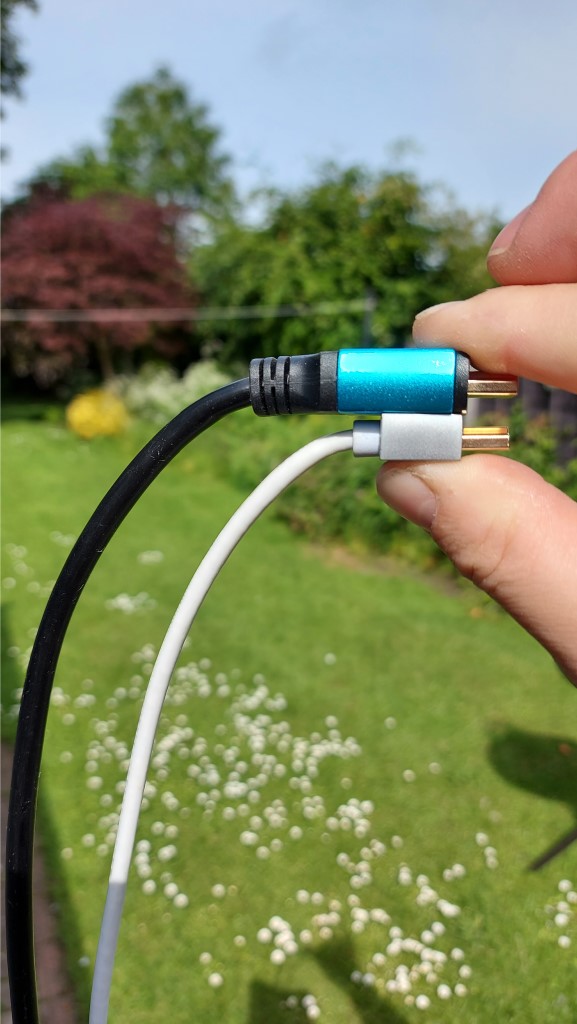

I've said it before, but I'll say it just once more and add: Get a cable with short-body plugs. Not only is the plug body shorter but they generally use a smaller diameter cable which means it's more flexible. Here, look:
This is my regular HDMI cable (blue) versus my short-body HDMI cable (sliver plug body, white cable). Alec, I took the trouble to take this picture for you. A similar plug/cable will help fix your problem. Now take the advice.
Add some strain relief as per @Tigercubrider and @Sureitsoff? suggested. Restrict any forces on the cable from moving the bracket to just a length of cable between two strain relief points rather than having it pull on the plug body / HDMI socket directly.
