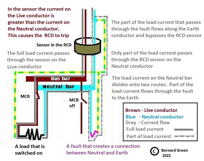

Finding an Neutral to Earth fault that "randomly" trips an RCD is not a simple task. It requires an electrician to carry out full testing for earth leakage. This normally require full disconnection of the circuit in the consumer unit. Just because the RCD only trips when an appliance ( oven, lamp, immersion ) is turned on does NOT means that appliance is faulty.
Turning OFF the MCB for the faulty circuit will not prevent a load on another circuit tripping the RCD
