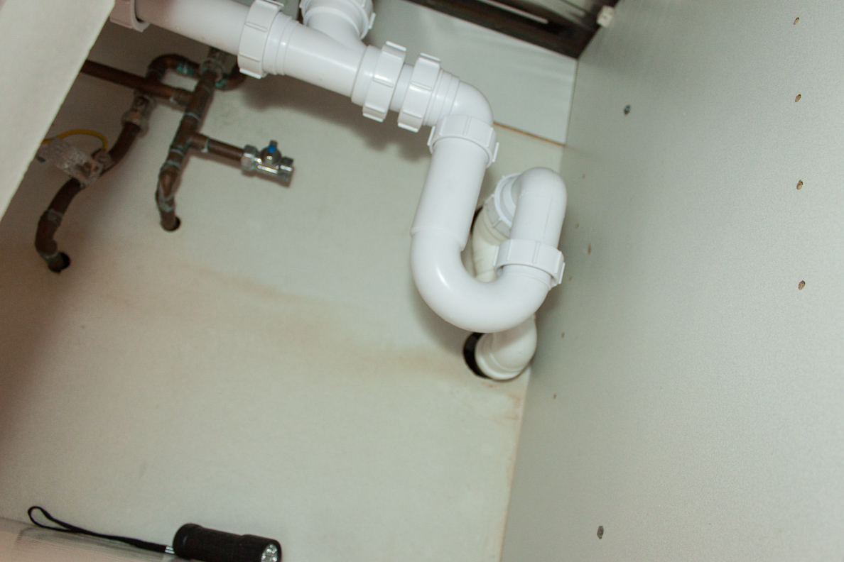

I'm not happy with the current condensate drain pipe.

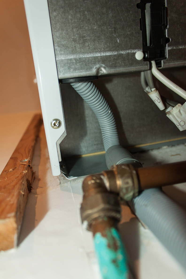

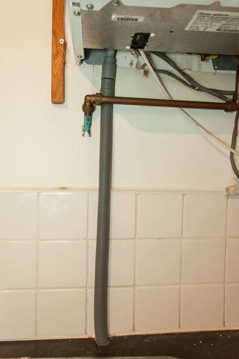

Whoever installed it did not do a great job. It is currently all flex and was held in place, at an angle, by a bit of string. It was also too long and seemed to cause the condensate to drain poorly. This boiler seems very sensitive to ensuring the condensate drains with very little resistance.
So I want to swap out the flex hose with a hard PVC waste pipe which can maintain it's fall and be a bit more robust.

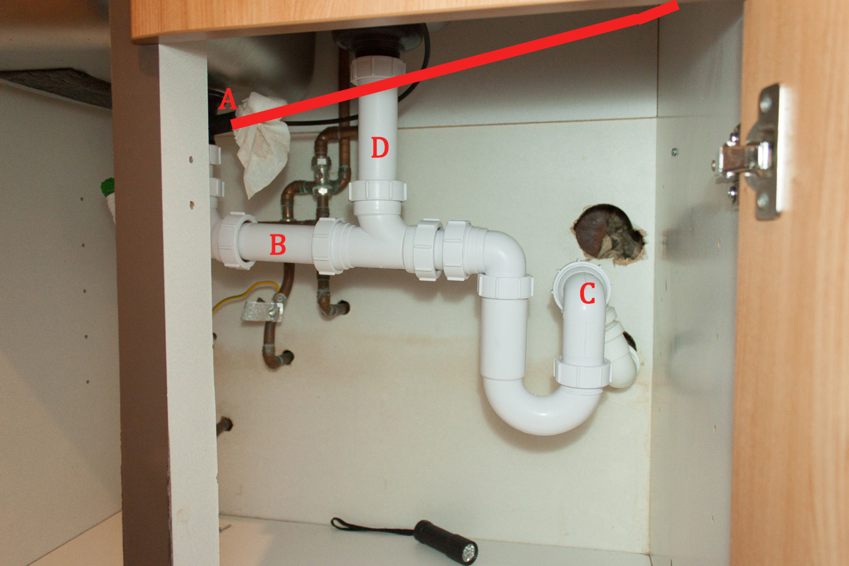

From what I have read on the forum, the current connection (A) is liable to get blocked with fat. Indeed, when I cleaned all the pipework out....it was indeed a bit blocked up.

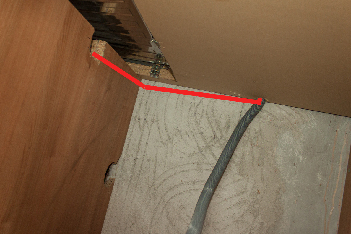

Red line is the current path of the flexi-hose (not as taught as that).
So, what alternative connections could/should I use and where are appropriate locations?
There may not be enough pipework in position (C) as it has a connection there already. See alternative angle.

I then would route it like this...
Which then joins up to the boiler....
With the final connection currently being (that gas pipe is in an annoying position, the flexihose may need to go past that)
If that initial flexihose is fixed to the boiler internally. What is the best connection to join PVC pipe to the flexible hose for that initial connection?

The condensate pipe is directly connected to the flue system and as such should only be worked on by Gas Safe Registered engineers. Rigid pipe is certainly preferable to that washing machine hose setup.
Only if fat is poured down the sink ...
yes, hard pipe is the correct way to run that, certainly not with appliance drain hose like.
As @muggles suggest though, it is considered part of the boilers flue system and ideally should be installed by a GSR engineer.
The condensate pipe is directly connected to the flue system and as such should only be worked on by Gas Safe Registered engineers..

Even though it seems I may not be doing this myself, if a GSR did the work, what is the most appropriate connection to the drain pipework? Should they make the connection that goes internal to the boiler all rigid? Or is that first section always a bit of flexi-hose?

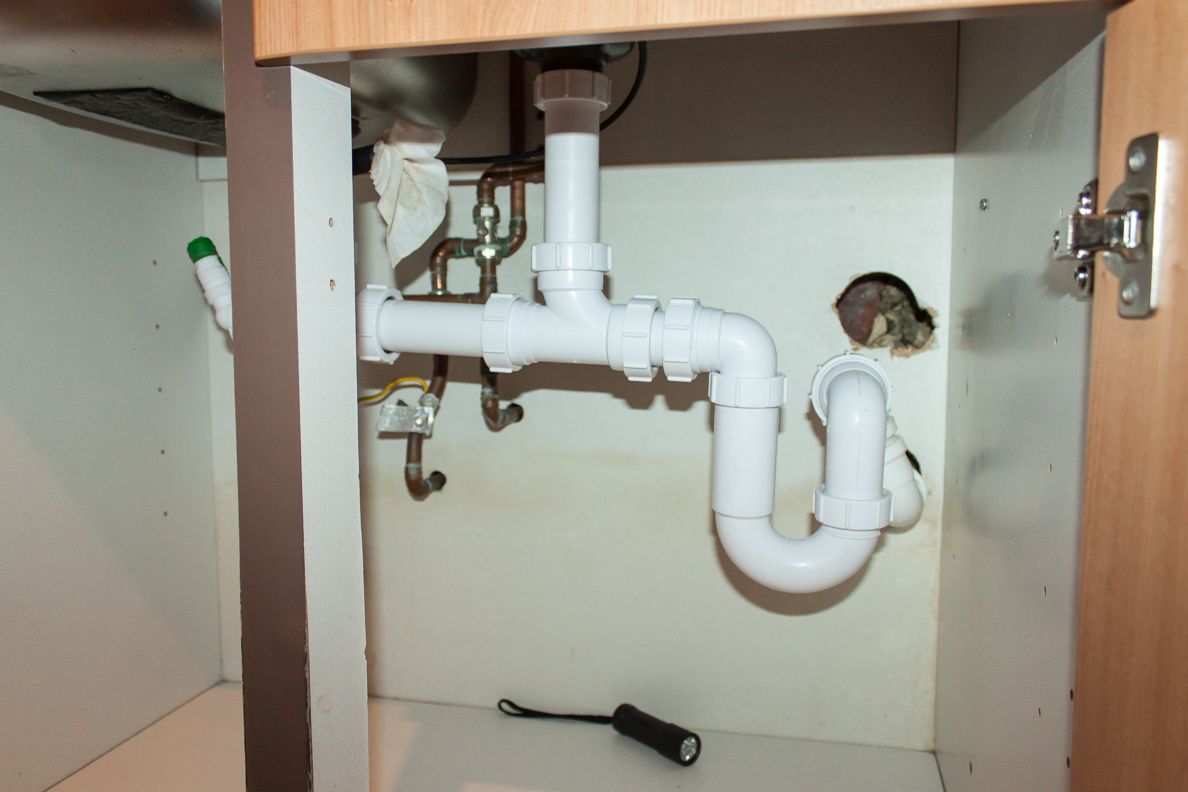

I did forget to mention there is another drain connection. The dishwasher drain normally goes in this position.
It can be seen on the far left with a green end.
