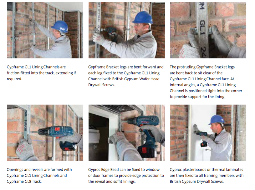

bearing in mind the metal stud is situated behind the insulation in my previous post
OP asked about insulating *between* metal studs if you read his posts, which is also a gypframe system.
I was not responding to your post, which I am aware was an example of a support system behind insulation.
