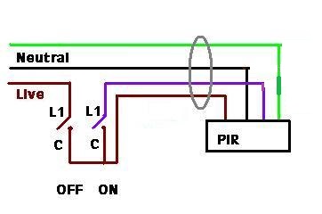

Hi all,
I have an internal light switch to an outside light which is permanently live, it's either on constantly on the down switch or on the IR on the up switch. This was here from a new build when we moved in.
is there a switch available that give me 3 settings, IR, permanently on and off?
I have been looking but i don't know what this would be called and i can't find anything suitable, if it even exists! if not can you advise any options please?
Many thanks
If the switch is a standard 1 gang 2 way then replace it with a 2 gang 2 way- 1 switch supplies power to the 2nd switch which then looks after your ON or IR option. Tried looking for the same thing myself but no joy unless you start playing with rotary industrial things.
It is possible either replacing the single switch with a 2 gang switch, or build up a grid switch and use one of these as the switch. Then you can select up for ON, down for PIR and middle position for off.
I'll try and post circuit diagram in a bit.
EDIT: here you are!

And, I am going to have to start watermarking my drawings……..:D
I drew that drawing, originally for a separate PIR and lamp on 18th March 2011
but have no problem with people using them.....:mrgreen:
