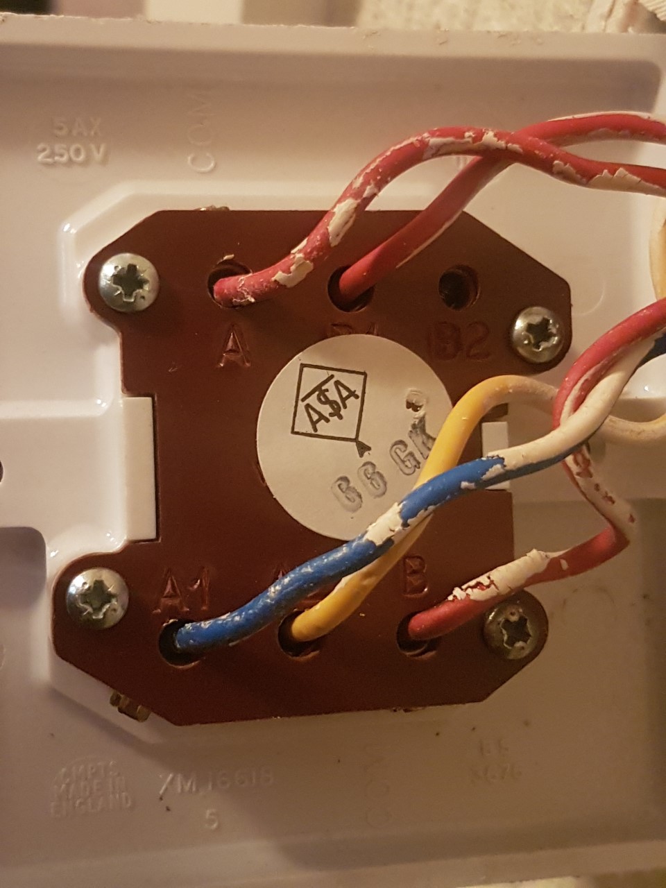

Hi All
I am hoping someone can assist in an OCD matter haha.
It is a hallway 2 gang switch but would like the switching swapped from side to side..
The left switch operates the downstairs light, and the right switch operates the upstairs light, but it should be the other way around. They both switch off correctly (top of switch pushed to) so I can't simply turn the switch 180 degrees. Working top left and moving clockwise on the photo attached, the wires are:
A = red wire - permanent live when upstairs light is on / switching live when upstairs light is off
B1 = red wire - switching live for left switch
B2 = Not used
B = red wire - permanent live
A2 = yellow wire - earth
A1 = blue wire - permanent live
Many thanks Ian

A1 becomes B1
A2 becomes B2
A3 becomes B3
and so
B1 becomes A1
B2 becomes A2
B3 becomes A3
You may need to isolate more than one fuse or circuit breaker.
Be careful not to mix up the wires while doing this.
Take pictures or draw careful diagrams.
Work safely.

Info given above is correct.
The reason why - there are 2 identical switches A and B, one is upside down relative to the other one.
Each switch has 3 terminals.

Yellow is a switched line.
All of those wires are either permanent line or switched line, there is no earth connection there. No neutrals either.
The switch either connects A and A1 together, or A and A2 together.
Same for the B switch.

Easier than that.
Move red from B1 to B2 and turn the switch upside down.
