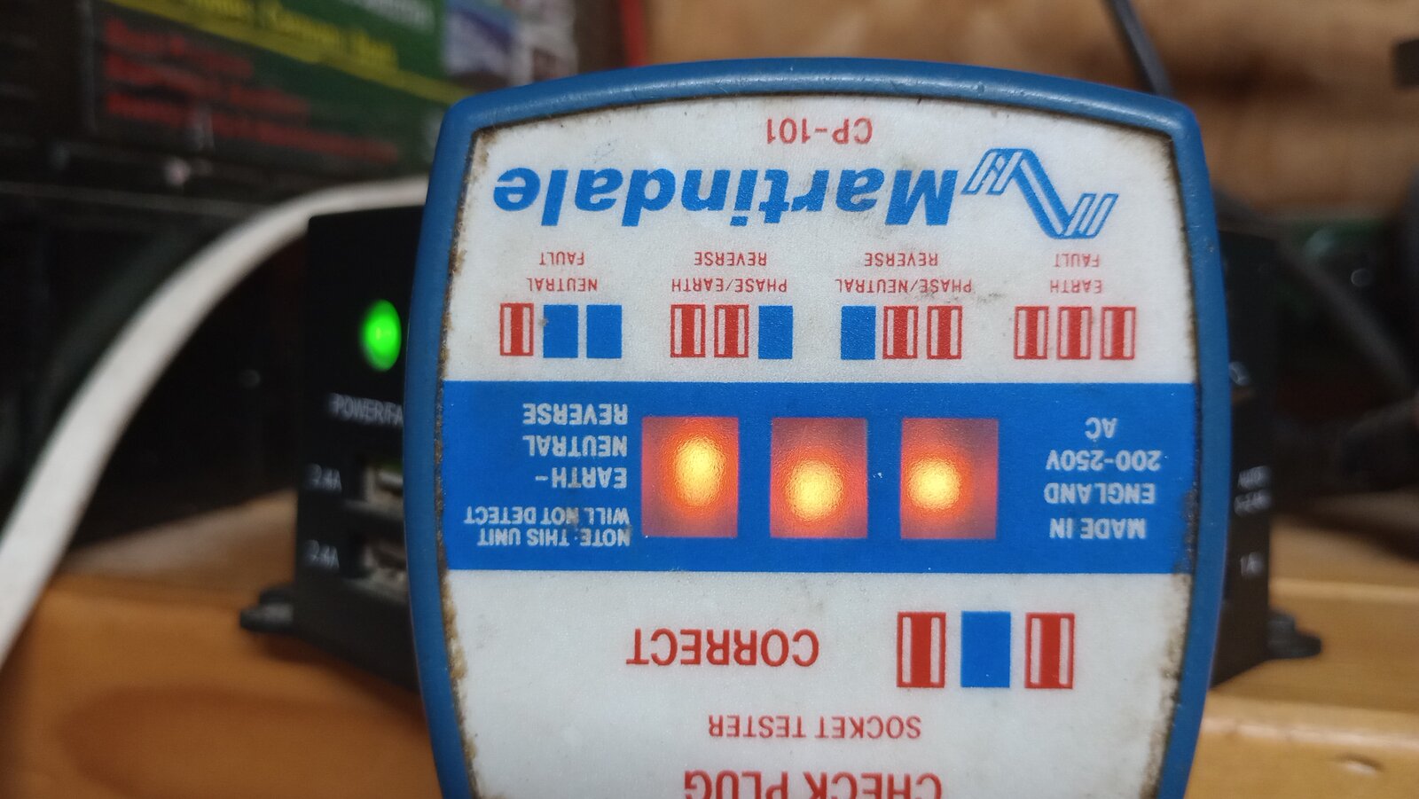

However when doing a check before using and fitting the extra panels, my Martindale socket tester came up with an earth fault notification.
When plugging in the socket tester to the same service circuit it came up fine.

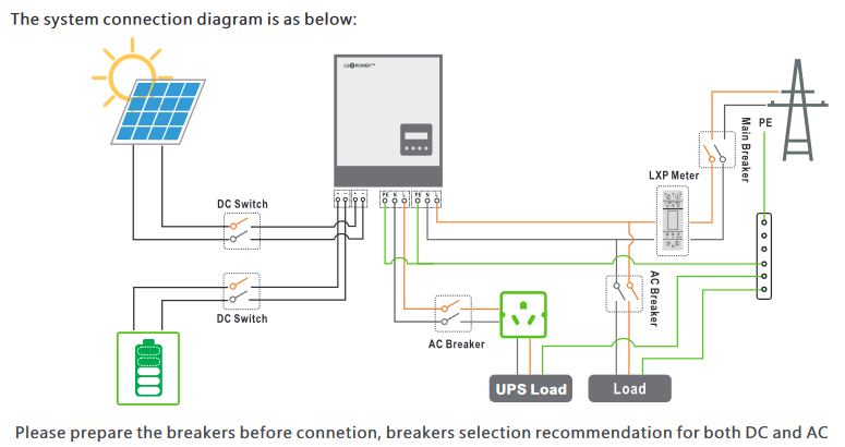

My inverter has a number of diagrams like this 1711138485486.png each dependent on the country used in. It has instructions like
there are loads of other instructions as to how neutral and earths should be connected

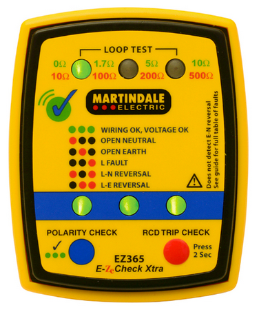

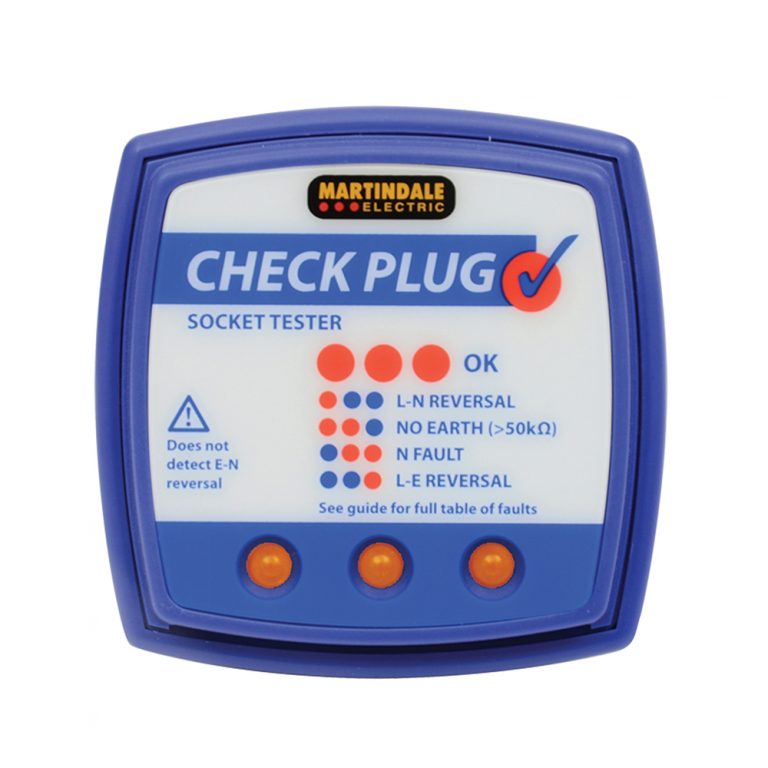

the instruction set is full of things like this, and to give advice without reading the instructions could be dangerous, as not all instructions are the same. Both this 1711139571446.png and this 1711139639358.png are plug in Martindale testers, the latter may be OK for a gas engineer to use before plugging in a boiler, but the 1.7Ω is not good enough for a ring final the pass mark is 1.38Ω with a TN supply, however with a TT supply we have

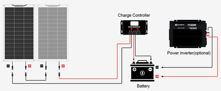

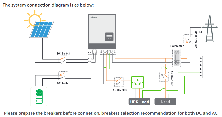

Here's the Circuit. Earth lug not included.
And here's the socket tester error
No fault light on the inverter (normal power light), but the socket tester shows an earth fault.
That diagram doesn't show any of the AC wiring, only the DC stuff.
If it's a device designed for the US market it may well have a 120-0-120 output, which would likely cause socket testersto show an earth fault.

Sorry I thought you were using a grid tie system, not stand alone, with small inverters designed to supply a single socket one can use an IT supply as used with shaver sockets, so the supply is not bonded to earth. When using multi items however there can be a fault with more than one item, so you in the main need to bond one leg of the supply to earth.

It seems this 1711188553307.jpegis what the tester looks like today and it says warning "Like all other standard socket testers, these units cannot detect common earth and neutral or earth neutral reversal." I have read the data sheet and manual and it does not tell one much.

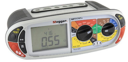

It seems one needs to get out the proper test gear when they show a fault. I use to have one with the caravan as have found lives reversed in the past, but not used one in years.
