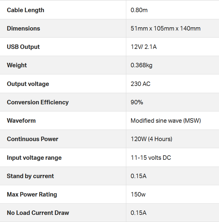

how is that then? will it not recharge again?
Every time a battery is charged and discharged, the resulting wear and tear, reduces the available charge, or amp/hour. The wear and tear/available amp/hour, is made dramatically worse, the lower the endpoint discharge voltage, plus leaving the battery for a prolonged period, in a discharged state.
Where dose it say that please as I cant see it in the description
Specification tab on the advert you linked to 1697359509754.png as to
It doesn't need to - if it didn't switch off once the battery voltage drops, then it would permanently ruin the battery.
