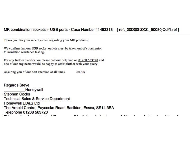

As title, I a have just installed on two rewires a selection of USB integrated socket outlets.
I would assume with a transformer being present that I would either link out the USB trany or IR at 250V?
So that is my question IR at 250V or link out the trany or any other options?
I had raised this particular question with MK (Honeywell) a while ago and got this response.
That's the answer - PITA!!
PS I did suggest they included guidance with the product, I haven't seen evidence of this (or any free samples) as yet!

There won't be any transformers, just a very small switch mode power supply. Certainly don't test them with that in circuit.

It's presumably an SMPSU and the nature of such things is that, at least with one polarity of the IR test voltage, it would presumably be expected to give erroneous IR measurements at 250V, and testing at 500V could well do damage to the electronics.
It ought to be safe to do L+N vs E IR tests, and if the SMPSU is totally isolated from earth, the results should to be correct.

Okay, I thought there would be issues with a full test at both 500V and 250V.
Think I will link out the transformers/SMPSUs and do a full test and remark upon this on cert.
